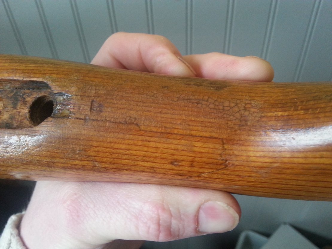

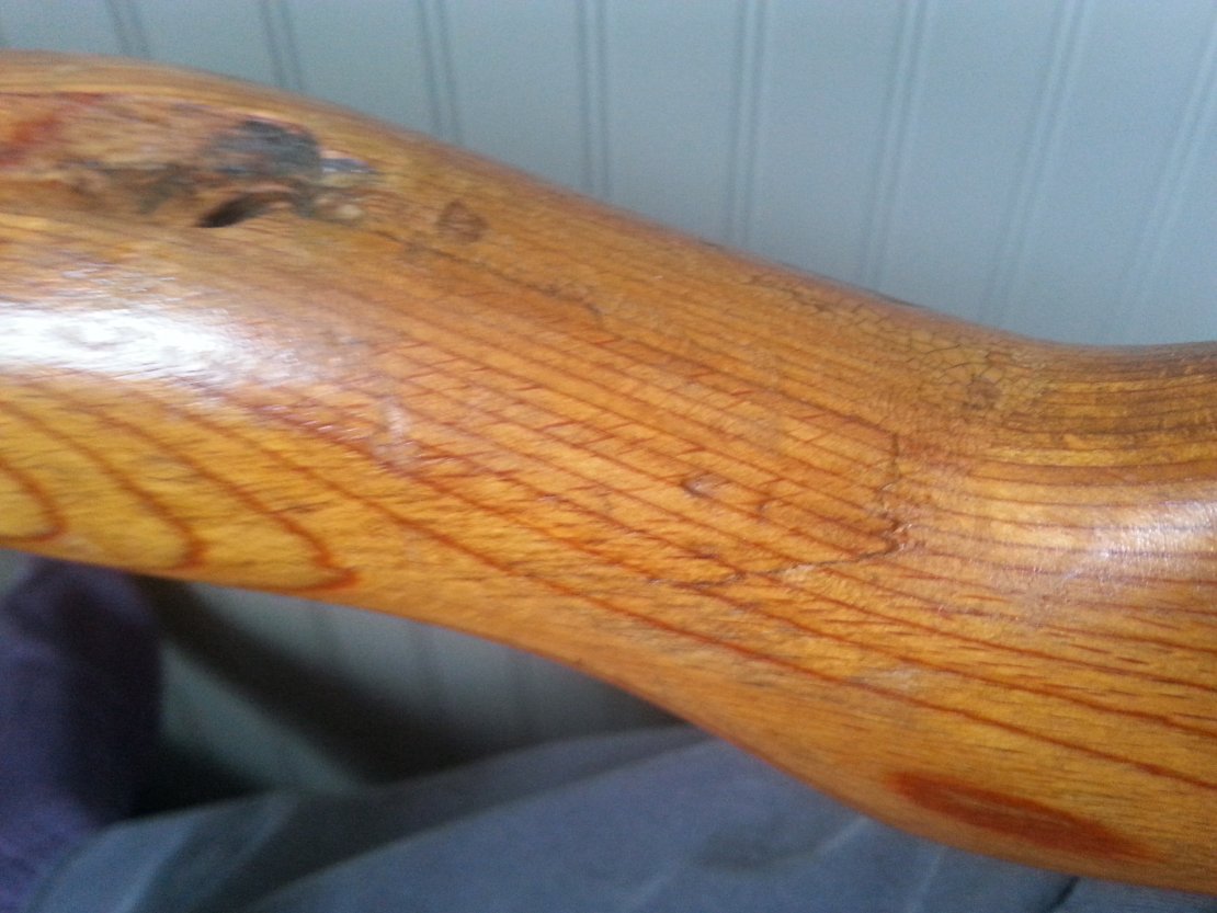

Hey everyone. I tried posting this on K98 forum, but oddly couldn't get any answers. I've always noticed the folks here at Luger forum to be very helpful, so here I am!
I have a mismatched shooter K98k (appears to be parts from maybe two rifles); the stock is a red glue laminate type, Norwegian capture I think (matching butt plate has the crossed out number, dowel repair just under the bolt handle). It shoots great, but I just noticed a crack behind the trigger guard to up around the grip.
Upon close inspection, the crack seems to start at the dowel on the side opposite the bolt handle. The "lifted" flaky part can be felt(isn't entirely flush), but doesn't seem to move when pressed. My questions are these:
1. can this be repaired (without refinishing the whole thing? If so, can I do it or does it need professional help?
2. is it safe to keep shooting?
3. what causes a crack like this?
I checked for Recoil lug "setback" and it appears fine. Nor does the lug seem deformed (it is easily removable).
Help?

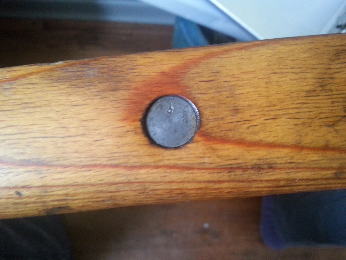

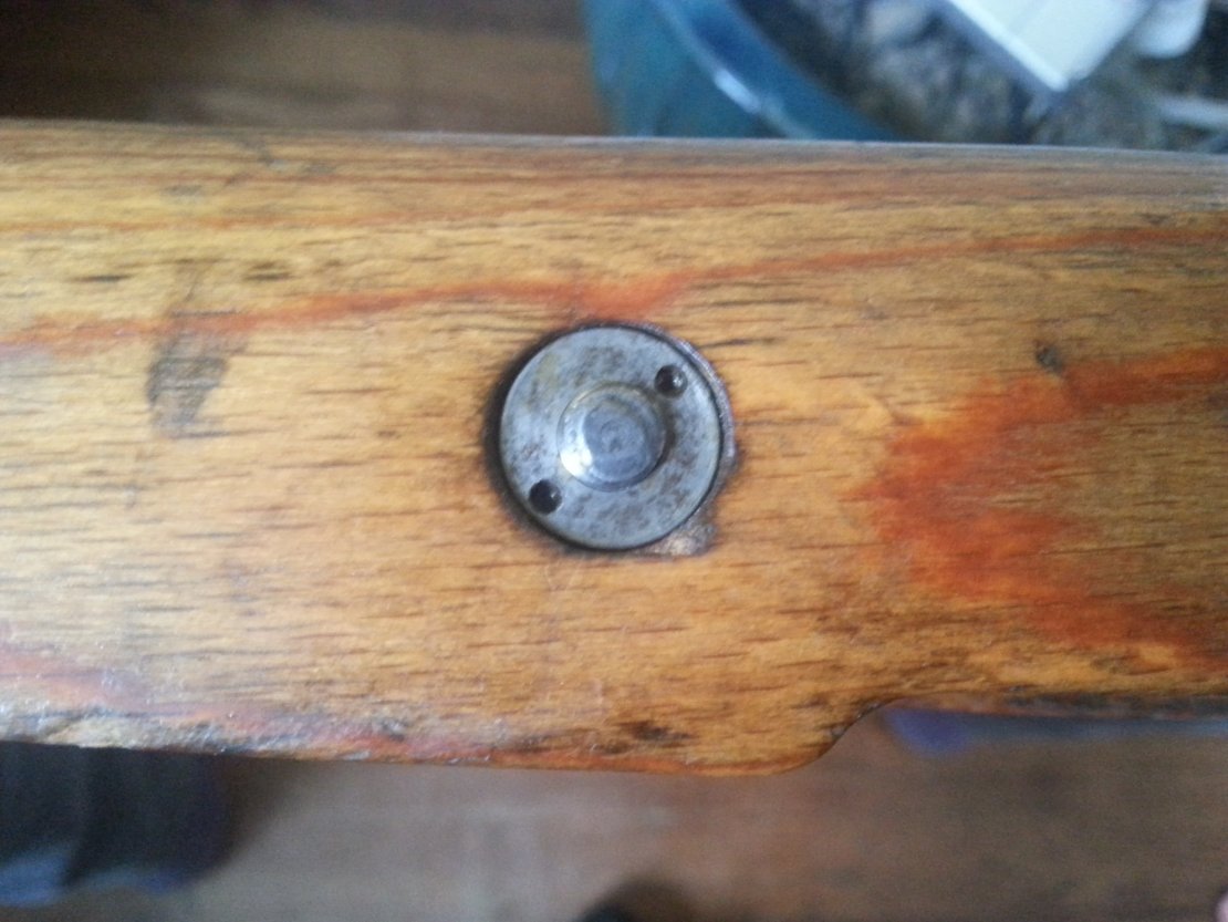

Here's the recoil lug

Yes, it can be fixed. But not with "glue", use epoxy- and a good grade slow curing.
I always drill small holes into the crack, from the inside if possible, to get more area to adhere- like Rich's saw slot.
Usually I also install a brass pin or screw, again from the inside, if the piece is to be used/fired.
For a cosmetic repair, the pin/screw is not needed. It can be spot finished as needed.
What caused it? Poor fitting of the tang- not enough "relief" around the inlet, the metal moves slightly reward and hits the wood = a crack. You can see it also chipped out a bit of the laminate too.

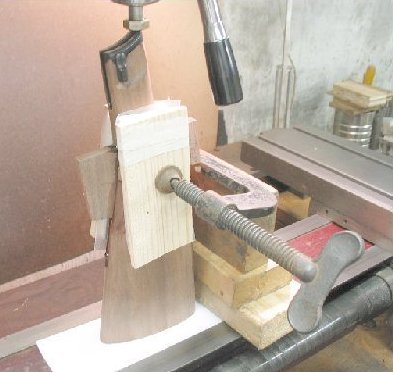

Rich, there are two consistencies of Crazy/super glue. The one we are most familiar with is the clear liquid. With it, you get one shot at putting the pieces together because there isn't any appreciable time to work with it--boom! It's set... I've used this when there is a crack, but not two pieces of wood that need to be aligned. It is runny enough to slurp considerably into the repair, and if you can flex the joint a little to help this action, be quick about it. I have used it to fasten material onto the $1k X k chip area, however, buy clamping that level on the back to a block covered with a layer of plastic wrap, then sliding the patch up to it. The block makes sure the levels in back are flush, so one only needs to regulate the up/down, left/right aspects, which are clearly visible from above while the patch is positioned.
Then there's a relatively new formulation in clear gel form. It allows lots more working/positioning time and has enough body to fill small imperfections. When the parts fit together well, there's little, if any, crack visible afterwards. Good pressure while it sets also helps.

however, buy clamping that level on the back to a block covered with a layer of plastic wrap...
I can only add that when dealing with any kind of glue or resin I use waxed paper rather than plastic wrap. At some time long ago I had plastic wrap dissolve from a glue...Waxed paper doesn't dissolve.
Rich, you are right! I'd forgotten about that, used to use it for gluing and clamping wood projects. I'll take back that part of my recommendation. But all this talk got me wondering if I still have a chunk of delrin in a shop drawer. Anything applied to block could moosh around or wrinkle, but with a block that's non-interactive, that won't happen. ( I think I actually used a piece of brass flat stock last time)
