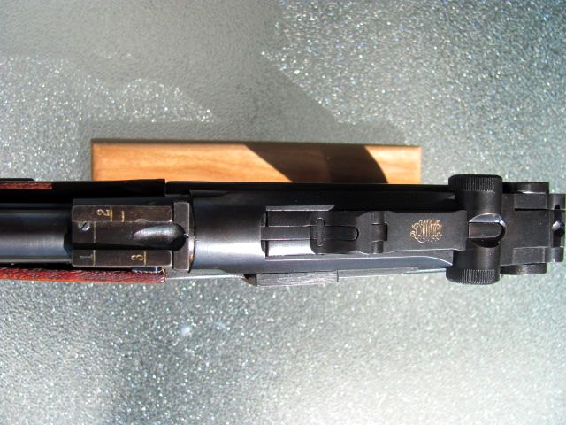

Unread 10-15-2011, 07:51 PM   #4
Is this your first attempt to build a luger, much less a carbine. Heres is a misconception that the 1920 was built by scrap parts, Maybe the grip and grip screws. THESE WEREN'T GUNS MADE PIECE MEAL! THEY WOULD HAVE NEVER TRUSTED THEM TO HEADS OF STATE! John Martz is the only one I know to do it justice. Take a look on Gunbroker. Every now and then one will surface!One of Johns carbine is now being offered on Gunbroker and no one could do better.

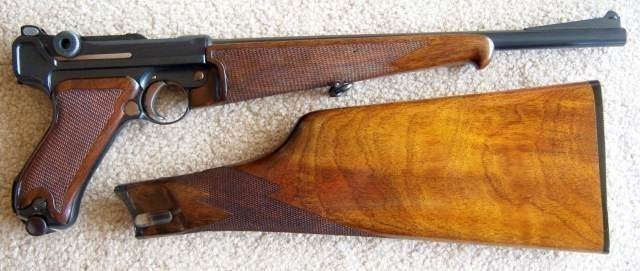

Unread 10-15-2011, 09:08 PM   #5
Barrels and sometimes barreled receivers show up on GB quite often. Numrich and other distributors sold a bunch of them. Forearms...well, you got a knife???
Welding/brazing that forearm lug onto the frame will be...interesting...
And you'd better set aside some time to tune it to your favorite load...
Check with Tom Heller...Seems like he mentioned something to somebody some time ago about a 16" barrel...

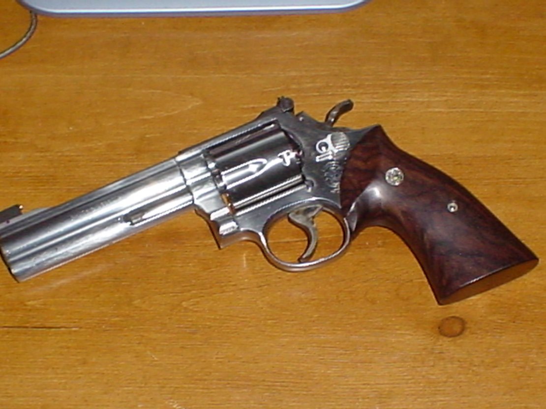

Unread 10-16-2011, 11:54 AM   #12
The Gunsmith
Join Date: Jul 2011
Location: Indiana
Posts: 21
Thanked 3 Times in 1 Post

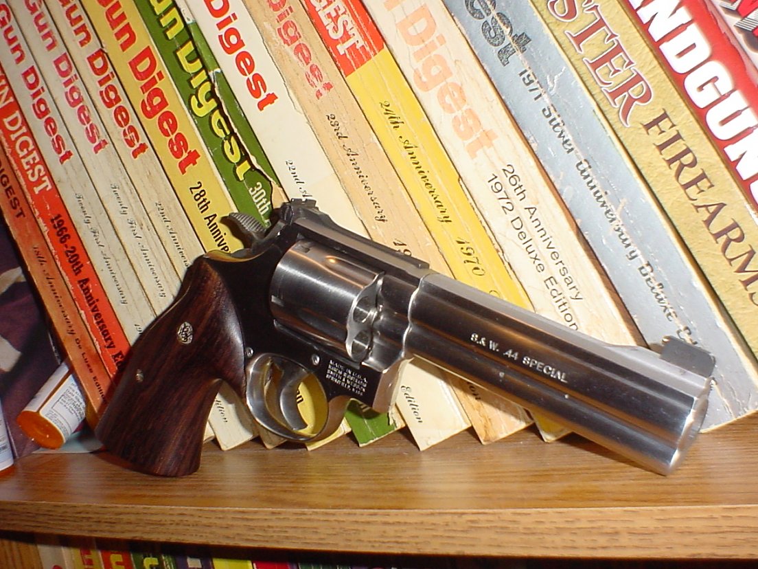

A pic of my last project. Started out as 4" 357 model 686, converted to 5" 44 special with target hammer and trigger, full action job, custom grips and sights.

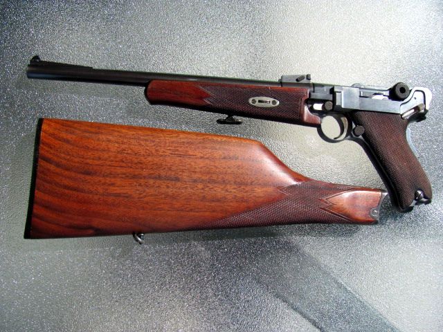

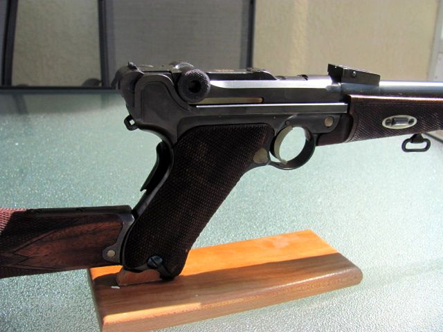

Unread 10-21-2011, 12:47 PM   #14
Default They are the finest!

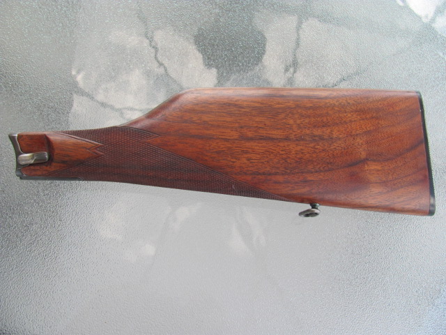

I can provide any examples that you made need!

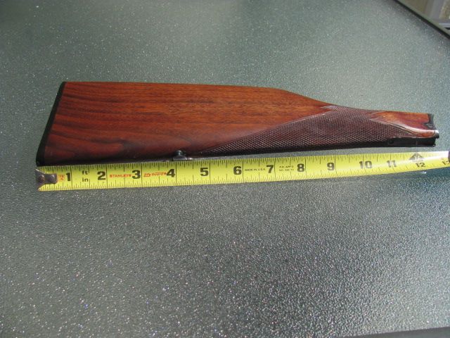

Unread 10-21-2011, 02:24 PM   #16
I can trace one out or provide any other samples 13" X 4 1/2"
