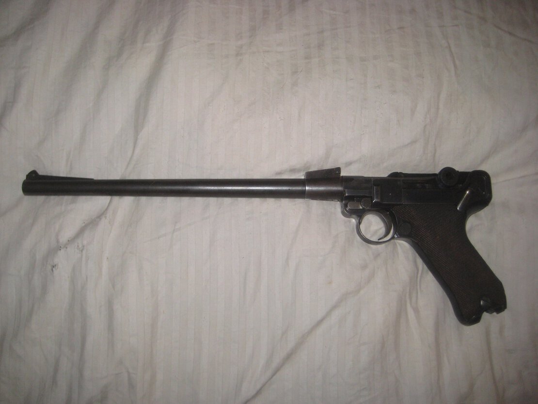

I picked up a 12" commercial 1920's Luger and can't get this to cycle either.
I loaded up some rounds with 90 gn. XTP with accurate #2 (faster than I'd like but what I had on hand) at 4.3/4.4/4.5 grains (4.5 being the max noted in the book).
Nada, even after I replaced the spring with the wolff weaker one.
Case remains in the chamber...when cocked by hand it properly ejects...no attempt at double feed or stovepipe so not enough recoil.
The action is smooth and the pistol in good shape....any load suggestions.
BTW, I have 30 days to return so there is that.

I've had trouble with anything over 12 inches. I do have a 9mm 12 inch that was tuned by a gunsmith and works well, but I personally have never been able to do it worth a darn.
Ed, I got my 9mm 12 in. working great with 115 gn. Win white box..
However, the .30 cal is a bit dif and obviously a lighter load.... I wonder what they initially used in these to make them cycle. They sold enough of them.
This is an original barrel and marked as such...the only thing I can figure is a much lighter spring but then you'd need the forward assist on closing. I've heard PPU ammo does the trick but who knows?

PPU works fine in my 1920 carbine , spring original

There was a unique issue with this L PO8.... when I disassembled to inspect/clean the rear toggle bolt fell out in my lap even tho the pistol was flat. The top hat extension that keeps it in place had been worn off. Not ground off but gouged off...you could see little chip marks all the way around the area where the extension should have been.
The barrel extension was overly loose in the frame front and rear. Side to side movement.
I'm wondering if it 'chattered' when shooting allowing the bolt to stand a bit proud?
Have you ever seen that kind of wear? What may have caused it?
