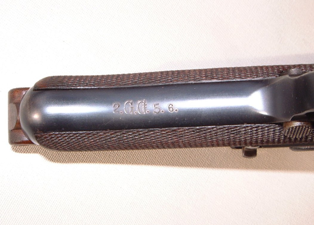

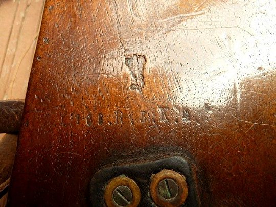

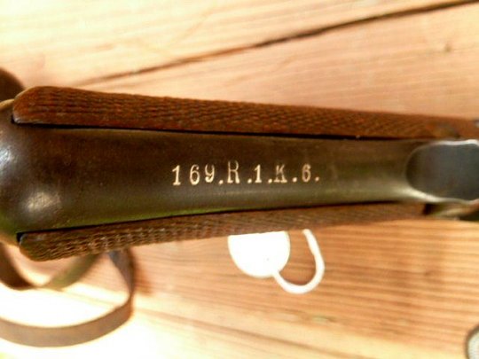

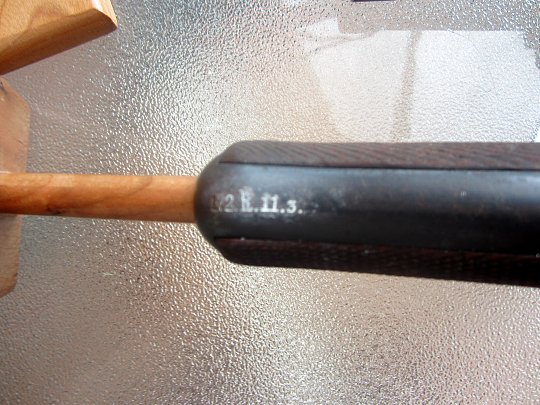

I own several unit marked lugers both on P08 and artillerys. Close to twenty years I have never seen the marking process explained.. Where were they applied? Factory or field? Did a particular regiment request them. When were they started and which are the rarest? Are there fakes?

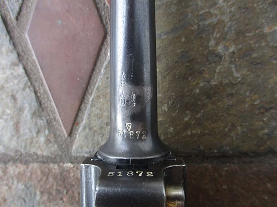

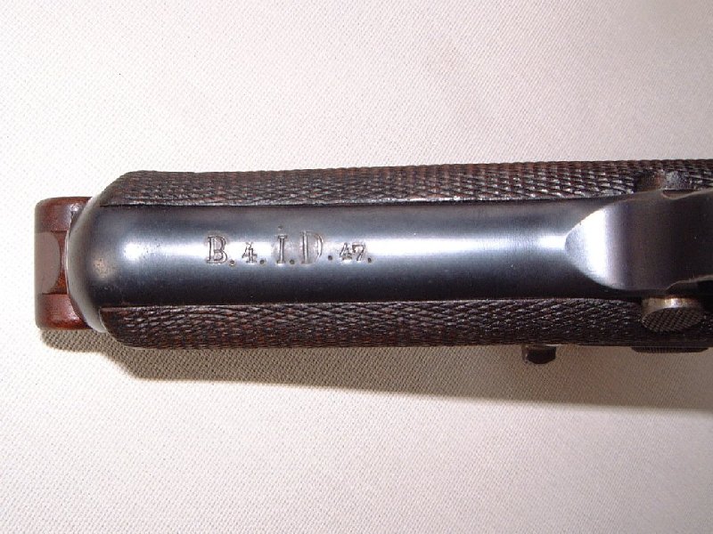

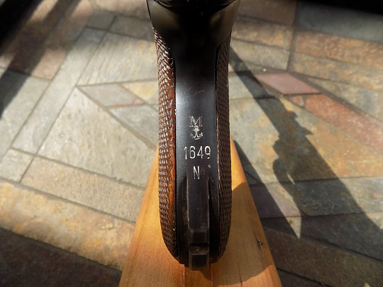

When they left the factory, no one knew where they would go so they were marked at unit level by an armorer.
If the finish is original they will likely show a halo around the stamps as they were applied after the finish was on the gun.
Old 05-18-2020, 10:27 PM   #8
Did regimental markings have halos?
Old 05-18-2020, 10:37 PM   #9
Almost always.

Old 05-18-2020, 11:47 PM   #11
Thanks: 1,123
I think Doubs pretty well answered that question:
"If the finish is original they will likely show a halo around the stamps as they were applied after the finish was on the gun."
Here are a couple of mine.

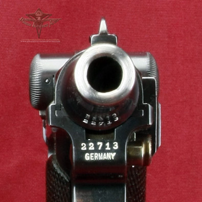

Cirelaw. THe halo around the stamped letters is caused by the stamp being applied AFTER the surface was blued. Since regmental markings were applied after the gun had left factory and was blued, they always produce a halo becuase the disruption of the metal by the stamp stresses the oxide finish of the bluing. However, the halo can be very difficult to see and it can get very faint due to aging oxidizing the surface. Rebluing will also cover the halo. If you got it from George Anderson it is honest.
George; Washington PA produced some fake Unit Nmbers.
Old 05-20-2020, 07:37 PM   #20

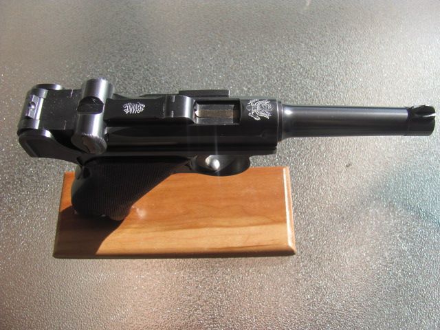

TKS Heinz I agree with you as to regimental marking all others I have my doubts as to serial numbers and import marks, Don't forget the eagle! They all had to be prebluing! Thanks for your input! My 1902 Fat Barrel has no halos including a sharp 'GERMANY' '22713' TKS The last one isn't mine! Demonstration only!Legacy has a good example https://www.legacy-collectibles.com/...at-barrel.html All imprints are sharp!
