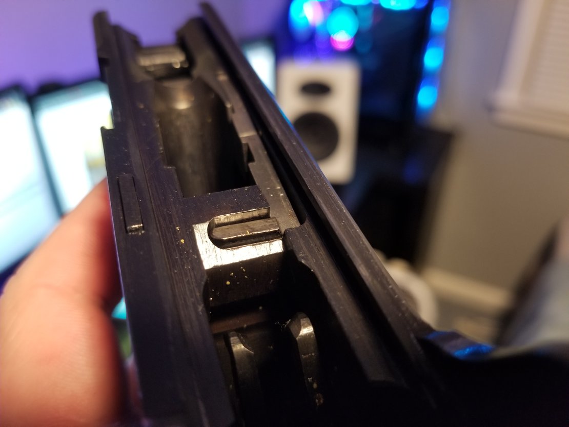

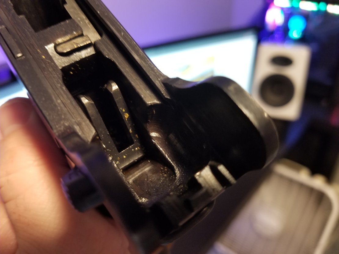

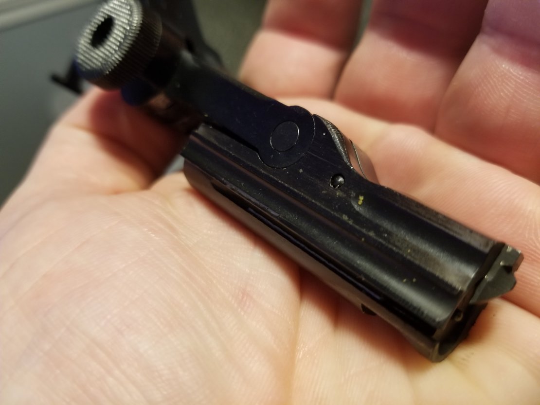

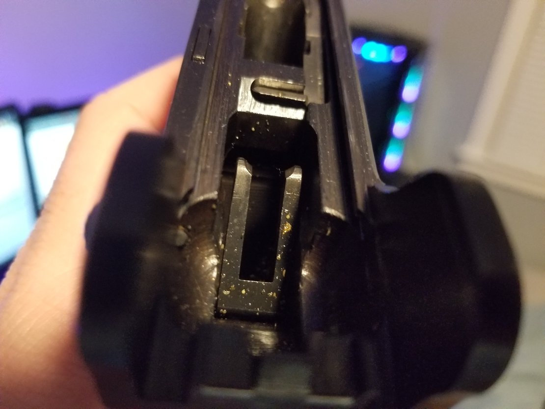

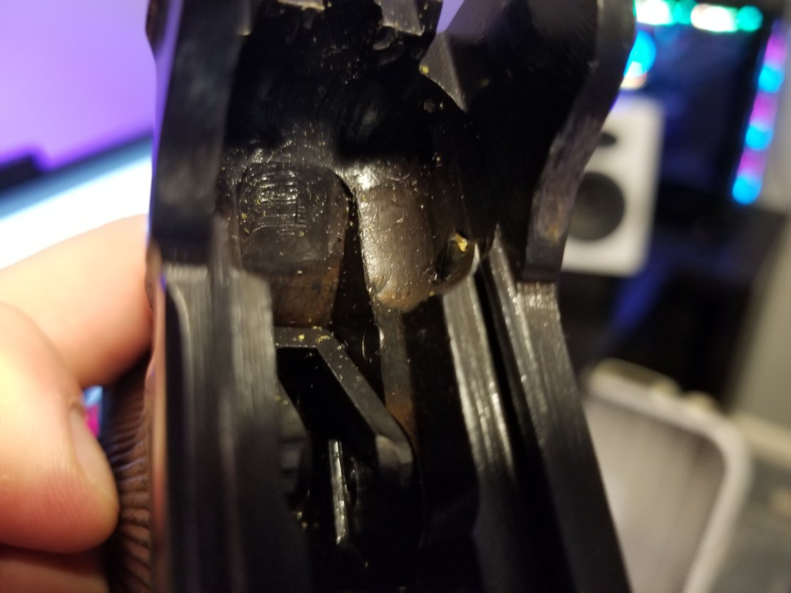

Here is some of the brass shavings that are scattered throughout the lower. There wasn't much on the upper, other than a small flake on the side of the bolt carrier
I should also add that I am not very mechanically adept. I wouldn't trust myself doing anything detailed to fix the issues myself, out of safety reasons, and if anybody knows somebody who works on and is familiar with lugers, I would greatly appreciate a name drop. I'm still learning, even after 9 years of collecting. As for different ammo than the WWB, switching to a 124 grain, any suggestions?

I'm seeing a bit of brass, but not enough to slash your wrists over. Can you show us some "damaged" fired cases? Maybe that will help determine where the brass shavings are coming from and why.

I agree with the brass not being that big of a concern in there. I have a shooter that is GT worked and certified that gives similar amounts of brass shavings. They clean easily enough. Double fire is the real issue.
