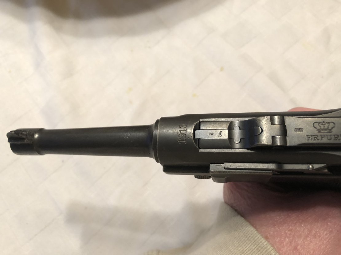

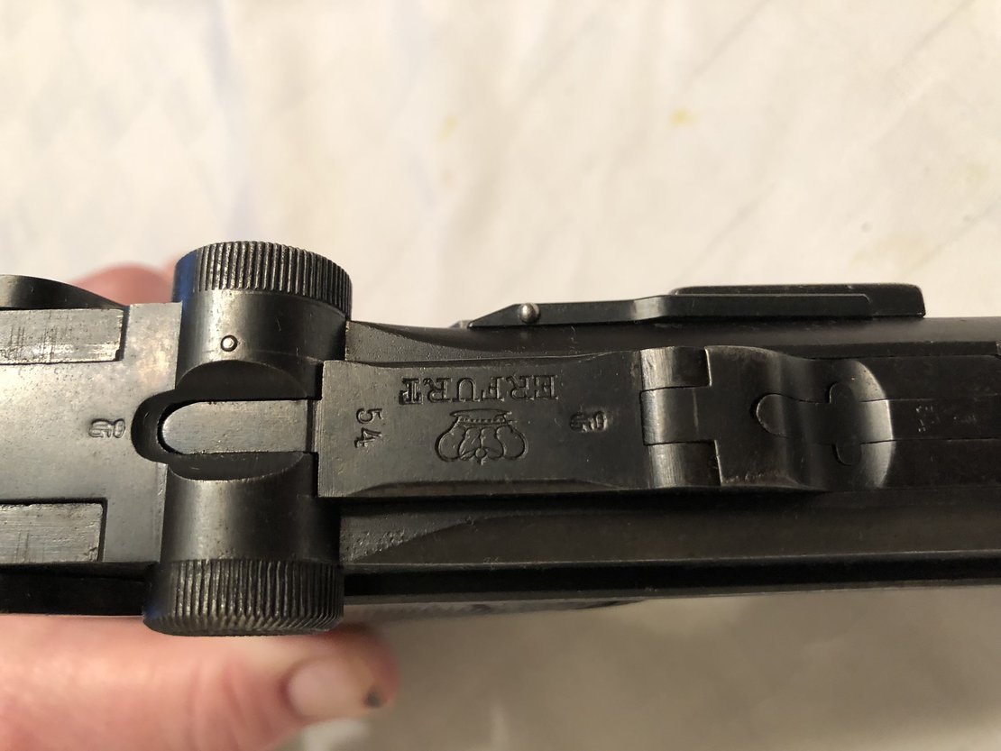

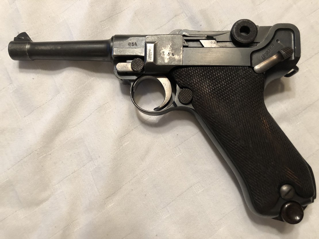

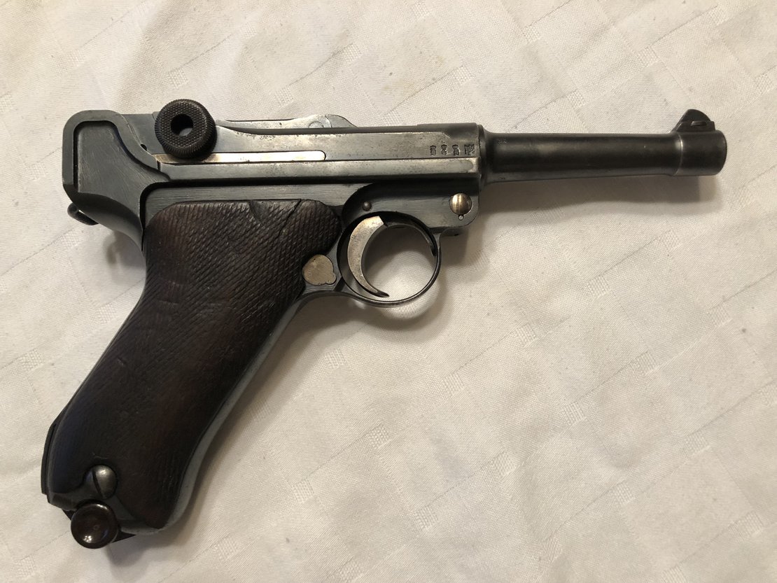

I would appreciate your assistance in reviewing this 1913 Erfurt.
My concern is that it may be a parts gun, as the frame serial number appears lightly struck.
Best regards, Richard

It appears to me that the front of the frame has been filed/ground off and re-numbered.

The magazine is Swiss made and high quality as you would expect.

The sear safety says it was taken into Police service.

Hi, the filed and renumbered frame would essentially remove it from being of collector interest.
The act of changing the serial number could be unlawful and of interest to the ATF if done in the USA.

Hi Richard, welcome to the forum!
It is my belief that this gun is a DWM frame whose original serial number ended with the digits 01, married to an Erfurt top half with the serial number 854.

Poorly altered serial number on frame, = stay away.

Internal worker marks from the factory inspections and the rear milling pattern of the frame would help verify who made the frame.
