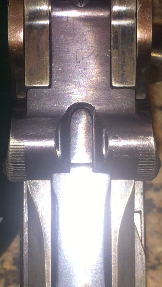

Well cool. I like interesting. I pulled the toggle and firing pin out and got some more pics. I'm wondering, how would you tell if the toggles are original or if they were machined out to replicate dished toggles? I know they aren't original to this frame.

Really need to see the toggle knobs from the top.
Looks like they have been milled to me; no signs of the toggle lock.

Gotchya. At this point, using what little I know, I'm gonna guess milled.

Also no sign of the small pin from the top in the left knob, but it may be there.
Picture is fuzzy and won't enlarge, must be hosted off site!
Please post pictures on the server here.
Try again, closer and in focus, please.
Unread 05-02-2018, 11:10 AM   #18
Don,
There is no pin in the left knob of a dished toggle knob. The axle pin of the toggle joint is retained by the toggle lock. Since there is no toggle lock on this piece, the axle pin is only a friction fit just like the forward toggle link to breech block pin. Did you also notice that the toggle is blank, no DWM? And, it appears not to have been milled down. I repeat, this is a strange piece.

The top with flash.

I'll be darned, there is a pin in the left knob! Curiouser and curiouser. Good call Don. Since I didn't expect a pin, I wouldn't have looked for one.
