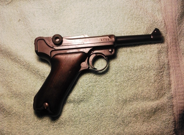

Just got my collection of parts and a shoot able receiver back from GT looking forward to shooting it tomorrow.GT you did a beautiful job. I'll post some targets tomorrow. But heres some pics of it.

Hi to all! I certainly appreciate all the kind words that members have afforded me over the years... I try very hard to produce items of quality and sell them at a reasonable price, especially for members that cannot afford, or, as yet do not know, the cost of dabbling in the luger arena...
G.T. Specialties has evolved into more of a "customer service" business then any other type?.. Although I sell parts and pieces, I mostly enjoy the problem solving, and complete satisfaction of the customer, in meeting their expectations!
Robs shooter is a good example... It is far from pedigree... feral, mongrel, mutt! But, with a few parts from different Luger models and eras... we can make it both functional & dependable, and if we flip over enough rocks and have a little sharing and caring... pretty nice for the price as well! So, a project like this reaches back to some of our other forum members who have made it possible for me to pass on the good faith in repairs and problem solving...
