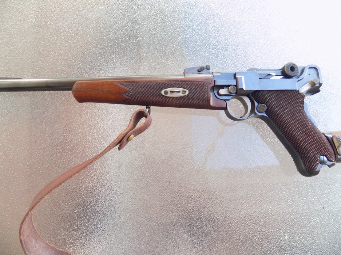

Default Broken Carbine Grip~
While bored I tried removing my foward grip and it broke in 3 pieces. Hugh Clark if I remember did luger magic and after getting yelled at by Debby as it is hers I leave it alone!
Unread 11-08-2017, 05:45 PM   #11
Posts: 3,377
Thanks: 7,452
I remember that saga, Eric. Hugh did a great job restoring its integrity, with naught but an invisible repair joint. You may have helped his success if you sent it directly to him for help instead of trying something at home--there's not much worse job than fixing someone else's unsuccessful "repair." If someone's previous tracks need to be covered, it can take 2X the work, and also sometimes 10X the skill!

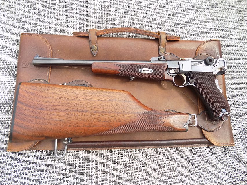

Unread 11-08-2017, 06:53 PM   #12
Right on~ I Dropped a magazine next to my recliner. Half the head got cracked. I tried and it was awefull. I sent it to our hero and it was returned almost perfect! I'll post!
Unread 11-08-2017, 07:49 PM   #13
Nightmare!!! I had loads of perspective client who want to change a will after a husband dies! Thank God He Repairs Repairs!! Thanks for the reminder!! What worse its' Debbys' Gun! PS This is your finest work of your that I've owned that you custom made! TKS
