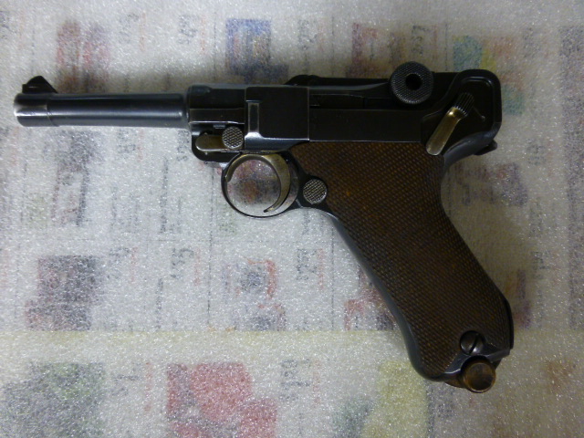

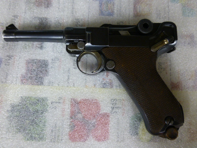

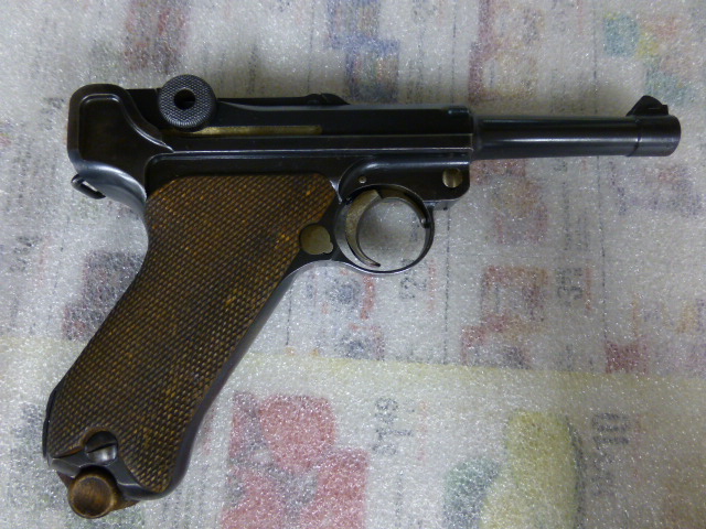

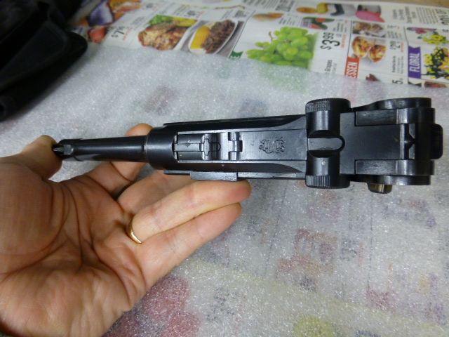

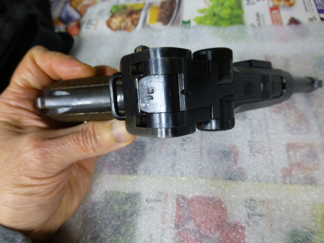

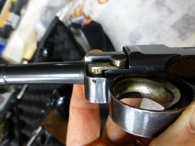

Hi Everyone,
I've had a couple Lugers for a few years now and recently picked up a third and figured it was time I got serious and got them evaluated.
I could use your help on some of the basics: condition, completeness, value and of course just your overall opinion.

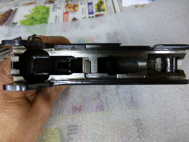

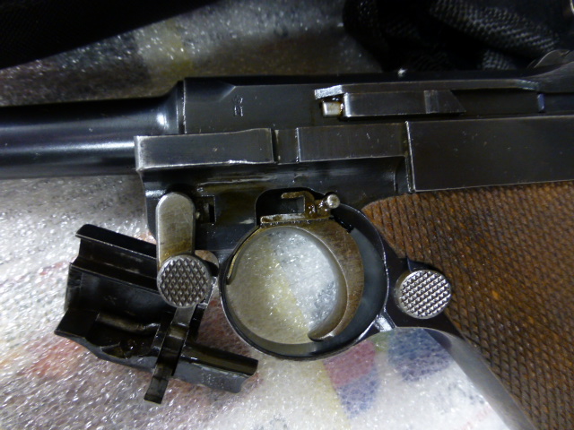

This I believe is a DWM Post WW1 Commercial. The pistol has a script L prefix, very few parts are actually serialized but the ones that are all match and there are a couple crown N proofs. No S/N on the mag base or grips. The grips are in pretty good shape with moderate wear to the checkering, and barrel bore is in very good shape
Sorry I'm not the best photographer out there
The other pistol is in the P-08 section
Thanks a ton for your help!

It's an "Alphabet Commercial, all right. Finish looks original, seem in good shape. Unless I've missed it, you didn't mention its caliber. A .30 Luger is usually worth somewhat less than a 9mm because the ammo is significantly more expensive than the 9mm.
From what I can see, think in terms of slightly under a thousand, to somewhat over a thousand dollars. Commercials also go for less because they lack the wartime connection and mystique. If this is an all-matching gun, it is collectible because of its good condition, and you may want to avoid making it work for a living.

Is it stamped 'Germany' anywhere on it?
9mm is very nice

No import or Germany stamp on it
I've been trying to find the production year for the "L" suffix
The parts luger is import stamped under the barrel

According to Still's:
L block would be the very last part of 1922, and most of 1923

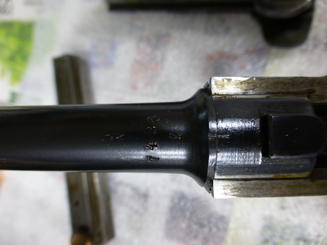

If it's a 9mm (which I doubt) it's very rare.
Can you show a picture of the muzzle?
Mike C.

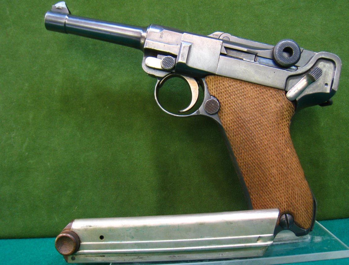

Several years ago I had two of them, and I was strongly tempted to buy a third one only last year, I don't recall ever having seen one 9 mm.

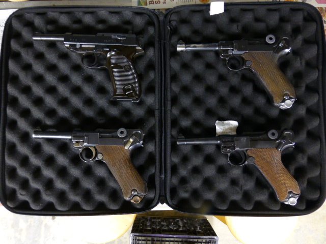

Well what do you know look at that!!!!!!!!!!
Good thing I have not tried to fire it yet
BYF 9mm on the left, and the DWM on the right and apparently a .30
Could have sworn it said 9mm when I got it I checked the sales invoice and it says caliber not marked
Looks like I have some deciding to do. Buy some .30 or sell this one
THANK YOU very very much!

You would have been safe if you tried to feed 9mm ammo into a 30 Luger chamber.....it just won't fit!! I own a few 30 Luger handguns and really enjoy shooting them. A number of forum members here feel the same way. The ammo is more expensive, but is a hoot to shoot.
