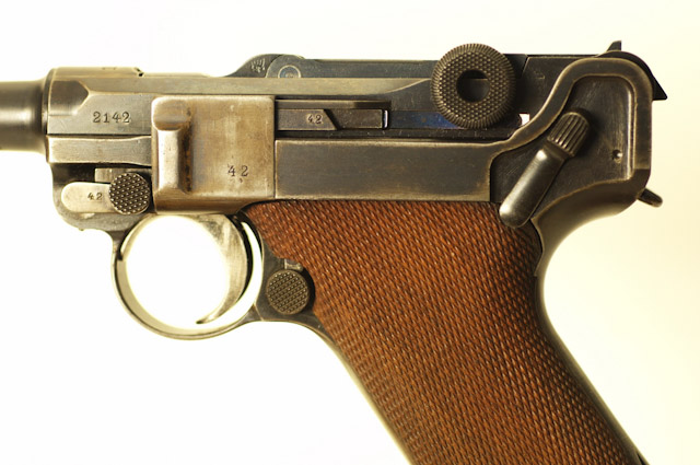

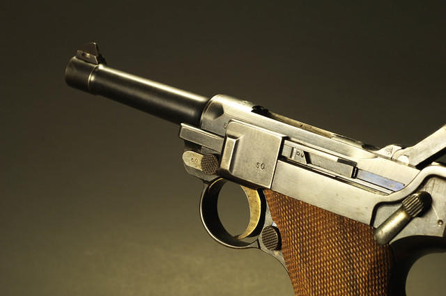

I can confirm the 1916 transition date. My DWM from early in 1916 is not relieved, and the one from later 1916 is relieved.
"A" block:
"N" block:
