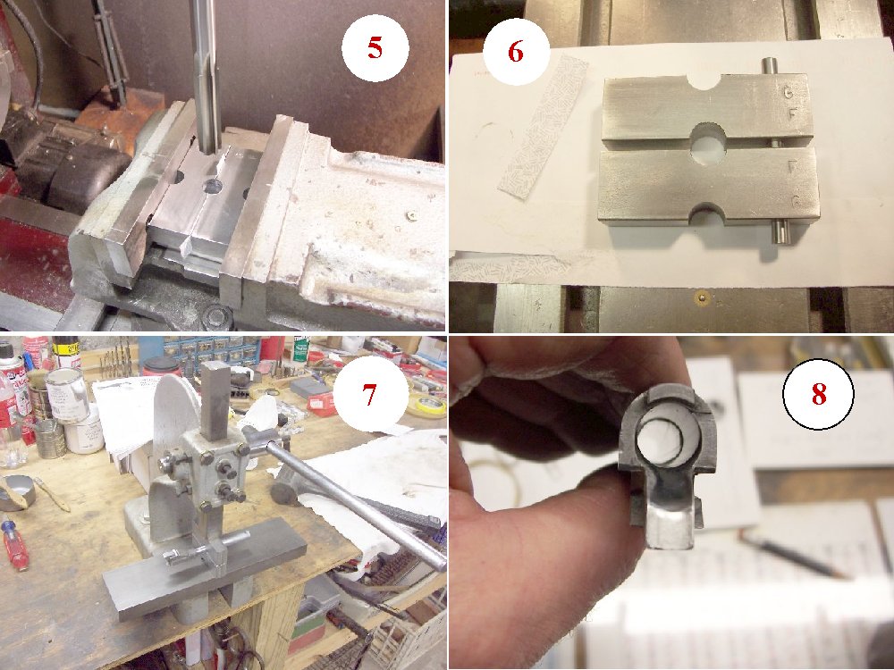

The base diameter of the barrel is .515" and the bulge measured .525". Repairs were effected using two steel squeeze blocks measuring 1" x 2" x 5/8" and one .517" reamed hole and one .515" reamed hole. A steel reinforcing rod of 8.75mm was used to keep barrel from flattening while being 'massaged'. The squeezing was done in a 1-ton arbor press assisted by one BMFH...
The squeeze was initially done in 90º increments with a .004" spacer between the .517" blocks; then without spacer; then with spacer & .515" blocks, then without. Finally the barrel was squeezed in ~10º increments in a radial pattern.
At this time, the bulge measures .516", one thousandth over the surrounding barrel. It could have probably been shrunk down to the base .515" but the 8.75mm rod was the closest available. Interestingly, an 8.8mm rod [9mm Luger bore size] would not go in.

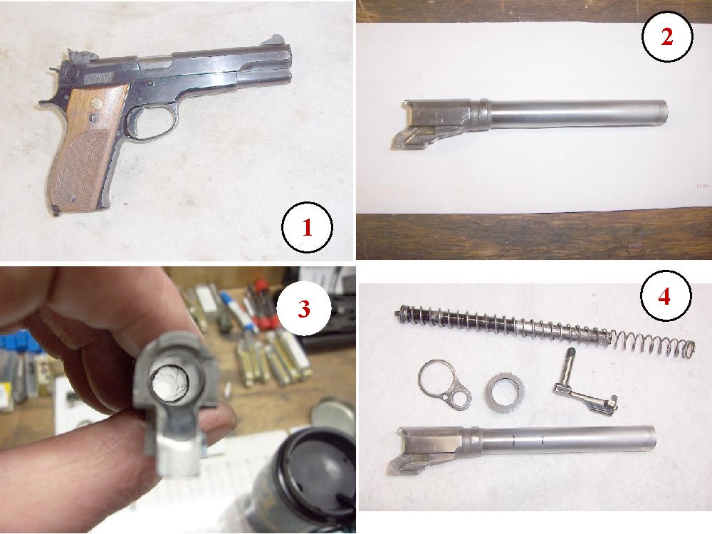

Here's the step-by-step process, as quickly as I could snap pictures. Let's follow G.T.'s repair process, shown in the pics below!
1- The Model 52 as received. Complete, but worn and dirty.
2- The barrel. Sharp eyes will notice the bulge about 3/4" forward of the locking lug.

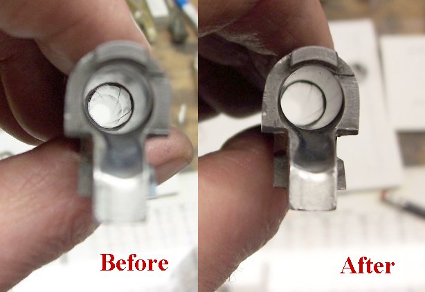

3- Closeup of the bore. The shadow in front of the chamber end is the bulge. It was quite noticeable when running a patch through the barrel. The patch would suddenly 'loosen' at that spot.
4- Barrel showing the marks where the bulge is located.
5- Reaming the "G.T. Squeeze Blocks".
6 - Finished squeeze blocks, with an added indexing pin (later shortened).
7 - Press showing barrel mid-way through the operation. Bore reinforcing rod is not visible, but it is in place.
8 - Final squeeze - shadow is gone!
Final pic shows a comparison between the bulged barrel and the repair.

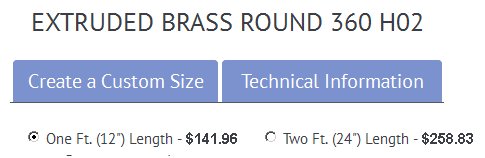

Can a person purchase a "BMFH" on line or was this also a home built item?
My BMFH is a home-made job, having a 2 1/2" dia chunk of brass 4" long fixed to a standard hammer handle. I originally made it for knocking the hub nuts off my Austin-Healey. The Healeys had a dinky little lead hammer that was inadequate for the task. I made two of the hammers while working as a millwright. My supervisor was pissed but I did actually use one at work.
Judging by the prices for brass at www.onlinemetals.com, I have $100 of brass in these two hammers...
