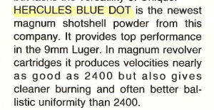

While browsing through my 1979 Speer Reloading Manual, I noticed this interesting note in the section listing powders based on their burning rate, from fastest to slowest...
Hi,
I've tested Blue Dot extensively.
For me, and many do not share my opinion, you have to load Blue Dot too hot to get any accuracy out of it in a 4 inch barreled, P-08, Luger. Also, the muzzle flash is like that of a flare pistol.
I've had some pretty good success with it in an 8 inch barreled, LP-08, however; as it is the second most accurate powder, with this pistol, to date.
Though it is not one of my go to powders for the 9mm Luger, in a Browning design pistol, such as the Browning Hi-Power, it might be just great.
Your thoughts?
Sieger

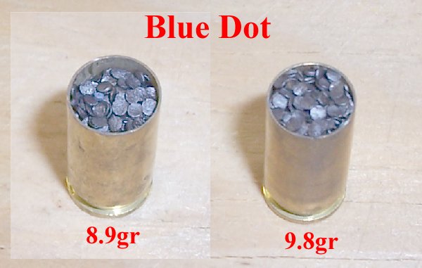

I was somewhat skeptical of the Blue Dot loads that Speer recommended for the 9mm Luger cartridge in their 1987 manual. So I measured out a couple loads and poured them in a 9mm case. Here's what Speer recommends as max loads of Blue Dot for -
95gr FMJ bullet = 9.8gr Blue Dot
115gr FMJ bullet = 8.9gr Blue Dot
Here's my cases...With weighed loads...[pic attached]...
When the Freedom Arms 454 Casull first came out, I bought one of the 'field grade' 8 3/8" bbl stainless revolvers. One of the recommended handloads used a compressed charge of two different powders, layered not mixed. (There was no powder available at that time that would give the energy/velocity that FA advertised). It was pretty scary to shoot, and 'bone jarring' is an understatement.
I imagine these loads that Speer recommends for the 9mm Luger cartridge would be scary, and bone jarring, too...
Hi,
To me, these loads are DANGEROUSLY HOT, and shouldn't even be listed here, less someone actually try to load them!!!
Sieger
