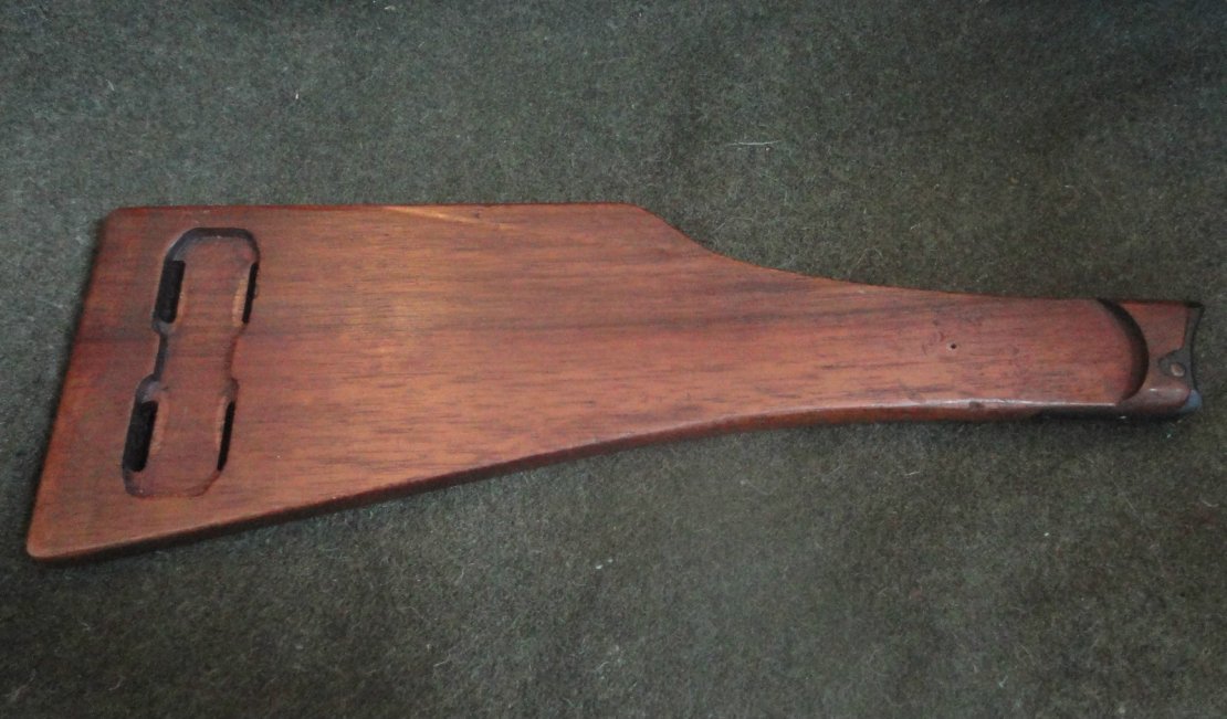

Exclamation WW1 German Artillary Luger Shoulder Stock

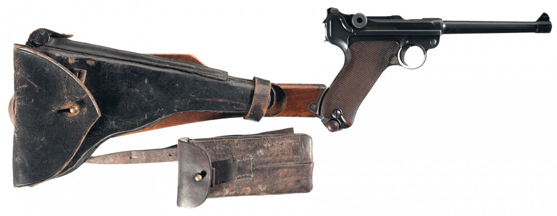

in case the ad vanishes, here's some of seller's pictures
i would appreciate to know if there's something blatantly obvious that a novice can spot about this piece as being fake or reproduction
Unread 09-03-2013, 12:47 AM   #5
Darius..everything is wrong with it! Take a close look at an original Imperial Artillery stock and the differences will be striking!

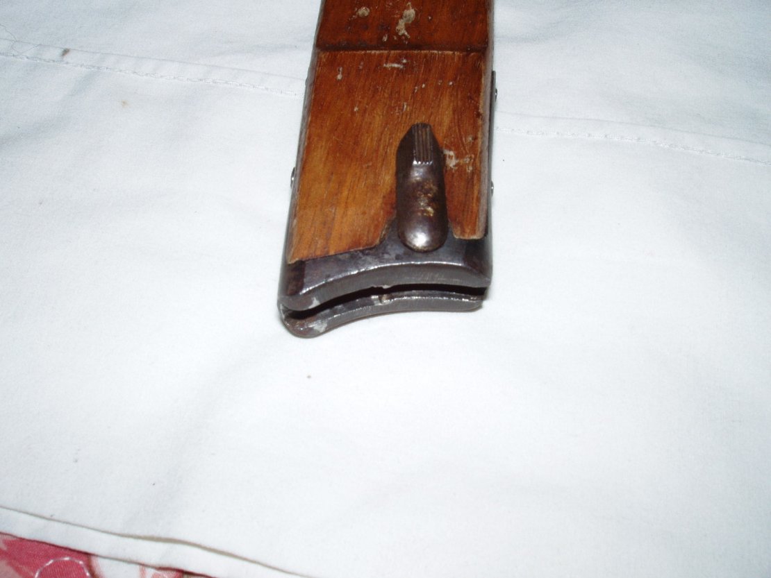

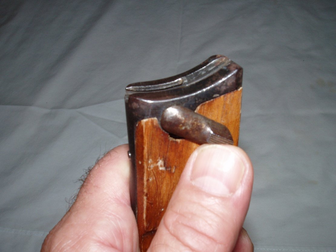

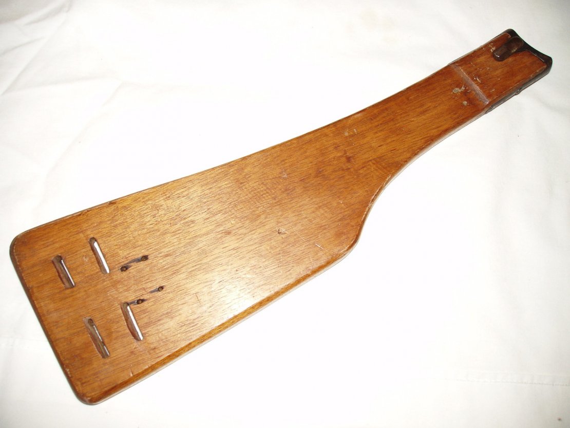

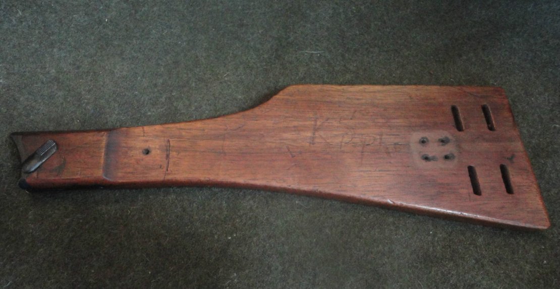

..i had a hard time finding pictures of one in posts, but came across this one that was sold on fleeBay, which appears to be very similar to the above post!

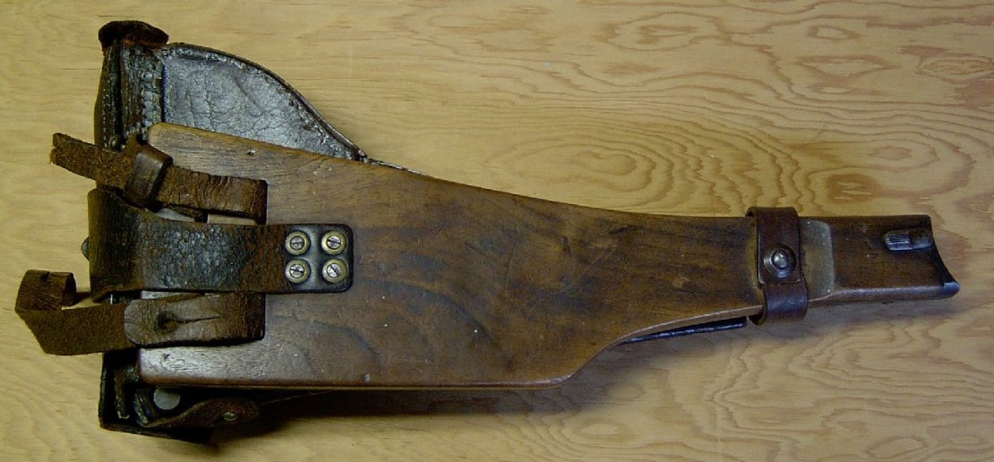

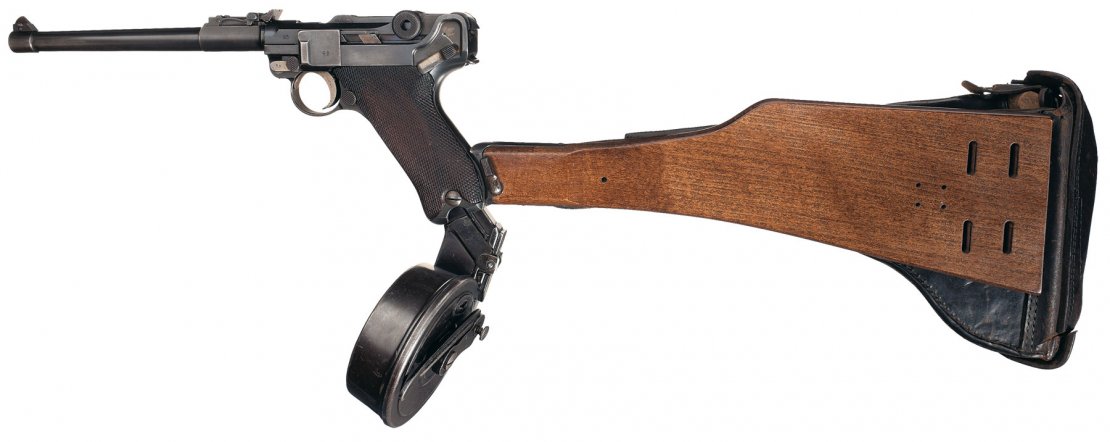

most of the pictures i've seen the stock is attached!!

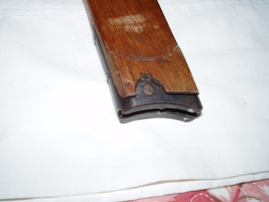

..not sure if this one is an all original stock

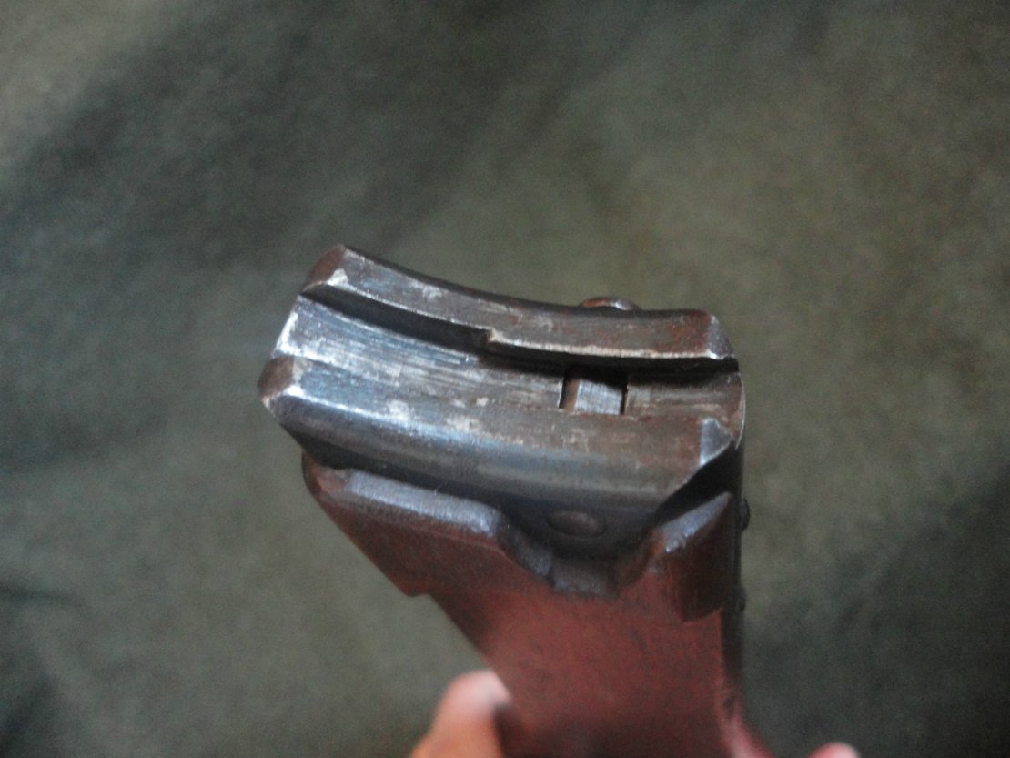

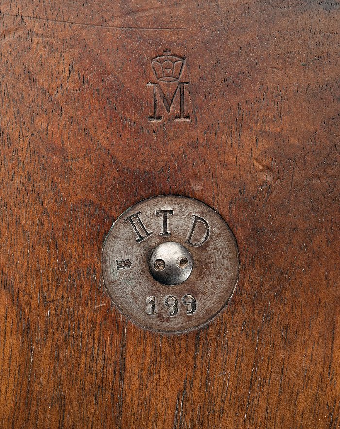

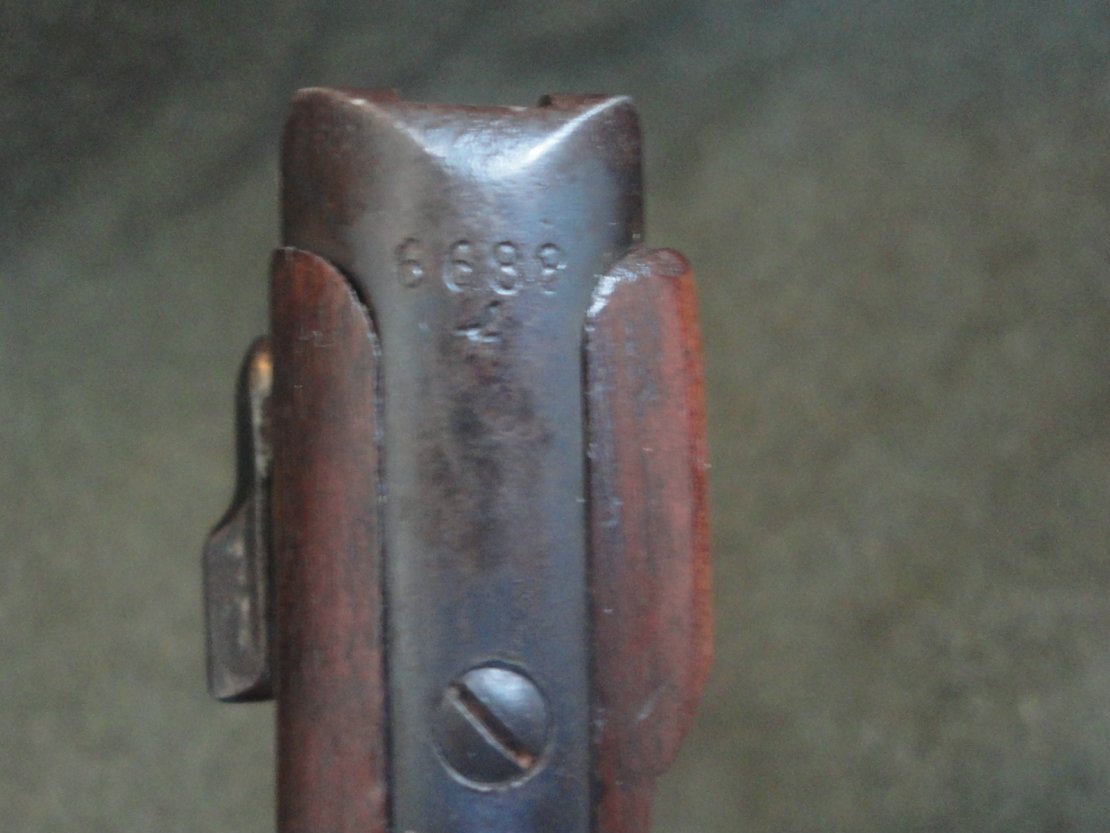

..this one has some cool markings
Unread 09-03-2013, 03:22 AM   #10
Maestro:
It would help if you stuck to one topic in your responses. The topics you address are all over the place and it makes it difficult to address any specific inqiry.
Unread 09-03-2013, 07:03 AM   #11
No need to post everything you are discovering, either. Most of these variations and accessories are already familiar to the group.
Unread 09-03-2013, 12:58 PM   #12
Darius.Original German Artillery and Navy Stocks were made of a European walnut. You need to know what it looks like.
The iron is cast. Originals were machined. Subtle differences but it's all in the details you need to recognize.
Hole placement..Original German stocks had 4 holes placed correctly for the top closure and attachment stock strap. Anytime you see them placed as funky as these are you know something isn't right.
The shape of the wood..this wood is incorrectly shaped. Subtle but you can see it. There are a half dozen other little tells but once you get a good look at an original stock in your hands..they will pop out like a herpes sore on your date.

Adding to Jerry's points, on this example, they drilled the four holes where they roughly thought they should go, but then neglected to add the single hole that holds the leather strap at the stock wrist!! There is no evidence that any leather was held snug to the wood at this point, nor any indentations, which the metal washers would have left.
