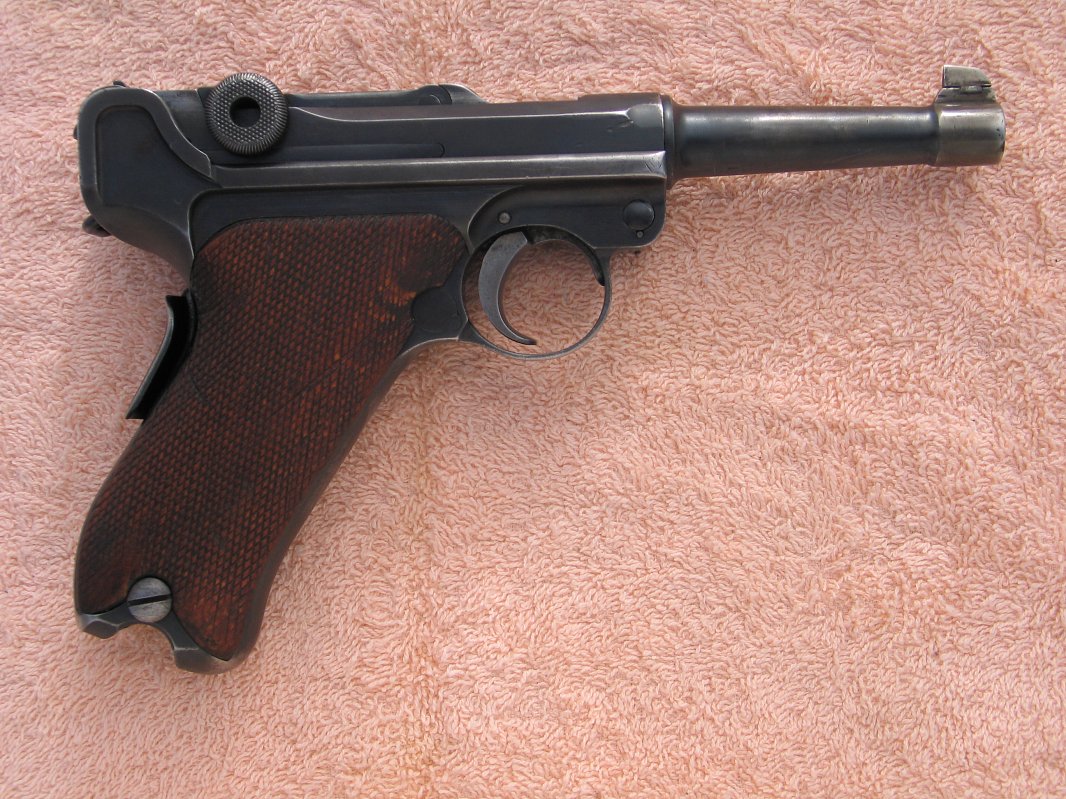

I had picked up a completely stripped receiver at Allentown, on purpose because I had noticed GT's comments about now doing barrels.
I sent him two receivers and two barrels, figured I would give him a challenge, turned out, I gave him more of a challenge than intended.
Top is a 1900 receiver (I was told, is it?) with a nice barrel I had picked up some time ago in 30 Luger.
Bottom is a WW1 era, but scrubbed date receiver that he put on a 9mm barrel.
Evidently the witness marks were missing so much harder for poor GT.
As you can see, they turned out very well. I have plenty of parts for a 1908 to build up a shooter, but not as many 1900 parts
KUDO's to GT for a job well done!

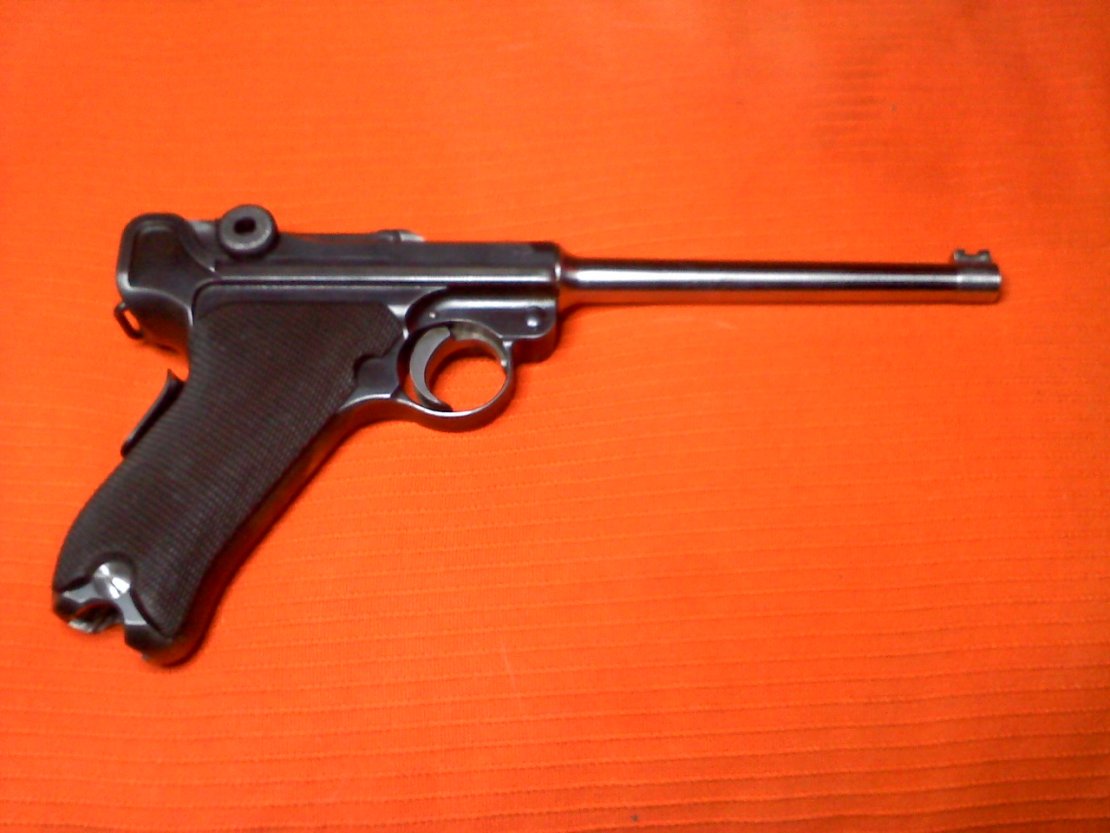

G.T. installed a barrel for me, too. It is now on my lesser 1906 American Eagle (short frame), a 6" pencil taper .30 Luger, which was created by turning down a standard configuration barrel and modifying the sight block and barrel band. Our own Ed Tinker sold me the barrel, This replaces the nasty 3 3/4" military style barrel with mangled sight block and weird sight leaf that was on it when I scored the gun at RIAC a couple years ago.. I promise to post some pics in the near future. G.T. got the headspace correct, and the pistol actually seems to chamber/work better than before. A test mag with six rounds was gobbled up without any indigestion whatsoever! I report that I am one happy camper!

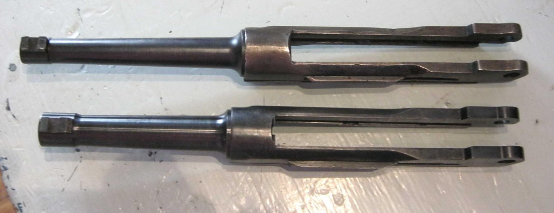

Thanks, Ed, what do you think of it now? A couple quick phone pix, old bbl (top) and new bbl (bottom)

Glad you guys like my concept made manifest! Thanks again, G.T., for your fine contribution. My local machinist, well... He had tapered the front of the bbl. first and then created a straight cylinder near the rear, using the extra material there, so he could hold it while milling the barrel band and sight block. Finally, he resumed the taper and contoured the barrel flange. There was a step where the taper was resumed, and another where the taper meets the flange. It took me about an hour to carefully straighten it all out on my lathe and establish the final surface. Otherwise, the nice right grip panel came from Hugh; swapped the janky old one and some dough for it. Front sight--not yet installed-- and grip safety spring from Tom. I had to make an over-sized safety lever pin myself, as the one in it kept falling out when the left grip was removed. The next step in this extravaganza is for me to TIG weld a small chunk broken out of one rail of the barrel extension and get it worked down straight. Finally, I'll try my hand at a little rust bluing and straw finishing. All this done, I think I'll be very close to breaking even in its then value as a nice shooter versus what I have spent on it. The key, I think, is not to charge yourself for your own work!

I really like the metamorphose!! You are truly producing a silk purse from a sows ear. Congrats, and look forward to seeing the final product.
