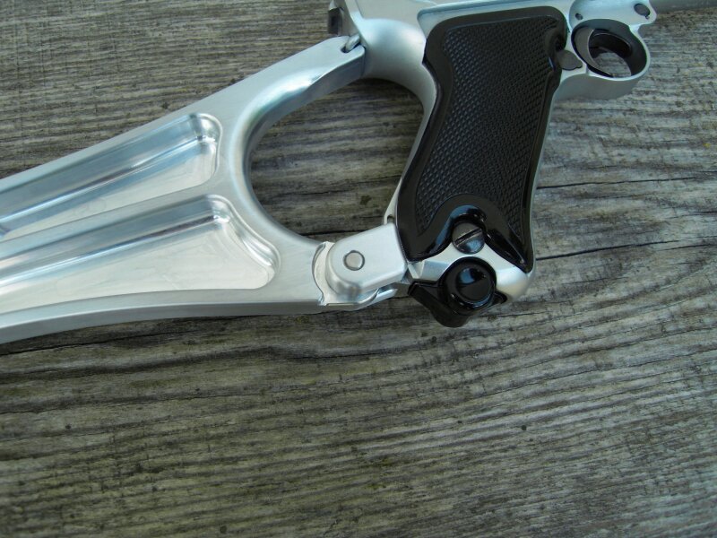

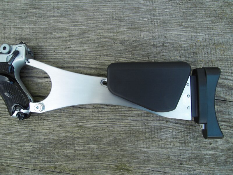

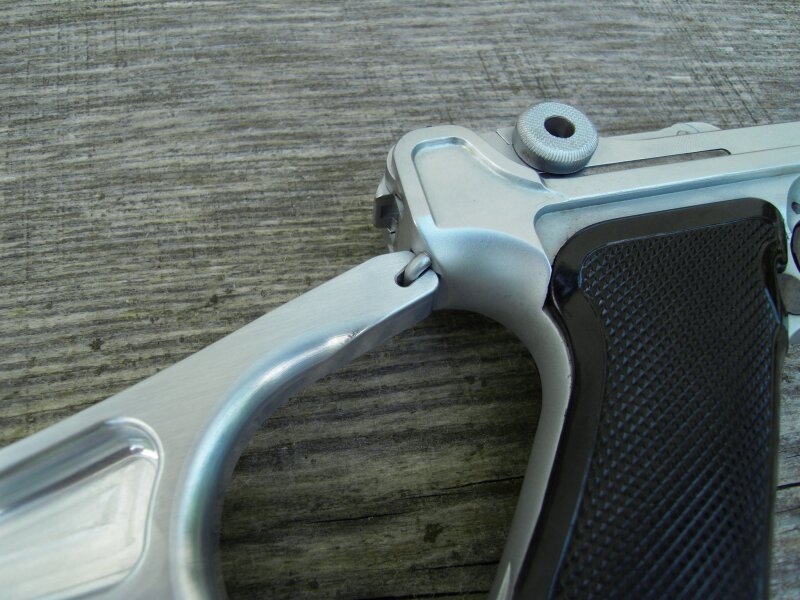

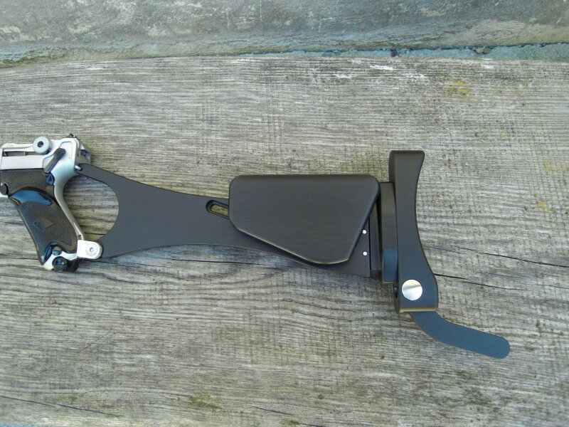

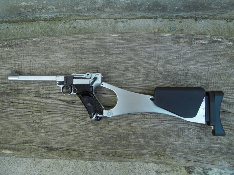

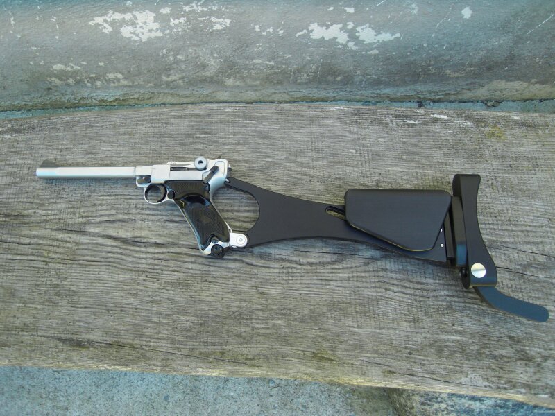

Hi,
Like to Show my new P08 shooter .
Some pics.
regards
Otto

That's really a beauty. Did you build it?
Unread 07-21-2013, 11:23 AM   #6
pors12
Join Date: Feb 2011
Location: Austria
Posts: 115
Thanks: 24
Thanked 59 Times in 21 Posts
Hi,
I just did the stock, the luger is an old rework
from the 1990īs by a gunsmith from Germany.
I bought the gun some weeks ago on egun .
regards
Otto

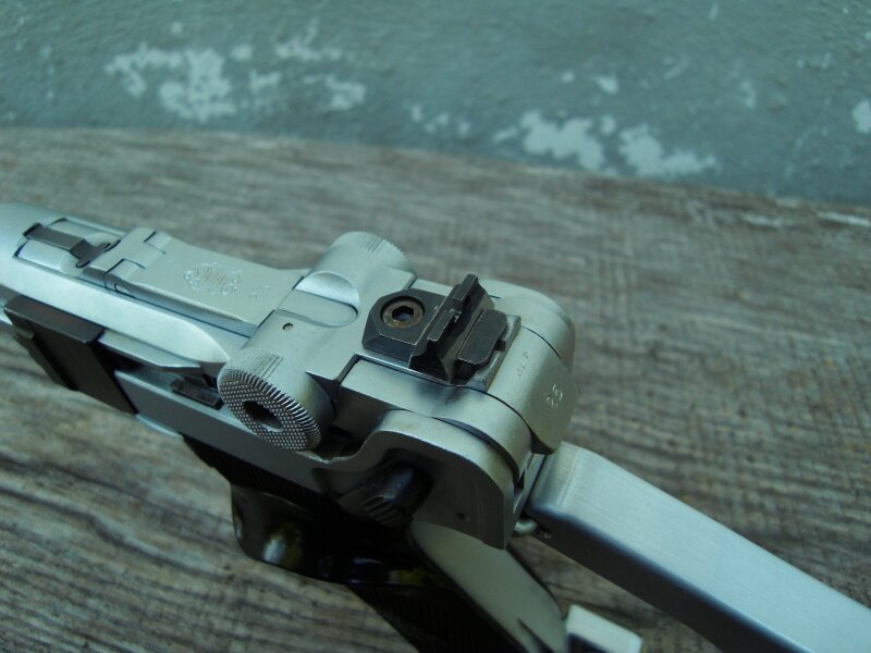

what sort of rear sight does this one have ? soldered on or dovetailed or ?
could you post closeups of the rear sight ?

Hi Bill,
Here is a pic of the rear sight.
I am not happy with it, because it is a design to shoot
without the stock. I think I will put a tang sight on it with
a small hole ( about 1.5 mm), then it will work
perfect with the stock. Otherwise a reddot would be nice too .
The finish of the luger is sand blasted and chromed.
The stock is made out of 7075 alloy and just polished.
regards
Otto

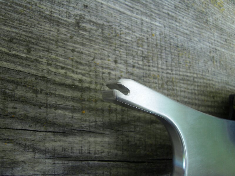

Unread 07-22-2013, 04:40 AM   #13
Is your stock actually gripping the lanyard loop or does it merely slide over it for support?
Unread 07-22-2013, 05:14 AM   #14
lfid
Location: Wichita, KS USA
Posts: 453
Thanks: 573
Thanked 96 Times in 53 Posts
Otto,
have you had any problems with the rear sight loosening up ? is it anchored only with the set screw ? or soldered or pinned etc ?
I suspect a red dot on the same location would not survive very long
any reason why the sideplate is not also chromed ?
again very creative and cool !
Bill
Unread 07-22-2013, 06:49 AM   #15
pors12
Join Date: Feb 2011
Location: Austria
Posts: 115
Thanks: 24
The stock just slides into the lanyard Loop, just to
support it.
There is no Problem with the rear sight it is secured
with the bolt and some green loctite.It fitīs very tight
into a cut out area in front of the original rear sight.
I also have a chromed sideplate for the luger, but
I just like it better with the black one.

Otto
thanks !!! for the added rear sight info

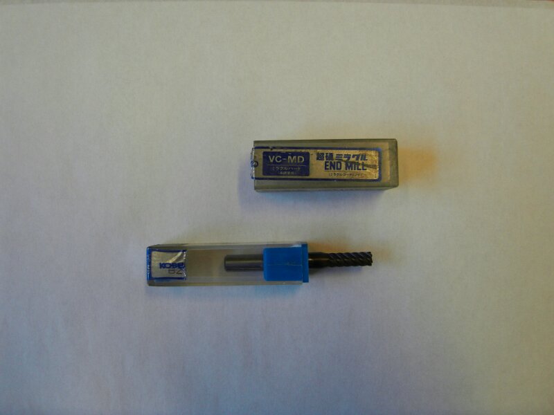

how did you machine the inset toggle area for the bottom side rear sight base ? usually these rear toggles are very hardened and resist typical machining efforts
how deep did you machine the base area into the toggle ? great idea I dont recall seeing anywhere else
I can see where the inset area for the base would help a lot to handle the rearward setback forces and apparently the bolt is high strength to handle the vertical setback when the rear toggle ears contact the frame - and apparently remaining toggle flat is thick enough to survive ok
maybe on your setup the toggle slap onto rear frame is mild or toggle stop occurs with the compressed spring ?
does your custom barrel weight require any handloading special ammo ?
thanks
Bill

I use 124 grs Hornady RN and 4.8 grs. 3N37, works good
on this luger. The gentleman who sold me this luger
had good experience with geco 124 grs. ammo.
In our days it is possible to cut hardend steel up to 60 HRc.
You need a good endmill and a rigid machine tool.
To cut hard steel "Kobelco" -Tools work really well.
I am operating a Mori Seiki milling machine to cut hard steel.
The stock was made on a Fanuc Robomill.
regards

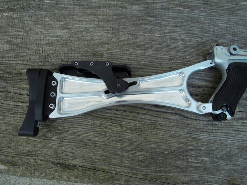

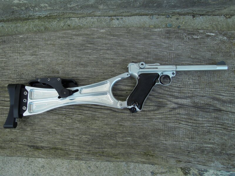

Hello,
Made this one for a friend.
I thought it may be of interest, so I took some
pics of this stock, before I put it in the box to ship it.
best regards
Otto
