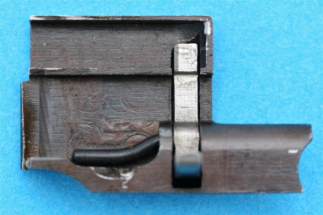

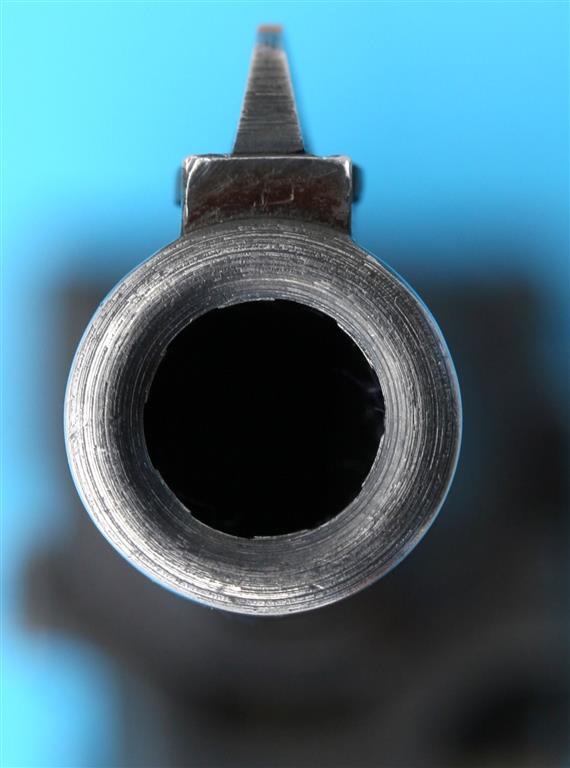

Please check. Is the entire trigger plate (including the pin) blued?
Is the muzzle completely blued?
Thanks, Marc

Here are photos of the areas you requested.

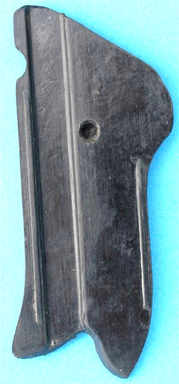

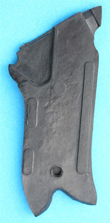

I am not convinced that the grips are OEM. Could we please see a clear focus close-up of the inside of the grips? From the initial photos of the grip exterior and the fit in the area of the safety lever they appear that they might be reproduction grips.

Thanks for the pictures. It confirms that blued retention pins were normal (both my 42 date Lugers have them). Also looks like the muzzle is blued too, right?

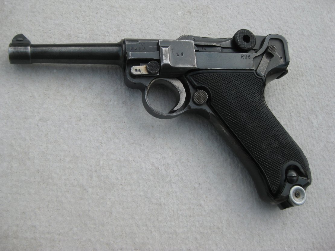

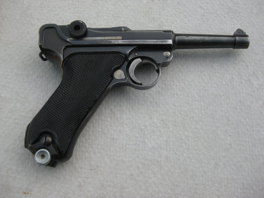

Tom, that's a nice one. Wish mine were as pretty. Yours is about 500 later than this one.

John, some pics of the grips. I think they are OK.
Steve, I see yours has an Eagle/N proof which would be correct for your serial number range. Your gun looks good to me!
