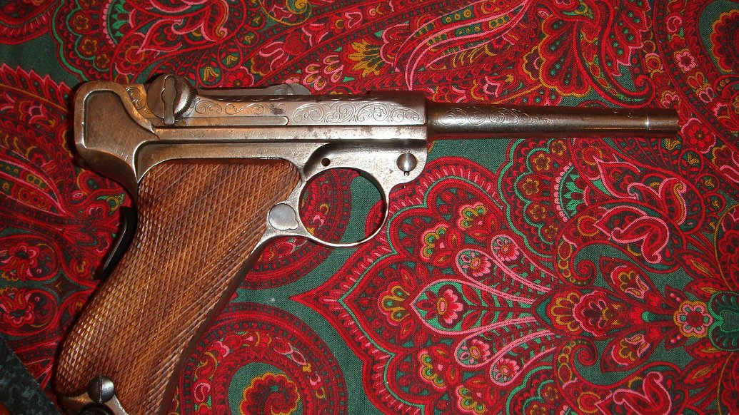

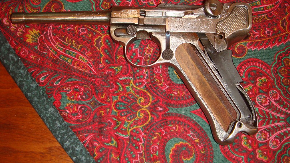

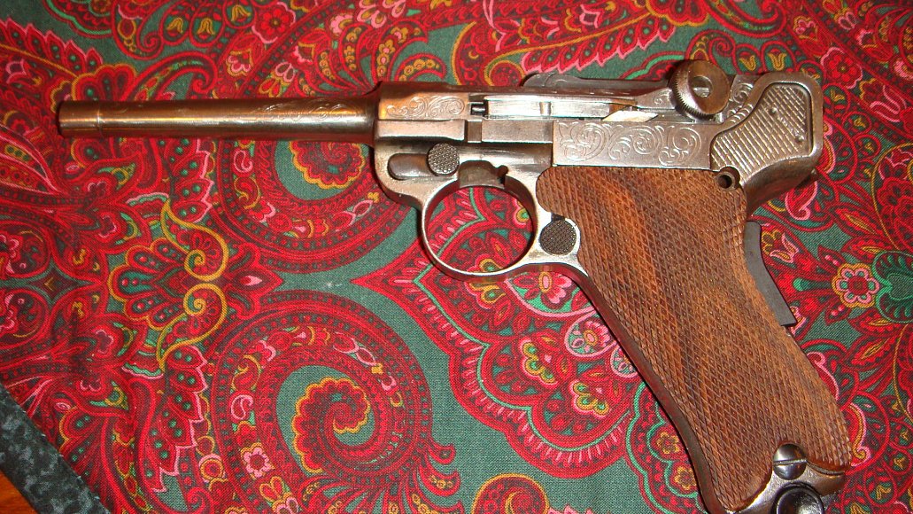

Default Pictures of 1900 AE
Hi,
I am attempting to post some pictures. If successful you will see an engraved 1900 AE that was chrome plated. Wen I picked it up it did not have wood grips, grip screws, grip safety or mag. It still need trigger, trigger spring,trigger plate and an extractor. So it is a work in progress.
This is the same pistol that was advertised on the forum back in Feb/Mar time frame. If I can find that thread I will post info.
Aldo35

Default 1900 ae
Hi,
This pistol was originally offered on 1-21-2013 in the want to sell section by Capt Willard. If you go to that date in the for sale section you will see some better pictures of this pistol.
I hope to find all the missing parts and a cure for the lack of a front sight and have my self a fun shooter.
Aldo35

the front sight appears to be missing the sight block also. i think this was soldered to the barrel band.

No, originals were part of the barrel turning. This one has been irrepairably damaged.
