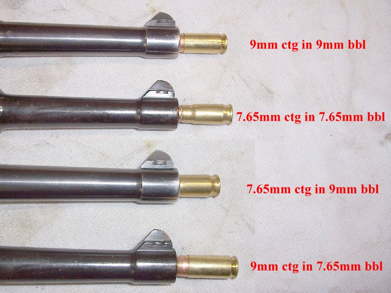

OK Bruce - Since you have both a 7.65mm and a 9mm Luger cartridge, try this - Stick the bullet end in the muzzle and compare it to the attached pic...
(The 7.65 in a 9mm will swallow the case neck as well...)
