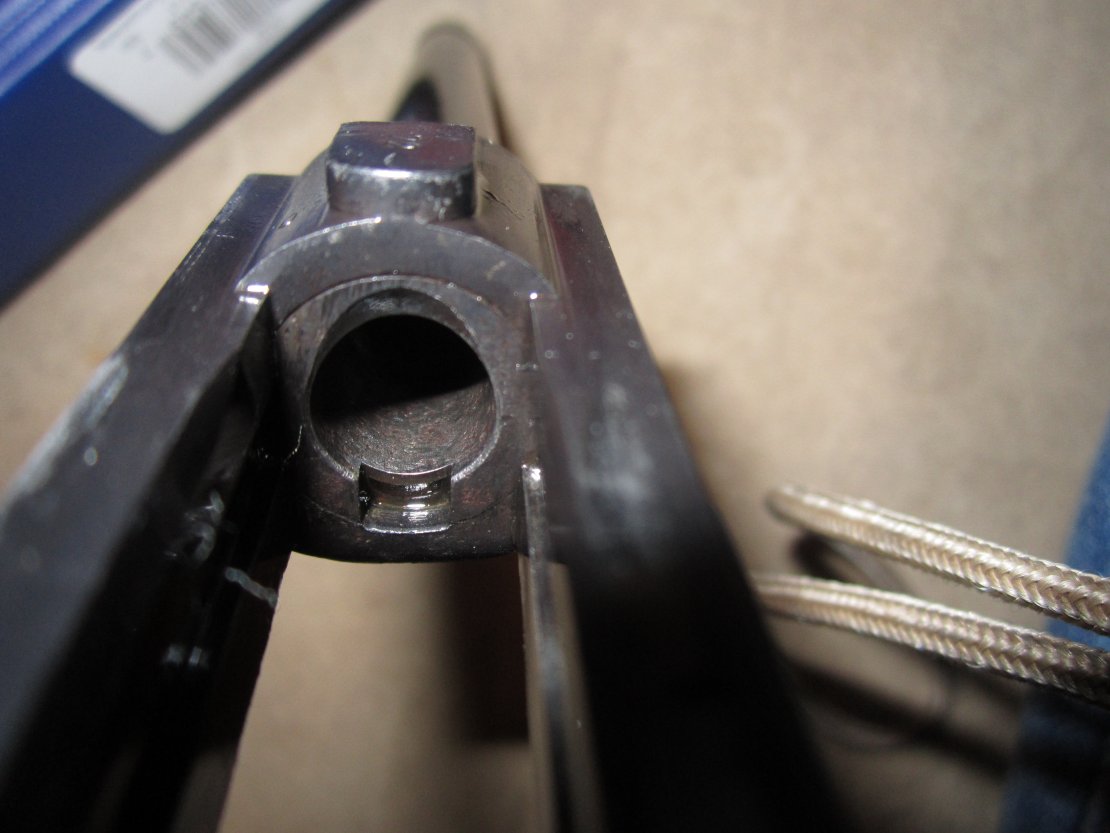

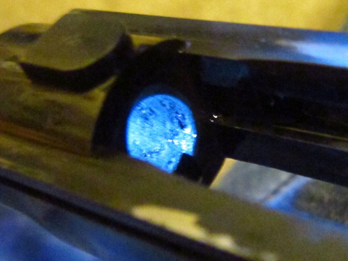

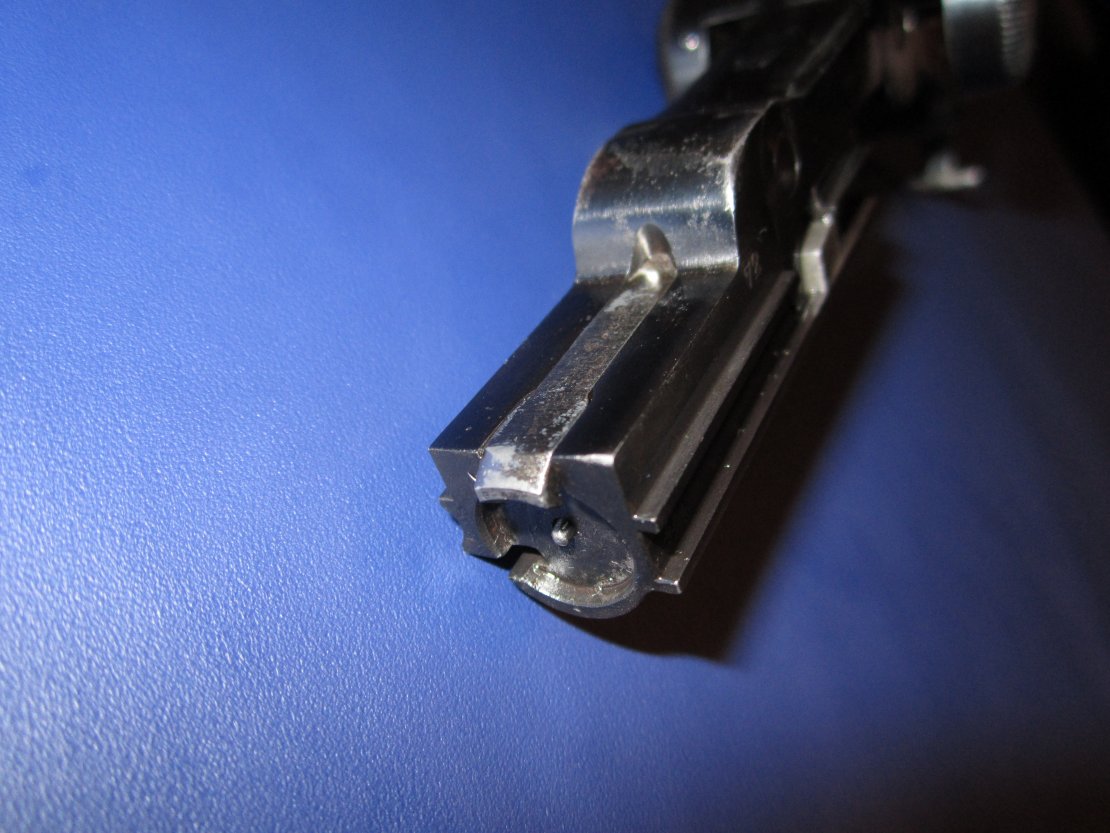

I just started reading about this spent cartridge issue on the luger. I have a 1900 luger I have. I only shot 1 full magazine of bullets thru the gun. Out of the (8) bullets (2) of the cartridges did not extract properly. Now mine I could easily get out with my finger with no problem at all. I didnt really ponder on this until reading this thread. My gun does have some pitting within the chamber where the shell goes. This particular gun shoot a .30 cal round. Before I shoot it I took some 600 grit sandpaper and some oil and lightly ran around the inside of the chamber. Note, that I did not do any hard sanding to remove the pitting. I didnt wanna reove any metal. I was more just trying to smoothe/clean the bore a little more. But I was just looking at my extractor on the gun, and my extractor does move quite easy with my finger. It even moves a little with no pressure before it starts having tention. I watched a video on you-tube to see how to remove the extractor. My extractor is flat on the top of the firing pin section of the toggle with no holding pin on the side that I can see. My question to yall is do I need to see a gunsmith a smooth out the bore more and try to remove the pitting? And also the extractor, how does it come out and should I replace it due to the low tension on it. And does it have a spring under it as the extractor with the holding pin does |

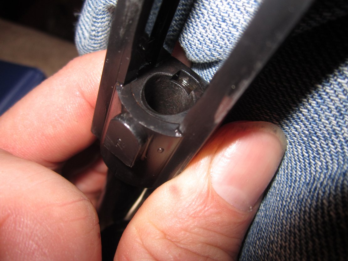

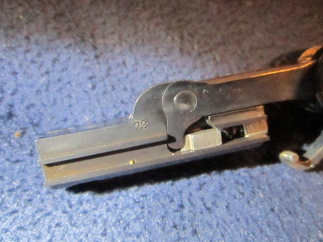

Heres some pictures of my extractor and the pitting inside the bore the best I could get the picture to take.

Note that this luger has had a new barrel installed at one time I do believe. There are no serail numbers on the barrel. Also the rear toggle has been modified to have a peep sight instead of the V-shaped sight. I have been advised that these have already de-valued the gun a little and this would be a good shooter gun. So... being a shooter gun, Id like for it to extract the shells properly. But I dont wanna just start changing things out. This gun still has allother parts matching numbers, even the grips.
The extractor I am still curious about that issue. Is this proper for this type of etractor, being a little loose at first. Is there a spring underneath it? And trust me I aint wanting to shoot a whole lot. But just shoot every now and then. And maybe let some people that know what the gun is and what it means to history be able to shoot one. Thanks Glenn |

The extractor is the proper type for a M1900. It is a spring itself, so there is no additional spring under it. It used to be very difficult to find replacements for them, but now some good quality reproductions are being produced. I doubt your extractor needs replaced (at least until it breaks, which hopefully won't happen
).From your photos, it looks like your extraction problems may stem from the chamber. It looks pretty nasty with lots of pitting. A gunsmith may be able to polish it up a bit, but if that doesn't work, I would think the only alternatives would be a barrel reline or another replacement.
