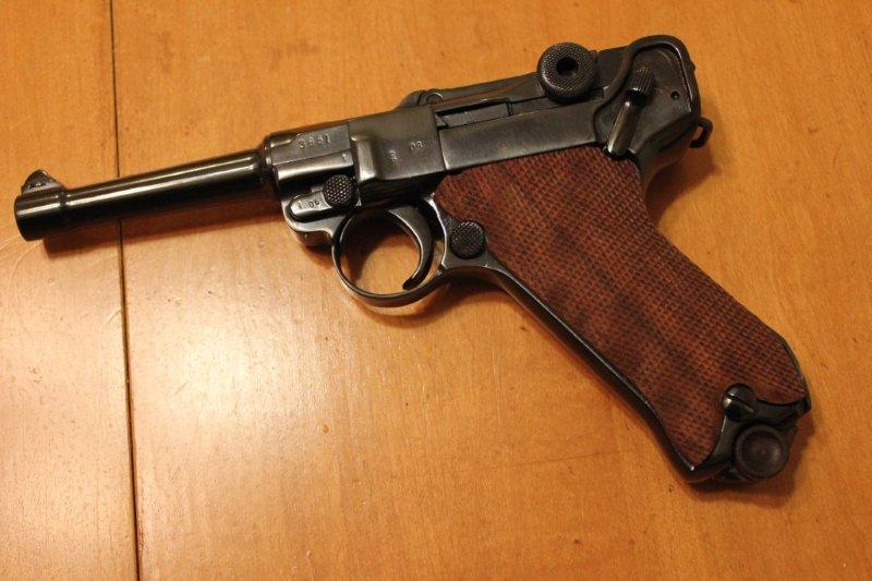

Here is my first and only Luger...among a number of milsurp pistols WWII - Cold War eras.
I just wanted to try out a Luger without spending a fortune, and wanted a "shooter". Top end is all matching parts, bottom end is all matching, but top & bottom don't match. I got two MecGar mags for it.
It appeared to have been reblued then rarely, if ever fired. I have since corrected that situation. It's an OK gloss blue but they buffed the heck out of it because the 1917 is barely visible. The other marks are fairly sharp.

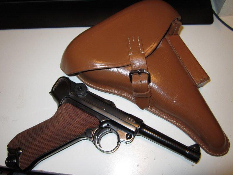

Holster is a reproduction from North Africa campaign. My dad served in North Africa in Army Air Corps cryptography unit 1943-end of war.

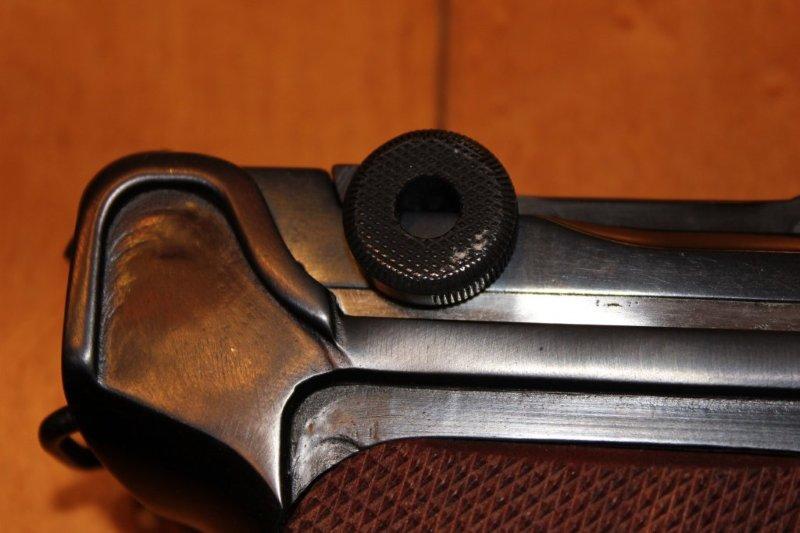

Nice shooter. The grips are also modern reproductions.

Originally Posted by siegersallee View Post
How can you tell the grips are modern reproductions?
One tipoff is the big gap/incorrect fit of the top front of the left grip (above the magazine cut). It should hug the frame relief.
Unread 05-31-2012, 12:42 PM   #5
Rich is right, that and the area around the safety is very sloppy.
The very sharp, pointed diamond tips on the chequering are also a giveaway. The grips must always show a corresponding patina to the balance of a pistol. Pristine metal with beat up grips or pristine grips with beat up, refinished metal will be an immediate red flag.
