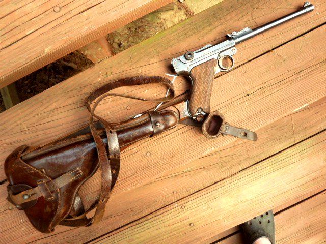

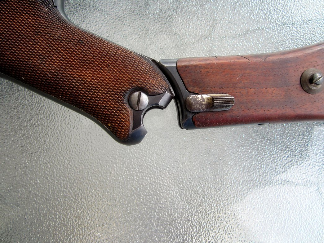

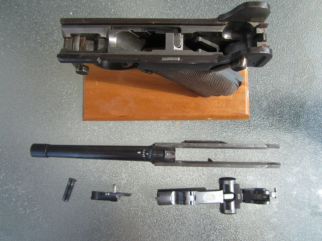

and are they interchangeable. Eric

Hi Eric,
There were different frame lengths in variations of Lugers. There has been discussion on the board about identifying those. Here is Ron's "Early Frame Tutorial".
Each Luger was hand fitted. That's why they are numbered. So that all the parts of a hand fitted Luger go back. For that reason, they are not strictly interchangeable. Close, but not precise - and that precision is needed for a correctly operating pistol.

Marc makes a good point; although switched luger parts may fit, they may not work without some fitting. The Navy & LPO8 models with have a few more parts than the standard PO8 due to their adjustable sights. The grip safety lugers will also have at least one additional part, the grip safety spring. Over the early years at DWM many parts were modified as improvements: elimination of the toggle lock assy, improved extractor, breech block and FP, improved trigger & ejector, relieved sear bar and FP and probably many changes to spring tention that are not readily appearant. TH

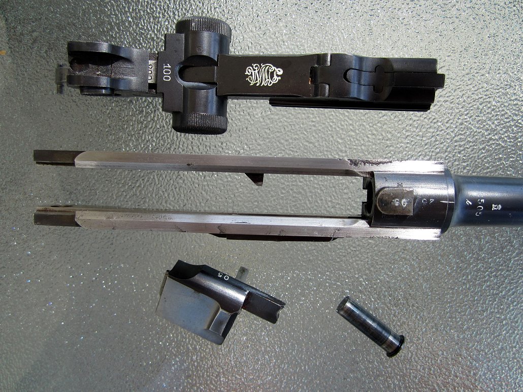

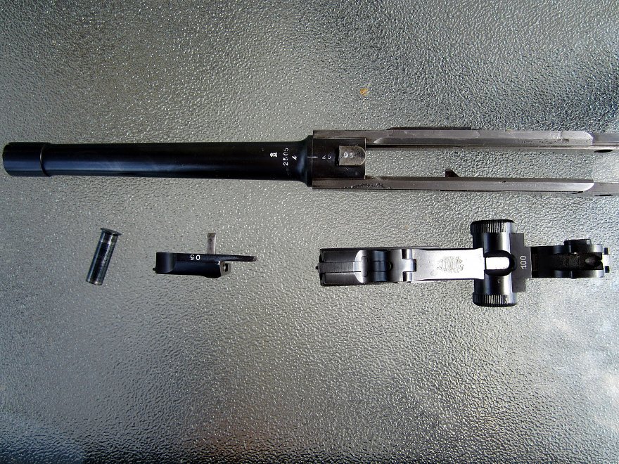

Year ago Ralph sold me a beautiful 1908Navy #2525b. Later he sold me a board that not only doesnt fit but appears to be non military. I have George at the show lookind for a replacement reattaching my sight. Thanks for for yout most valuable insight! Eric

How does one tell that it is non-military?
Unread 02-21-2012, 03:43 PM   #8
It generally have no marking or inspection stamps
