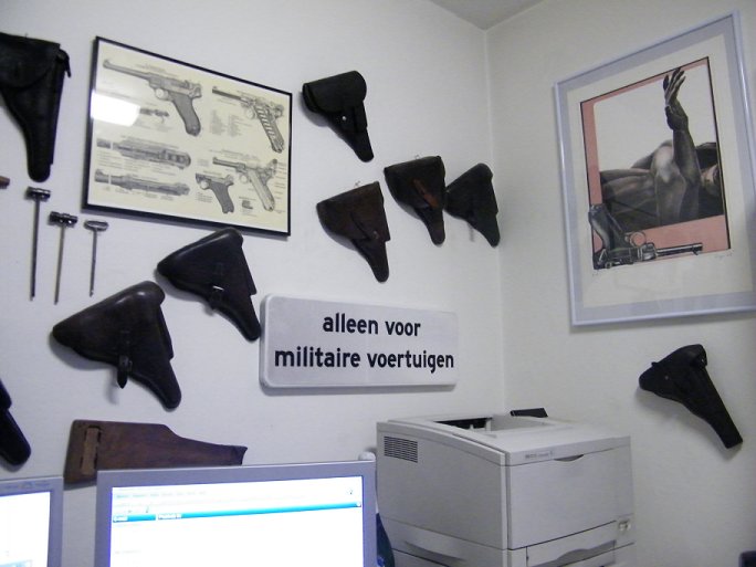

I hang them on the wall. Seems to work well, apart from the regular dusting required.
I make little 'holster hangers' by bending paper clips in a triangular shape. This can be hooked behind one of the holster's belt loops and hung on a nail in the wall.
We have pretty consistant room temperatures and a very stable, relatively low humidity level, so no other measures are needed.

Unread 05-15-2011, 03:38 PM   #14
As a matter of fact, the pin ups can be combined with the holsters quite well, as long as the subject matches a little.
(the 'pin up' is actually a signed and numbered original lithograph by German artist Peter Sorge)
