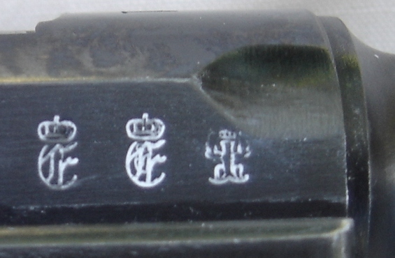

S/N: 5686e on frame under barrel. Suffix deciphered thanks to Ed Tinker's markings post, would never have guessed the character under the s/n was an "e". Have scoured this site and other sources but still can't find a match.
Markings:script DWM on toggle top. 1911 on barrel top. Frame r/s, (l>r) Script "E" maybe w/ crown on top. "D" maybe w/ crown on top. Eagle maybe w/ crown on top, wings and legs vertical, not angled. Lanyard boss on rear. Took bunch of pics but they're too crappy to post even if I knew how. Can anyone fill me in on anything about this piece? I consider it's condition to be very good even though it has 1" long minor pitting on l/s of barrel front. Toggle does not hold open. "86" stamped various other places. 8,84 stamped near S/N. Action is very crisp.

Hi Bob, You have what sounds like a 1911 DWM military Luger, the standard sidearm of the Imperial German army. In 1911 these guns were manufactured without a hold-open, although many were retrofitted during 1914. For opinions about condition we need to see pictures. Regards, Norm

Anything like this?

There was a first contract (order) about delivery of 50000 P08 between the German Government and the private gun maker (supplier) DWM. The contract was fulfilled end march 1911. Your P08 was one of the last of this contract or one of the first of the second contract.
If it came with a matched magazine you will see that it still has the large numbers but also the "e" suffix and the spare magazine got a point behind the numbers. That changed with about 9xxx e. At latest with the "f" suffix the small numbers were used and the spare magazine got a +.
The first acceptance mark left from the power proof stamp on the receiver is showing the small crowned "E" in the large crowned "E". We see/find that only on first issue Lugers.
Perhaps there is a unit mark on the grip panel.

Good eye Klaus. Piet's Luger is the first I have seen with the small letter/large letter overstamp that was not a first issue. I will have to look closer at other guns.

The left and right symbols are identical, but the center is different; looks like a backward"E" with "U" attached and vertical line down the center of the "U", crown on top.. Took some fairly good pics so now I must figure out how to put them up.

If it has not the hold open added it should be a Luger of the Bavarian or Württemberg army.

Klaus, es ist ein Deutscher-Sudwest Afrikaner Landespolizei Pistole.

Sorry--- I thought I would help with a photo because you said you have problems with it and it sounded by the description like the one I have. Did not want to steal your thunder! It will help if you could take a photo of the mark that you describe - the guys on the forum will tell you quickly what you want to know. Try a little chalk on the mark - it shows well on a photo and can be removed with a soft brush.
