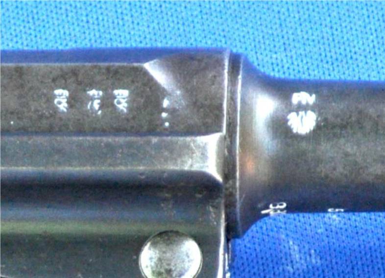

There are horizontal C/N commercial firing proof stamps on the left side of the receiver, the breechblock and the middle link of the toggle train. The right side of the receiver has C/S, C/E, C/S military acceptance stamps. This sequence is apparently unknown on Army commercials. According to Still, all others are reported to have C/X, C/X, C/X stamps. This is clearly an exception. There are a few reported 1913, 1914 and 1915 dated military P08s with the S, E, S sequence (http://luger.gunboards.com/showthread.php?t=8129). The presence of commercial instead of the Army firing proof stamps is also a rarity.

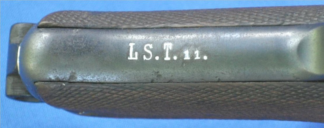

The front grip strap has the Prussian police marking LS.T.11., signifying P08 number 11 of the Landjägereischule at Trier. This is the only example of a marking from this school that I am aware of. The stamping has a halo.

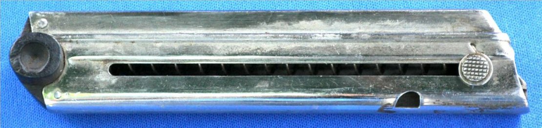

The magazine is a shiny (chromed?) tube with an unmarked wood base. The sides of the base are strangely and amateurishly dished. This probably was someone’s idea of a “proper” magazine for this gun. There is no way that an original wood base mag could have survived the 30+ years of the service life of this pistol.

I have some other thoughts about this gun. Can you dredge any more detail out of the right-receiver firing proof? Also, could we see the frame-front serial number?

We have houseguests so it will be a couple of days before I can take more photos. I may be showing my ignorance but I thought the three stamps on the right receiver were acceptance stamps and not a firing proof. They are all three rather lightly stamped and don't photograph well but they are definitely crowns over S, E and S.

You are corrrect that the SES are acceptance stamps. The firing proof on your gun is to the right of the SES and is all but obliterated. It should be a DWM proof but it is hard to tell in the photo and looks like it might be something else. Can you confirm what it is with your naked eyeball?

The white spots you see in the photo are stray bits of whiting material that I failed to clean off after whiting the acceptance stamps. With intense light and magnification I can say that there is nothing stamped forward of the SES acceptances. This is why I believe that the gun had already been commercially proofed and this was accepted by the Army after they had inspected the gun.

Here is a photo of the front frame serial number and another photo of the right side of the receiver minus the spurious spots. I have also included a photo of the bottom of the receiver showing how the last four digits of the serial number were stamped.

Thanks for the additonal pics. The apparent absence of an Imperial power-proof mark on the receiver leads me to an alternative theory of this gun's origin.

Conventional wisdom concerning these pistols has it that they were removed from the commercial production stream before power-proofing, inspected and accepted by someone out of the normal military acceptance stream (the anonymous c/X stamps), proofed in the army proofing facilitiy, and delivered to the Army.
On Commercial Army sn 71857, the c/S c/E c/S inspection stamps imply that the gun came from the military production stream in 1914 or early 1915. The absence of an Eagle proof indicates that the pistol was rejected for some reason before military power proofing.
The c/N commercial proofs and serial numbers suggest that the entire pistol was then diverted to the commercial production stream, where it was proofed and then marketed.
It is difficult to know when the parts were serial-numbered. The bottom of the receiver and recoil lug are numbered in the commercial manner; the takedown lever and sideplate are numbered in both military and commercial fashion. It would be useful to know if the center toggle is numbered underneath. It would also be useful to examine the top of the chamber very closely for any evidence that a date has been removed.
The official Army inspection and marking instructions specify that parts are to be serial-numbered after completion, but before power-proofing and final acceptance. That the pistol has all three acceptance stamps, but no proof mark, is anomalous. It is suspected that the inspection instructions applied specifically to the Erfurt factory, bolstered by the demonstrable fact that DWM P08 are not marked in accordance with these instructions. It is not possible to conclude whether or not the pistol fell out of the military production stream before or after it was serial-numbered.
