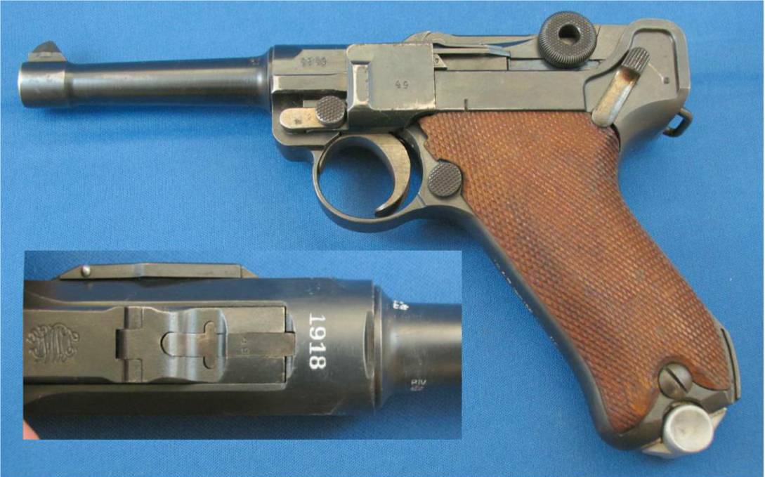

I recently acquired a P08 that exemplifies many of the characteristics of these reworked and reissued LP08s. I present it here in hopes this will help to identify more of these pistols.
The pistol is a 1918-dated DWM, serial number 4849a, with Imperial-era acceptance stamps on the right side of the receiver and typical military-style numbering of parts. All small parts have matching serial numbers, including the rear toggle axle and the firing pin which does not have â??blow-byâ? channels. There is a notch at the front of the receiver for an LP08 tangent sight. It has a Schiwy sear safety and is notched and drilled for a Walther magazine safety that has been removed.

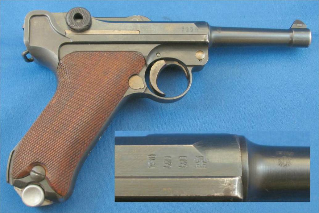

The replacement barrel bears a PTV/E proof stamp as well as E/33 and E/45 acceptance stamps which I understand are associated with products manufactured by Simson & Sohn in Suhl. The barrel also has the numeral 4 stamped on the bottom as well as the bore gauge 883. (Oddly, there is no comma in this number.) I believe the 4 indicates the year of manufacture of the barrel by Simson (i.e., 1924) but this is speculation.

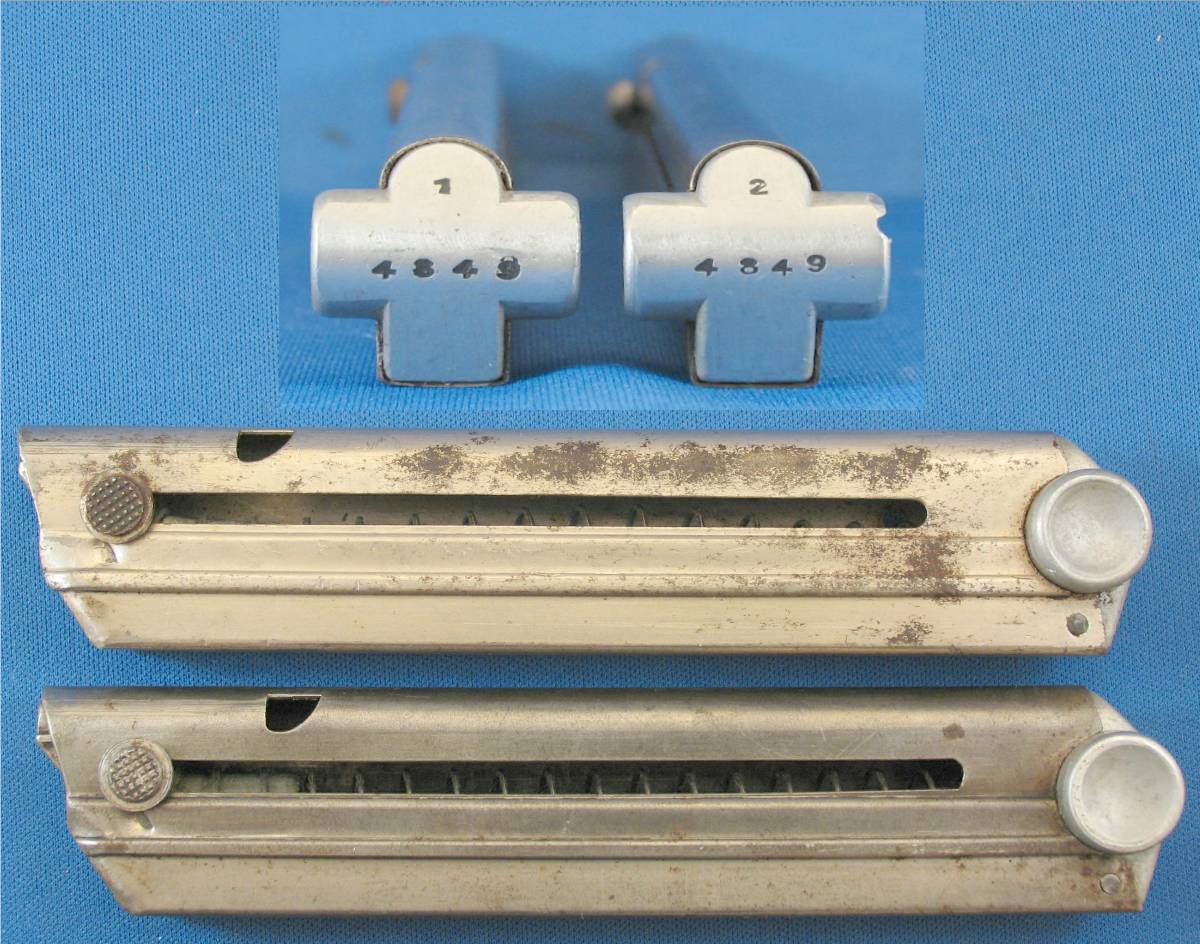

There are two matching aluminum-base magazines numbered 1 and 2. Both magazines have had earlier markings very professionally ground off and appear to have been stamped with the same dies. These probably were replacement magazines issued when the reworked pistol was issued.
