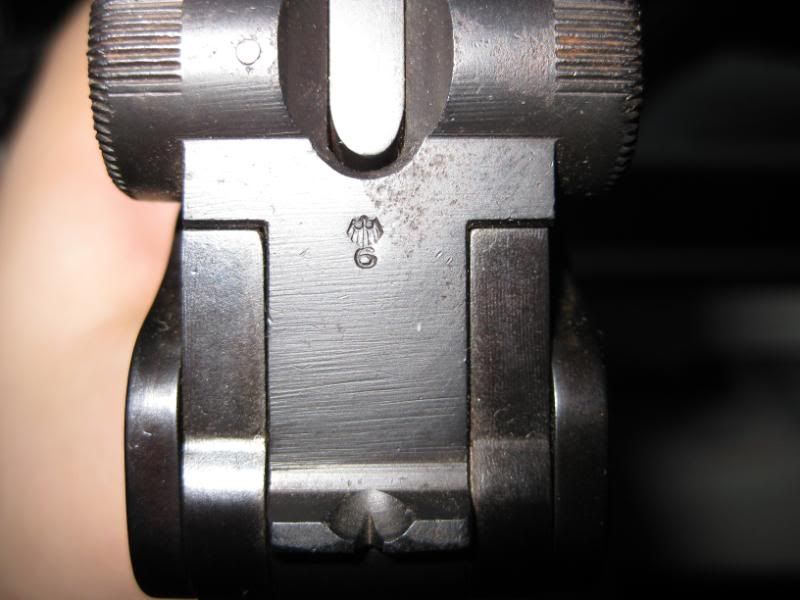

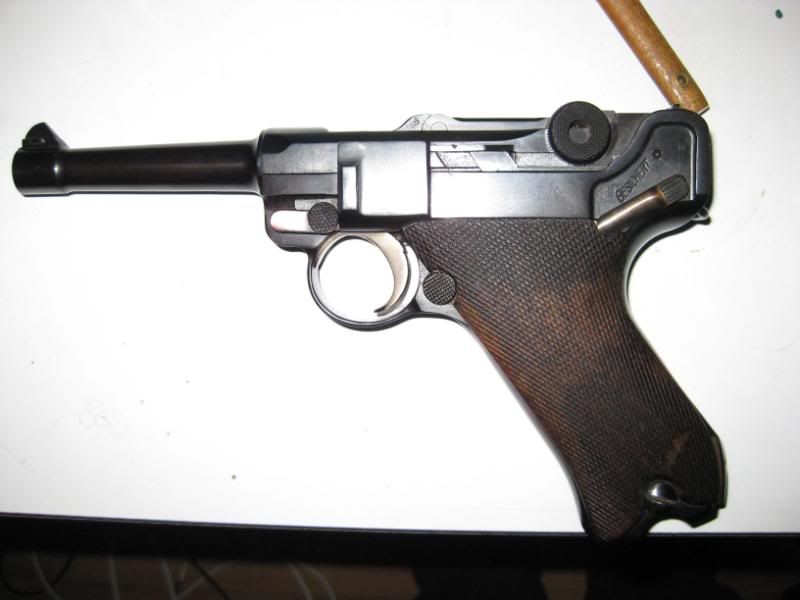

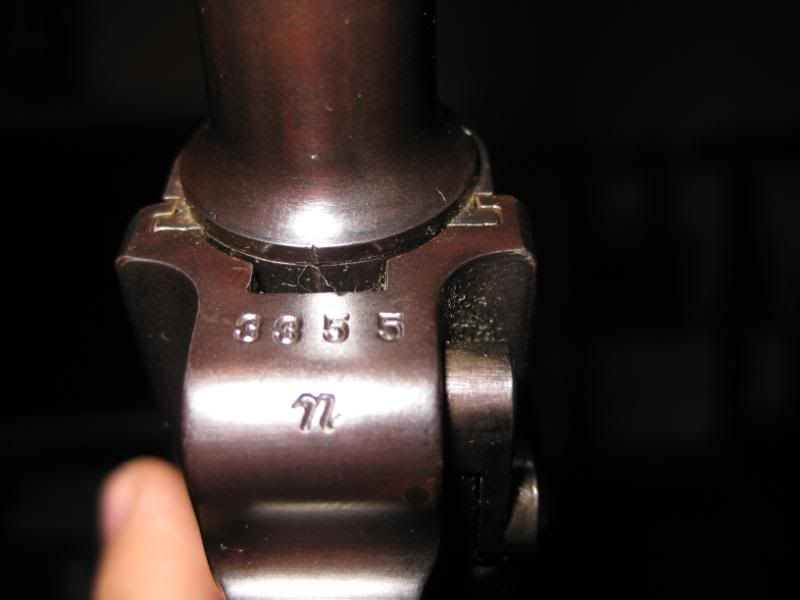

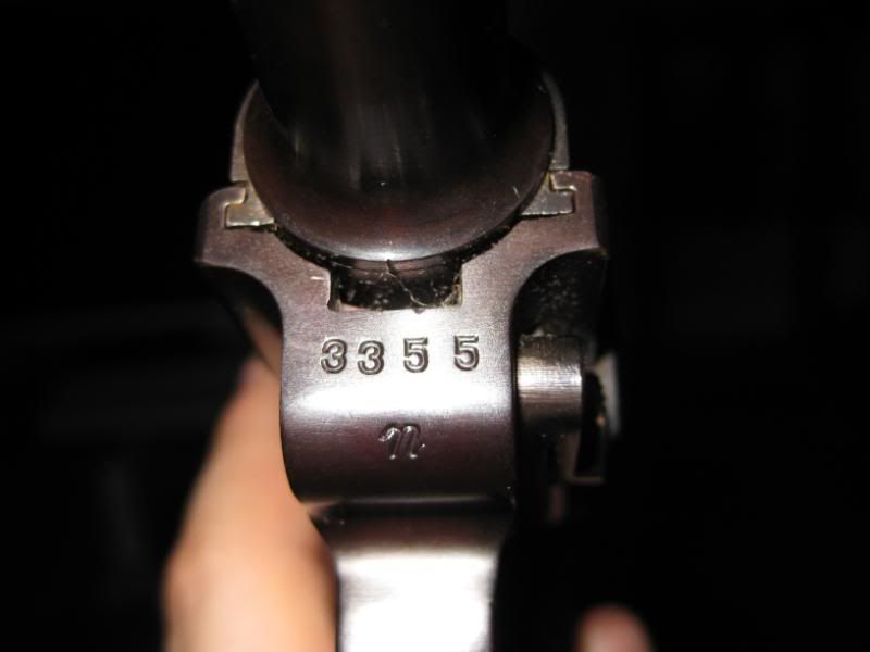

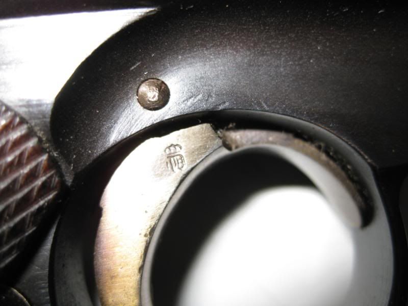

First of all, greetings to all you Luger enthusiasts.
I recently came into possession of my grandfather's P08 and was looking around the internet for more information about it when I found this forum.
My (very) limited knowledge leads me to believe it's a pre-1910 commercial 9mm DWM-made gun, but I'm kind of lost in all the markings and wealth of information available on the internet.
I have a few pictures that might help you help me.
Thanks.
Kystos is offline   Reply With Quote
Unread 06-10-2009, 08:45 PM   #2
Wow...that's the best looking serial number this year...
But I expect that Ed will have some words about the pics...
Unread 06-10-2009, 09:04 PM   #3

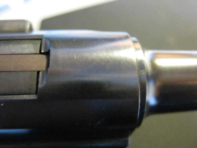

Sorry, a 1910 would not have a stock lug.
I expect it to be either a WW1 that has been redone by Simson (thus the eagle 6) or a Alphabet Luger made around 1926 or so and then redone by Simson...

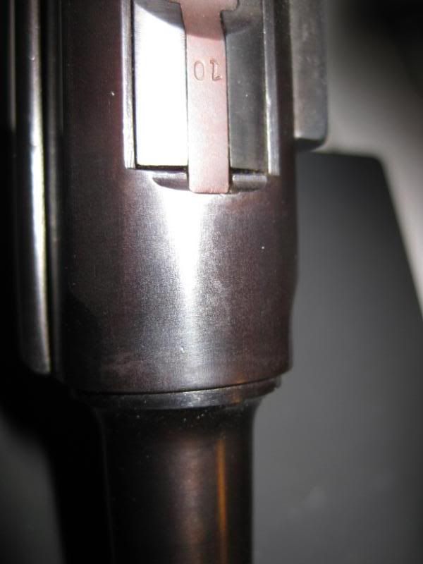

A picture of the top, showing the date or lack of a date would help

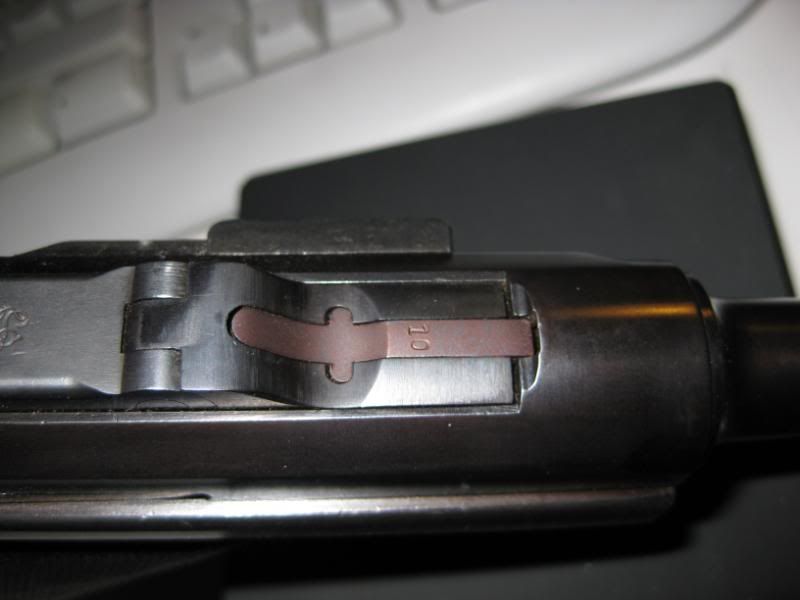

Unread 06-11-2009, 05:41 AM   #4
Kystos
Join Date: Jun 2009
Posts: 3

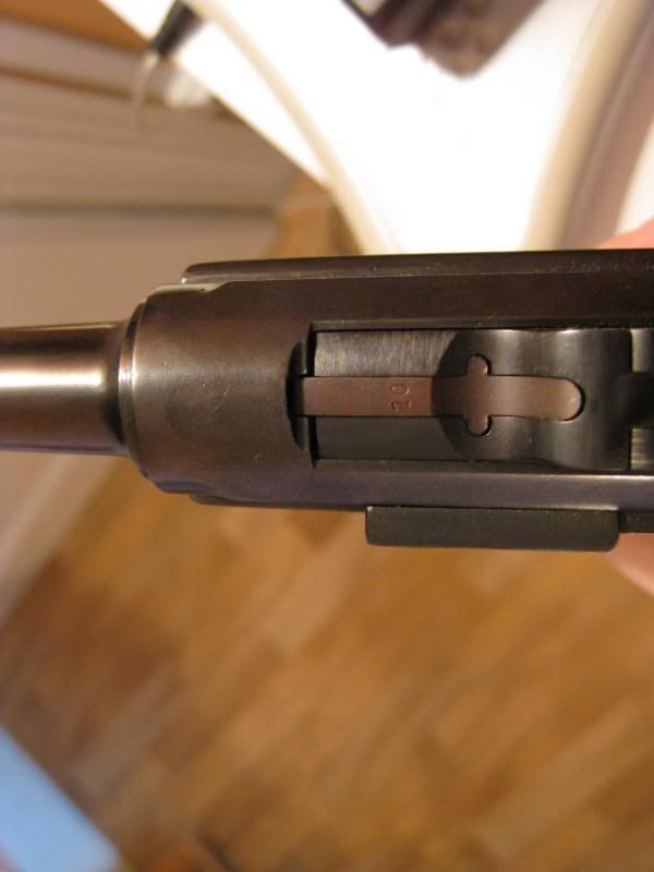

That's the thing, there's no date at the top. That's what lead me to think it was pre-1910. But as I said, I'm new to it all.
Here's the top.

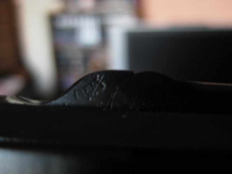

Unread 06-11-2009, 09:16 AM   #5

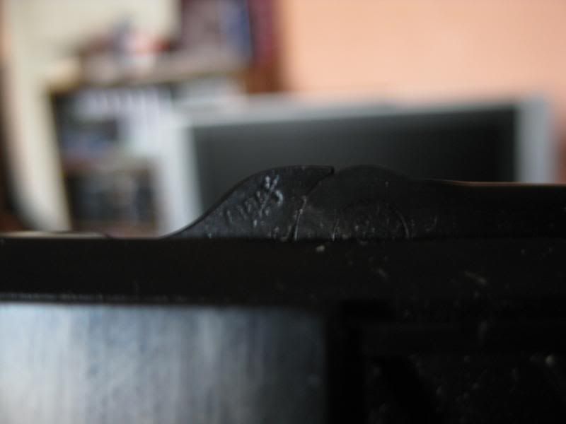

How's about some more pictures of where the date is supposed to be.
I'm thinking it has been removed.
DJU

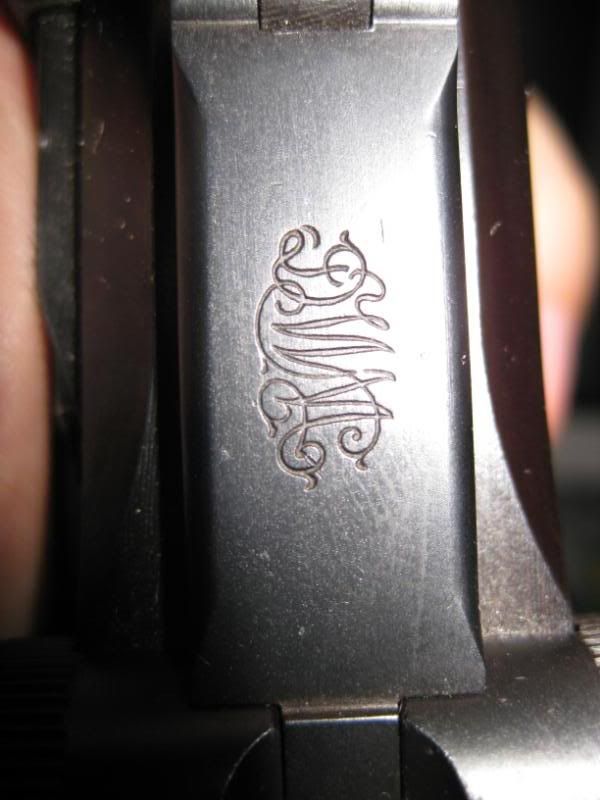

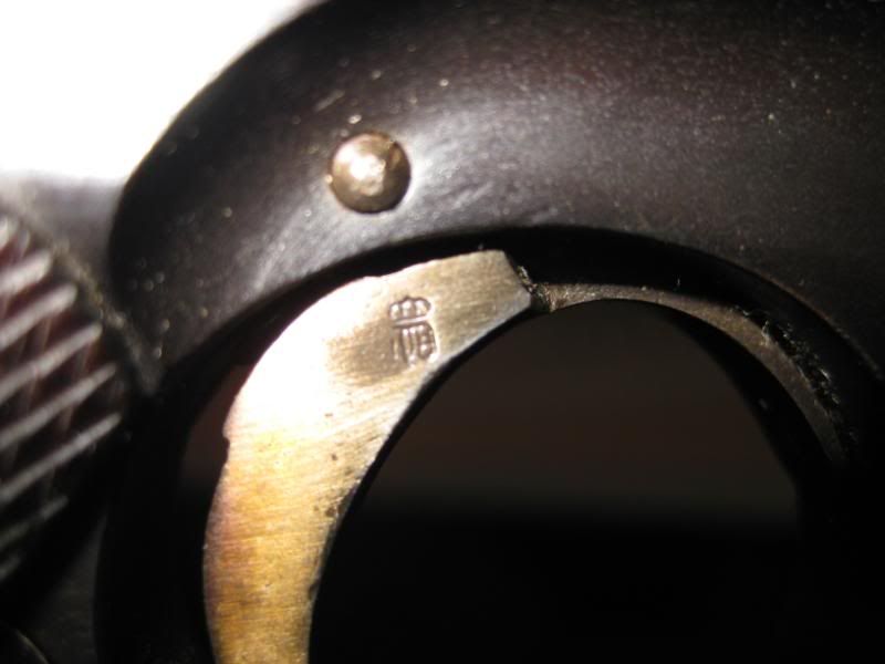

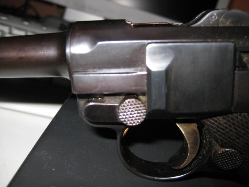

Unread 06-11-2009, 10:21 AM   #6

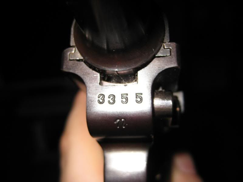

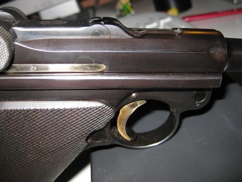

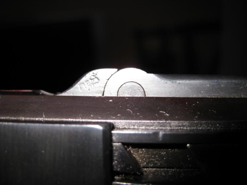

Kystos, Judging from the toggle assy (double c/U pre 1940 Mauser commerical or contract breech block with "purpleish" extractor, typical of 1938 or 39 finish, Commerical DWM mid link (should be numbered inside), and Simson proofed rear link, and the serials on the frame appear to be Mauser dies); you probably have a "Heinz 57" mismatched shooter. If the rest of your luger matches, other than the toggle assy, it's possible that the correct Mauser Banner toggle might match it up. A close up photo of the marks on top, right & left side of the receiver would be helpful. TH

Posts: 3

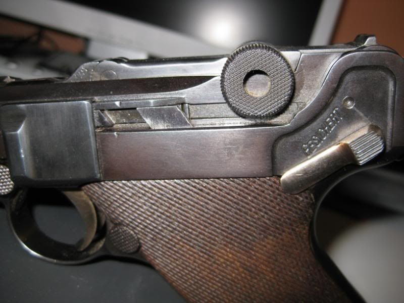

So, what you're saying is it's quite possible it was pieced together using parts taken from other guns?
That's would explain why I've been so perplexed by the different markings. (Well, that and inexperience, obviously).
I'll try to get more pictures soon, but my camera's a bit cheap, I'm not sure if it'll help at all...
More pictures:
