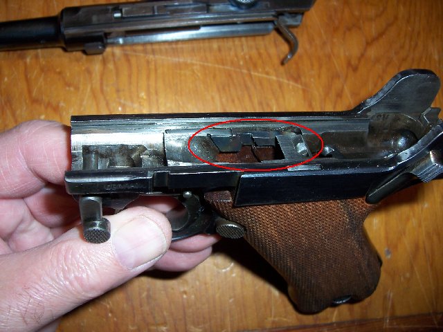

I'd try pushing down on the part shown in the first pic...while holding back on the toggle...(it will bite you)...

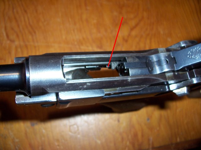

Second pic shows the holdopen in released position...
