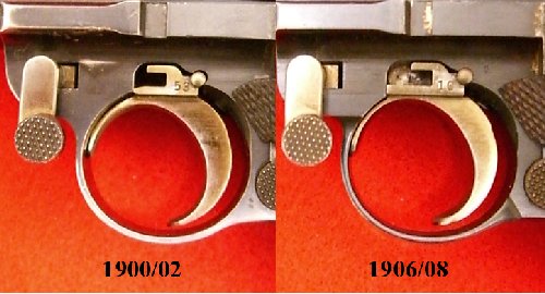

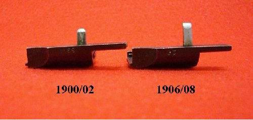

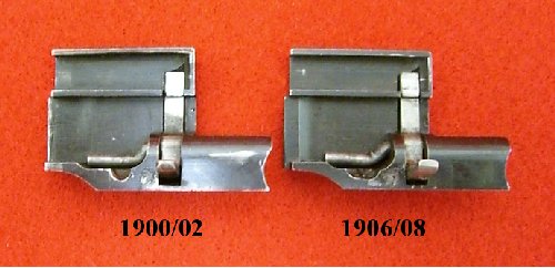

It is a 1900 sideplate. The 1900 has a different trigger and sideplate transfer lever than later models. The lower extension and slot in the trigger is shorter, and the lower arm of the lever is shorter on a 1900. Therefore, unless something is very worn you can't assemble a later sideplate onto a 1900.

If I read your response correctly, you are stating that the trigger lever is different, not the actual sideplate. The side plate on a P08 seems to be identical to an M1900 side plate. Would a P08 sideplate with an M1900 trigger lever work? KFS

You are correct. There are minor internal machining differences between the 1900/02 and the 1906/08 sideplates, but the earlier lever could be installed in the later plate and it would work.
