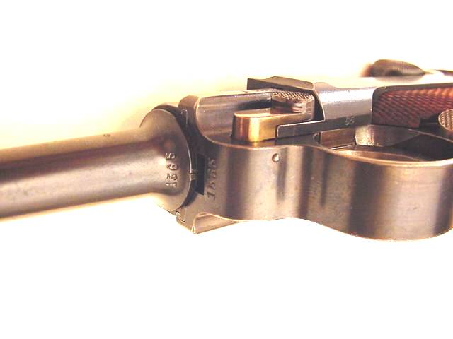

Here is another M1900 Swiss Ordnance Luger # 1365...for sale on Andrew Zink's web site.
It appears factory finish and has an un-numbered TD lever and the 2-digits on the trigger side plate are rightside-up :
Unread 05-02-2007, 03:38 PM   #4
Armin
Location: Germany
Posts: 35
Thanked 11 Times in 6 Posts
Hi Pete,
the TD lever's number could be on the other side.
Regards Armin.

Unread 05-02-2007, 05:04 PM   #5
Armin
Location: Germany
Posts: 35
Hi Pete,
it's me again. I had a look on the cited web site. I am not really convinced that this Luger Mod.1900 is factory original. At least the extractor seems to be a Bern replacement (with an interesting colour). Unfortunately the rear sight cannot be seen. I guess it is U-shaped.
The TD lever has the normal configuration. The direction of the number on the sideplate is speculation, at least for my eyes.
Regards, Armin.

Unread 05-02-2007, 06:08 PM   #6
Here is the link to Andrew's web site if others want to look at the photos.
This M1900 is offered for sale in the "Vintage Pistols" section :
http://www.augustus.ch/

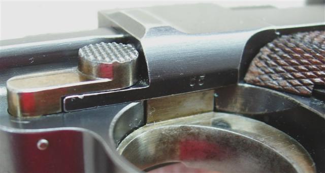

Here are a couple of photos of my # 555 M1900 Swiss Ordnance Luger.
TD lever not numbered and side plate numbers are right-side up :
Unread 05-02-2007, 08:06 PM   #8
Thanks: 1,123
After Armin posted "the TD lever's number could be on the other side" I dope-slapped myself and edited my post on the 3-digit 1900 to reflect the TD # on the right-side round. That is one of the more bone head moments I have had (had lots of others but not quite that bad).
Unread 05-02-2007, 11:59 PM   #9
Me too...what Ron said...other side of TD lever shaft numbered.
