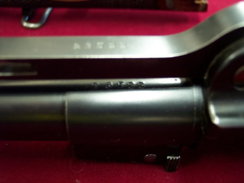

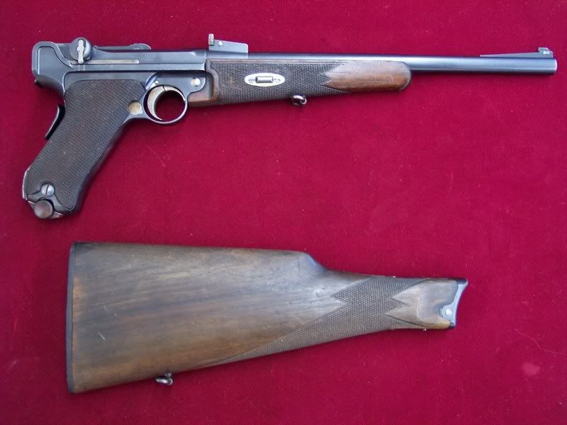

Can someone help me with some info about this Luger........
It is in .30 Luger
Like Date of Manufacture..... Value.....
Here are some pics.....
Sorry for some of the pics.

Welcome Craig. Interesting first posting, as a carbine is high on many folks "want lists".
if all original, a good chunck of money, if reblued, half that... (I'd give a value, but don't know these puppies)...
It is considered a "1902" model and not a common sight...

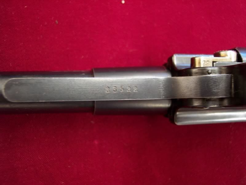

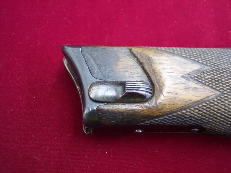

Craig,
A nice additon to anyone's collection, thanks very much for the look. By serial number it is in the range of a series of 1902 Carbines assembled most likely in 1905. Could you tell us if the stock is matching?

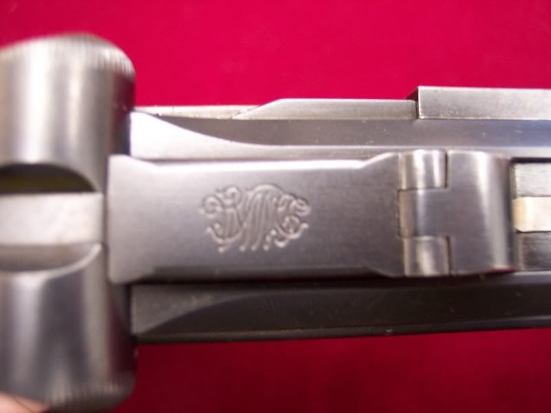

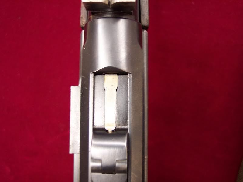

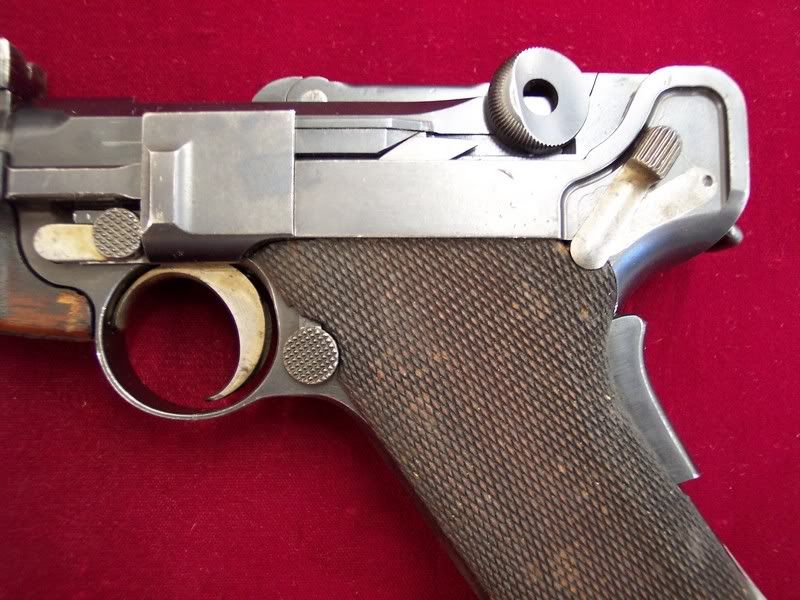

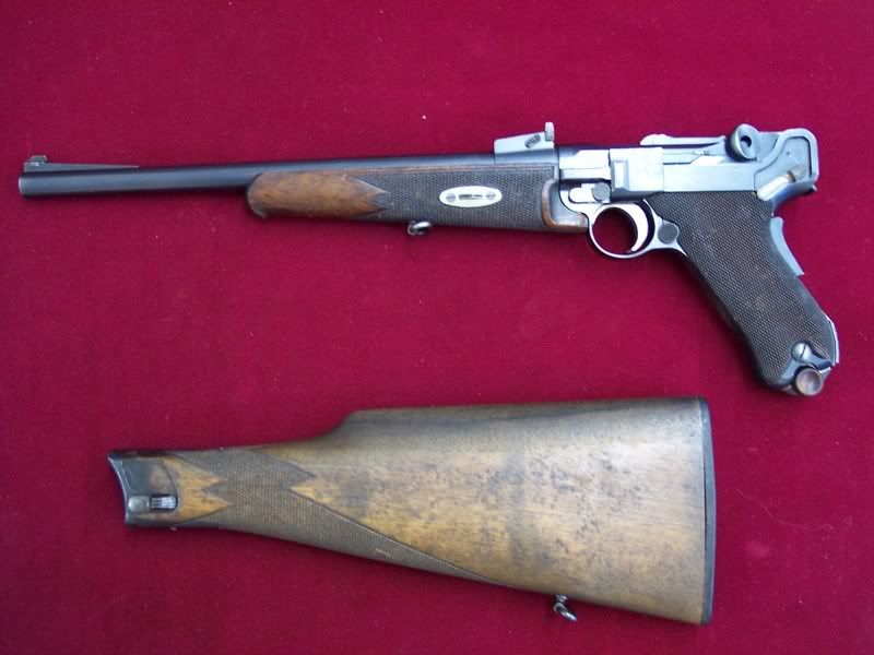

Yes stock has 522 stamped on the top. Is it comon to have the safety area a straw (unfinished) color under the lever? (Pic 3)

Craig,
Thanks for the info.
Yes, the area under the lower position of the safety lever was "polished bright" to indicate that the gun is on safe. The area is actually very shallowly milled, if you find a sharp edge with no polishing outside of it, or bluing inside, and 100 years discoloration of the white surface, it is a primary indicator that the gun has likely not been reblued.

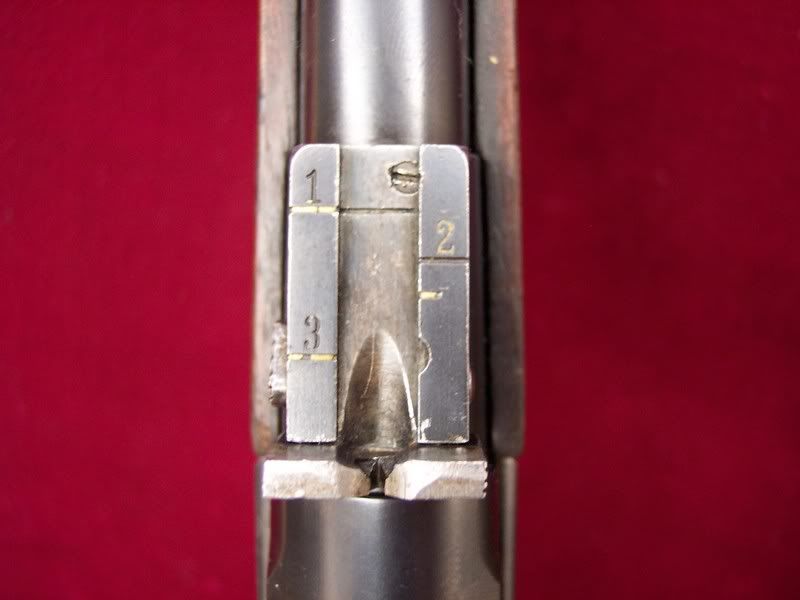

Craig:
Nice Piece! I believe your rear sight leaf is modified or replacement.
Regards Ken D
