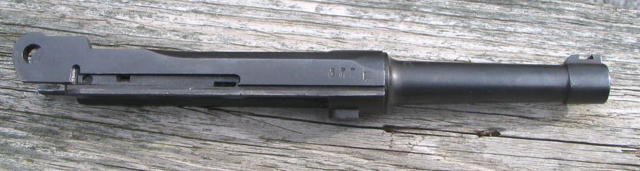

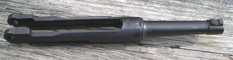

Since the pistol is a "parts gun" I would suggest that the easiest and perhaps cheapest path for you will be to find another barrel with receiver(barrel extension) attached. They can be had for a rather modest price.
Following this course you would be able to quickly switch between a four inch shooter or a sixteen inch shooter to which you could attach a repro stock.

GS, I have new 4,6 or 8 inch 9mm luger barrels in stock and the proper tools & experience in changing them. But as was stated above, this can be more expensive than purchasing a spare used barrelled receiver ($200 to $250) for your pistol. Even then, it may have to be fitted to your frame and should be head spaced by a knowledgeable gunsmith and a proper 9mm recoil spring installed. TH

I have this assembly if you would be interested pm me. clint
