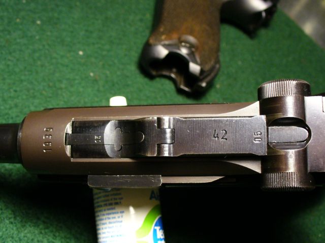

Here is my 1939/42

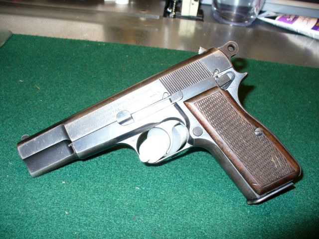

1943 Browning P35

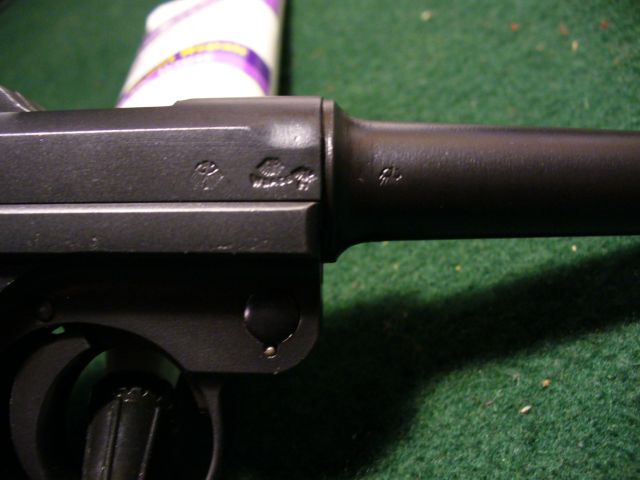

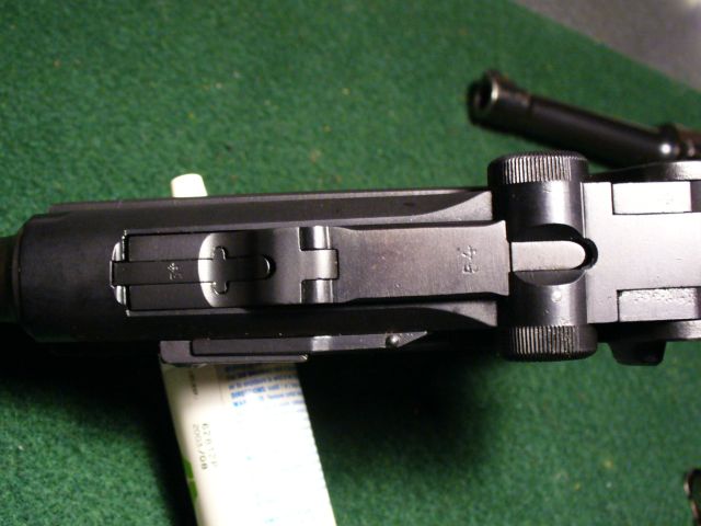

Pat the proofs look like #36, 37 and 38 from page 41 of Lugers at Random for the Mauser reworks.

Two of the acceptances look like E/WaA66 and E/H. These both are very consistent with the other Lugers manufactured by BKIW in 1929 and delivered to the Landj�¤gerei. I am not expert in this area but I don't see anything indicating rework by Mauser.

Don that is correct on the markings but Lugers at Random states E/H for Mauser reworks and E/waA66 for Mauser and Simson reworks for 1930-1933 which would be in line with Pat's 1930 date. Is the book incorrect?
