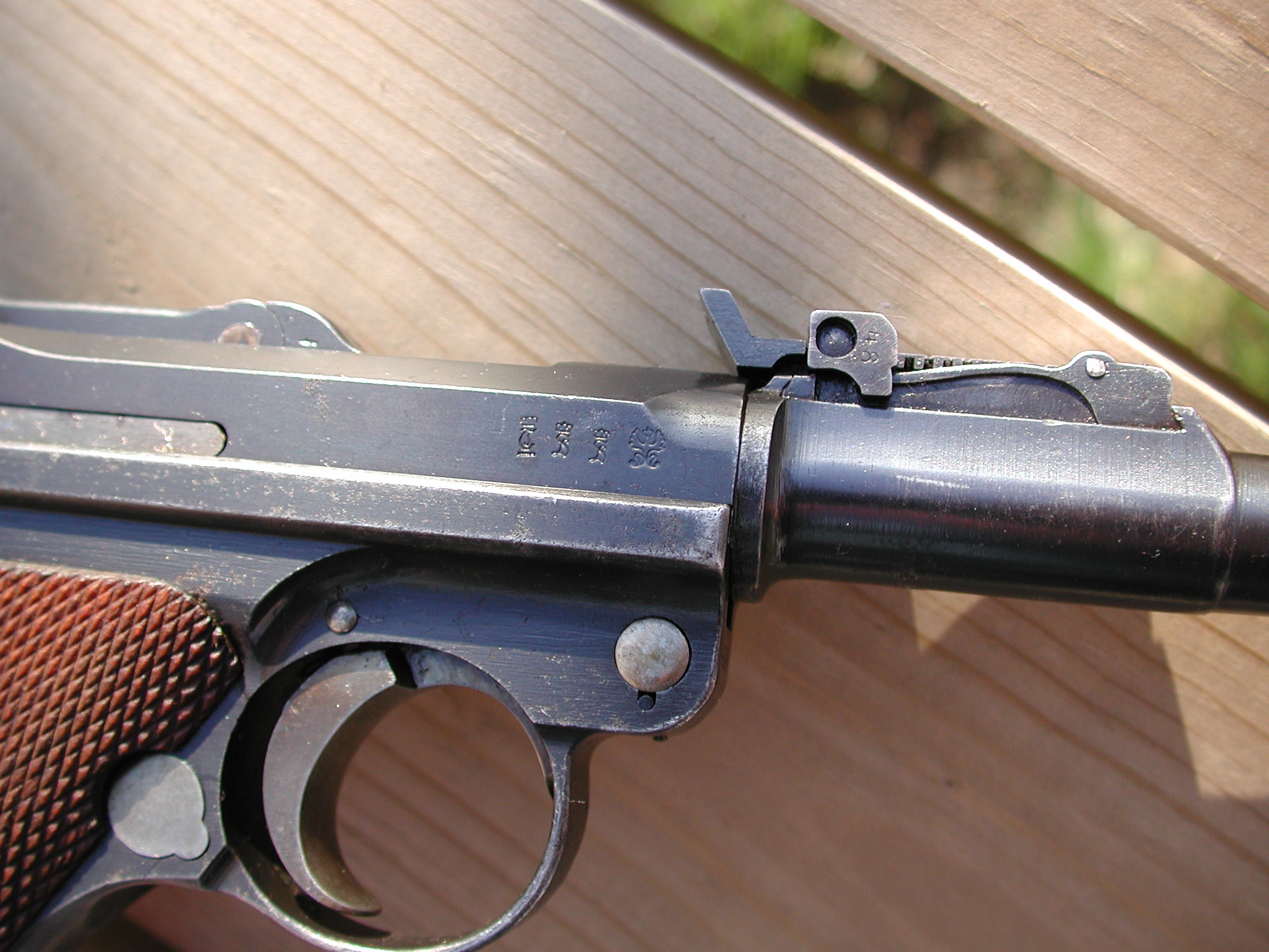

Photo showing rear sight cut in receiver and left side of barrel:

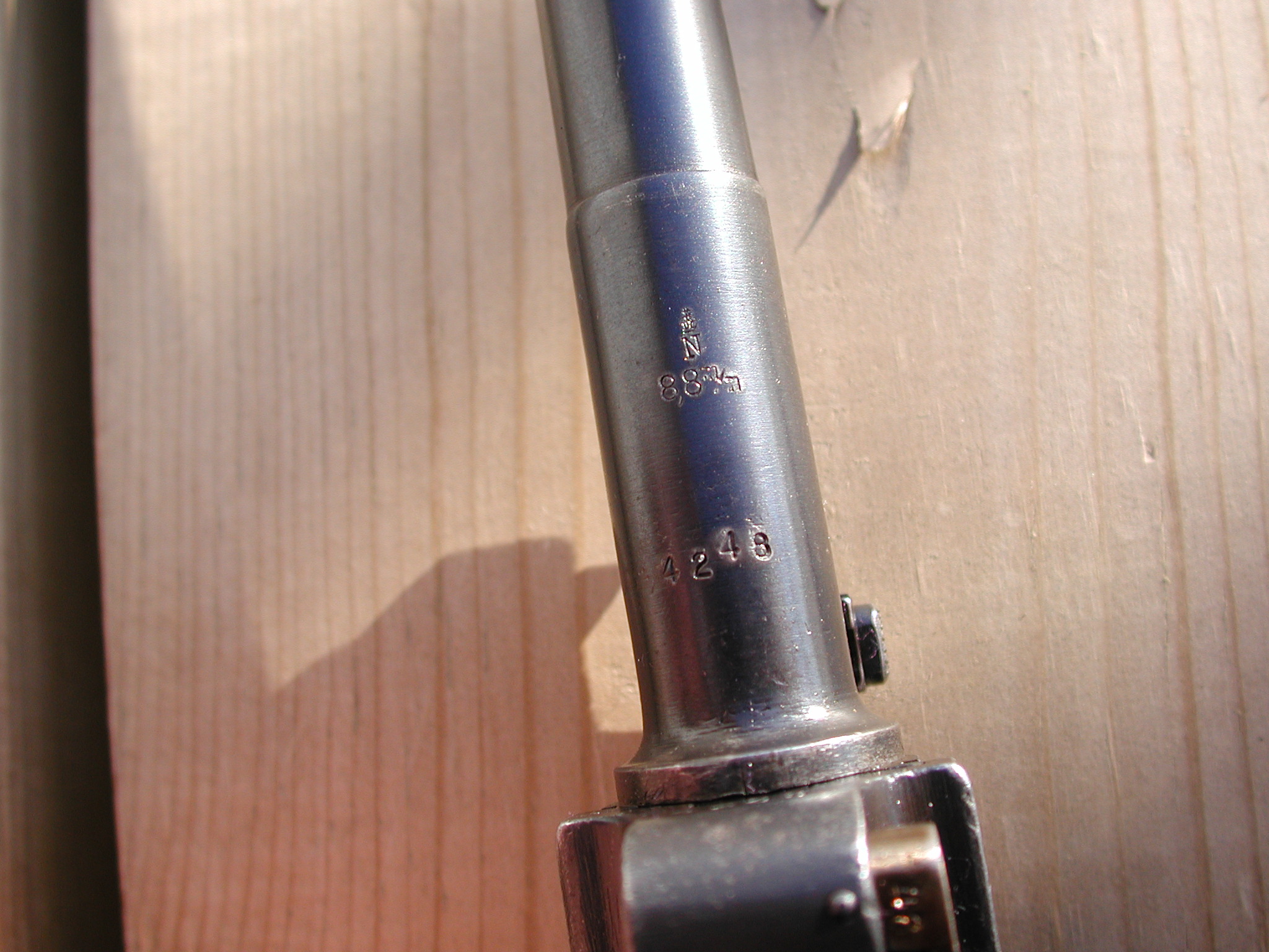

Photo showing barrel markings on bottom:

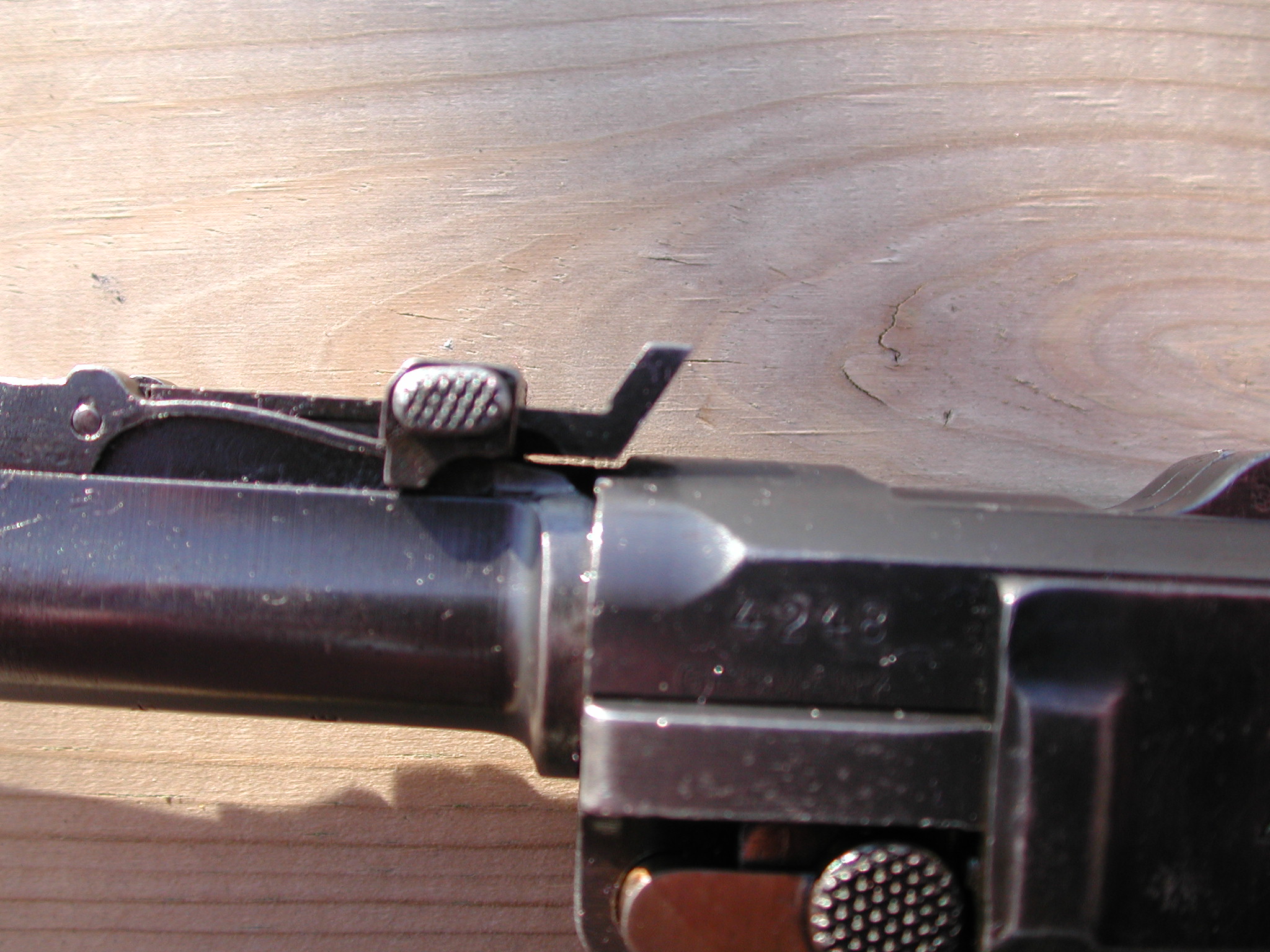

Right side of the receiver, receiver markings, and right side of barrel:

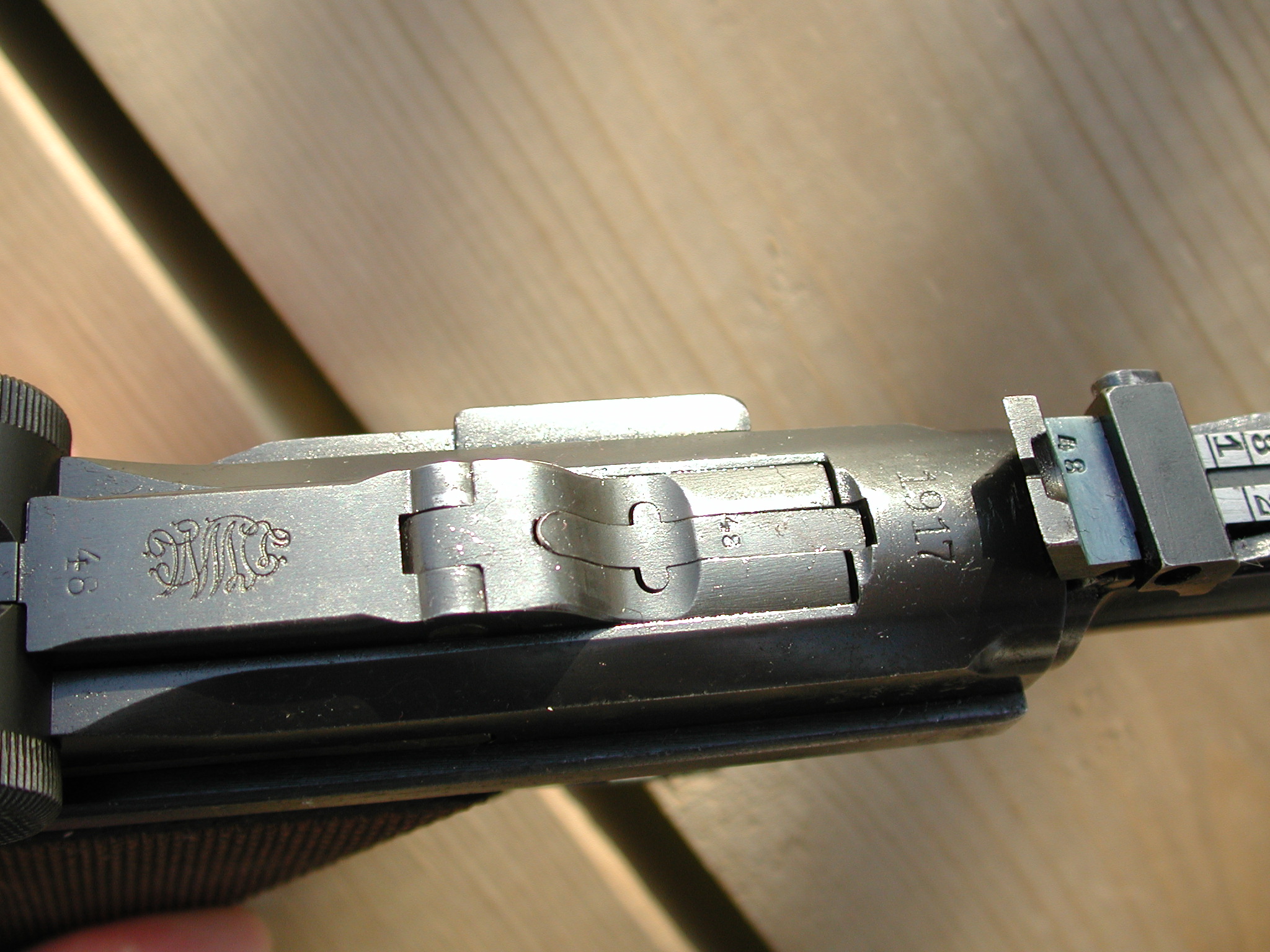

Top of the piece, showing date and all that:
Sorry for all the rigamarole, it's been a long day. Hopefully the photos help!

Well, isn't that funny. I couldn't make it out for the life of me staring at it, but looking at the photo, that's "m/m", plain as day. Don't I feel like a dork

Unfortunatly it's out of focus, but if you look at the super-huge image version of photo 1, directly under the serial number, you can see the "GERMANY" stamp.

Very good and useful pictures. The lack of an Imperial firing proof on the barrel, and the c/N commercial proof, is good evidence that the barrel was replaced. Interesting, in that proofing and complete barrel marking--proof and caliber measurement-- is not usual for rebarrelled export guns, all the more in that the gun was German commercial proofed in a country in which 9mm caliber and barrels over 3 3/4inches were not permitted by the IMKK regulations from the Treaty of Versailles. The m/m mark is not the customary caliber designation notation.
The right receiver marks are completely as would be expected for an Imperial military DWM Luger fom the middle of 1912 through 1918.
If I had this gun in my hands, I would be looking very closely to see if there is any evidence that the receiver notch was added during rework (also not an expected rework feature), and if there is any evidence that the rear toggle link was modified or replaced.
This is a very cool Luger, which provides the kind of tests of observation and logic which I find really attractive.

p.s. The style of the numbers used on the serial number on your barrel doesot appear to be the style used at the factory at DWM.
Unread 04-25-2006, 11:40 PM   #16
Dwight, good catch on the m/m caliber notation stamp. I have never seen one that did not include 3 digits... (.g. 8,81)
The tolerance range for the barrel is 8,81 to 8,85 according to the 1913 blueprints...

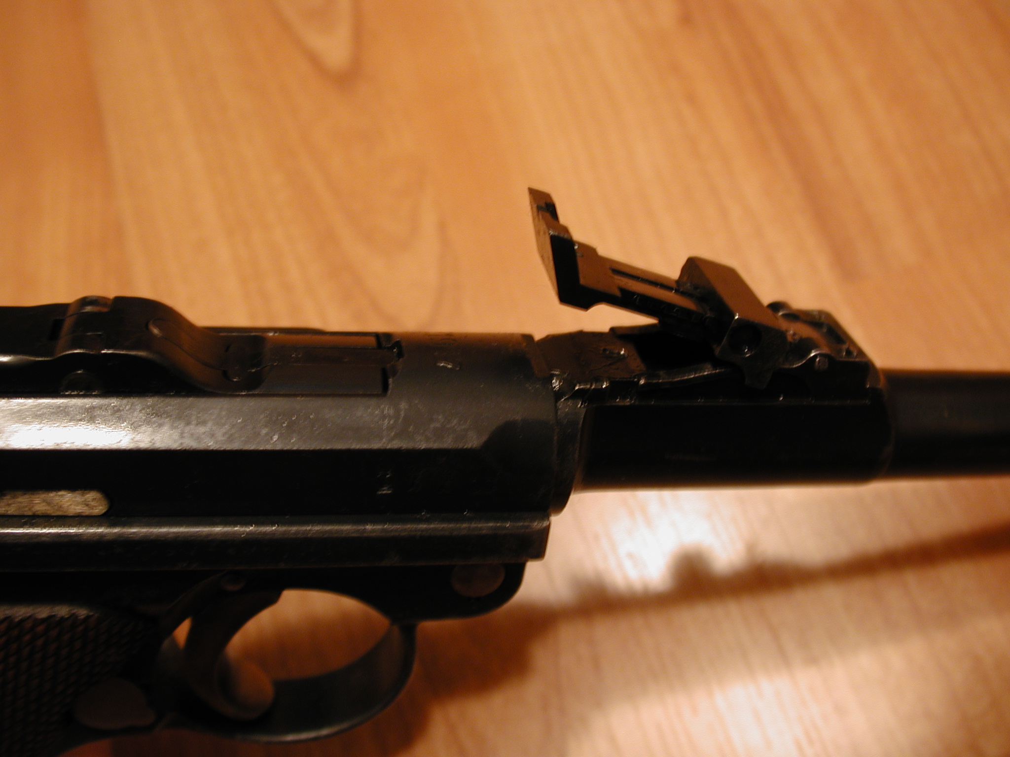

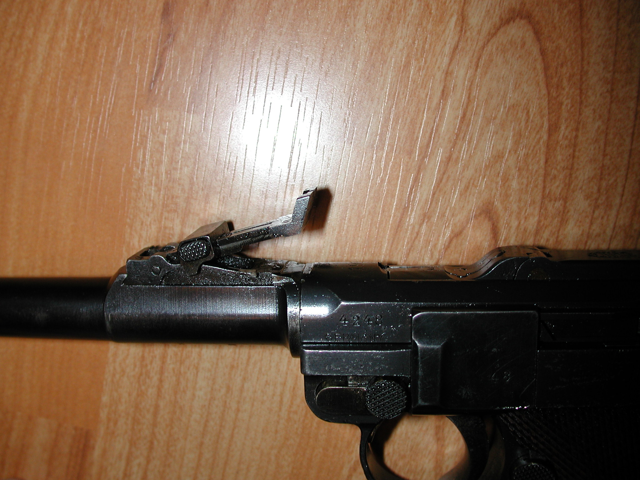

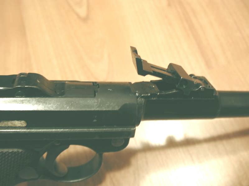

Actually, sort of...here's a couple photos, sorry if they aren't as detailed as they should be..lighting here isn't the best.
Again, click on the photo for a very large version of it:

An original LP-08 rear toggle would not have the integral v-notch rear sight as part of its machining.
Some made-up Artillery's are floating around the USA marketplace that have had a LP-08 barrel and elevated sight added to a regular P-08 4" luger but have had their original rear toggle with the v-notch rear sight left in place. Others have had this v-notch rear sight machined away.
Photos of the top of your rear toggle would be useful. I suspect that is what Dwight is trying to determine for you.
BTW...your photos are a bit dark, but it appears to show a milled receiver cut that could indicate your gun's receiver was originally a DWM LP-08 receiver.

I'll try and get some better photos tonight, including grips, the straw, and the full piece as well. Amazingly of all the photos I've taken, not one was of the whole thing at once.
Sorry for the darkness of the photos, it was night outside You should be able to load them in Microsoft Paint or Photo Editor or some other image-editing software and punch up the gamma..that should lighten it up for you, and make it easier to discern things.
