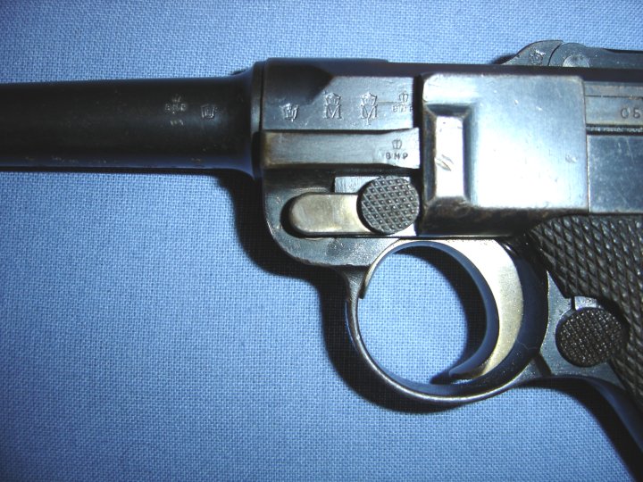

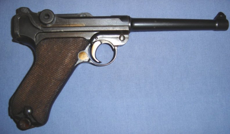

Okay, no Imperial Luger books at the house, so tell me what I have here if someone could

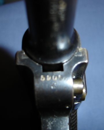

It went to england at one time, and is marked with their "normal" proofs on the left and under the barrel. Sorry those pics turned out so poor.
Its not as pretty as any of Tom's, but it is a real navy with a navy marking on the mag. so, when did they make mags like this??

maybe not as good as one of Toms and maybe it has British proof marks, but I think its beautiful. The locking bolt looks like it hasn't been messed with. (You know that is one of those things that I look at first) The only thing that I wonder about is the little finger of the side plate has what looks like it has a crown with maybe "9 mp" stamped on it. I have to look at one of my navies to see if that marking is there. I don't remember, right off hand, seeing that on my navies.

Ed, I just saw the same British mark on your receiver just above the same mark on the side plates finger. It must be part of the British marking routine. The grips look pretty good. Are they numbered to the gun? Nice buy. Big Norm

Hey Big Norm, I asumed mp was a brit stamp??

Nice looking Navy Ed! Would you believe "BNP"? The Crown/BNP is the "British Nitro Proof" and its use dates from the early 1950s.

I think the gun came over :
1. Either as a Brit bring back just after WWII and was inspected/proofed based on English gun proofing laws.
2. Gun came over to England later in the 1950's or later and was proofed according to proofing laws in effect at the time of importation. As Ron Wood metnioned, probably the case with this Navy...
Based on the type of British proofs applied, I think a luger with early proofs and its ties to a British bring-back vet would be more interesting to own than a later British importation piece...IMHO.

The *most likely* explanation for the Brit proofs is that the piece was once owned by Sam Cummings' company, Interarms. Sam had massive warehouses of weapons stored in England and in Monaco. The Brits required the proofing as a condition of entry and storage into the UK.

Hey Pete, go easy on our buddy. I don't know what he paid for this beauty, but except for a ding on the side plate and maybe some pitting on the front of the trigger guard, he has a nice navy here. All the original markings look pretty crisp and nowadays just having a navy Luger is an accomplishment. Someday, having British markings on an otherwise nice but rare navy Luger won't matter that much.
Ed, what about the grips? Are they numbered to the gun? Whats the bore like? Contrary to what you emailed to me, the gun is definately not ugly. There are a lot of guys out there who would love to have it. Now you have to get a navy holster and a navy stock. Maybe a WW1 German navy hat to wear to the range when you shoot your prize. Maybe a little WW1 German style curl on your mustache. Yah! That'll do it! A mustache with curls at the tips is that finishing touch. Anyway, nice going.
