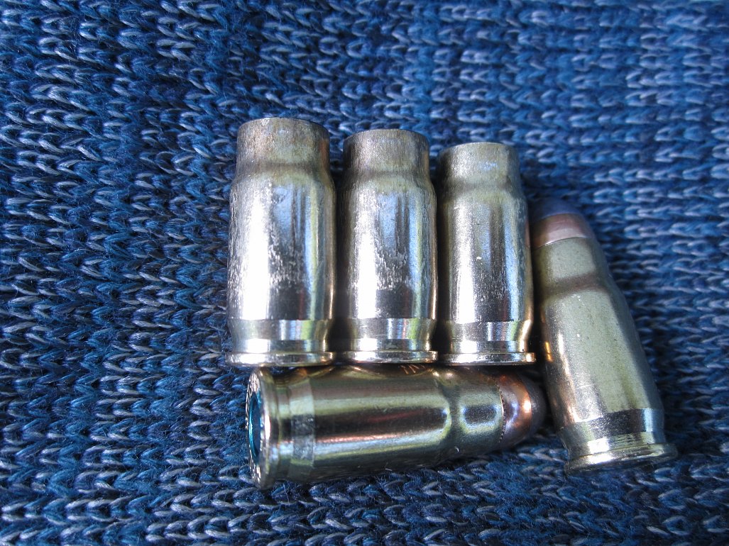

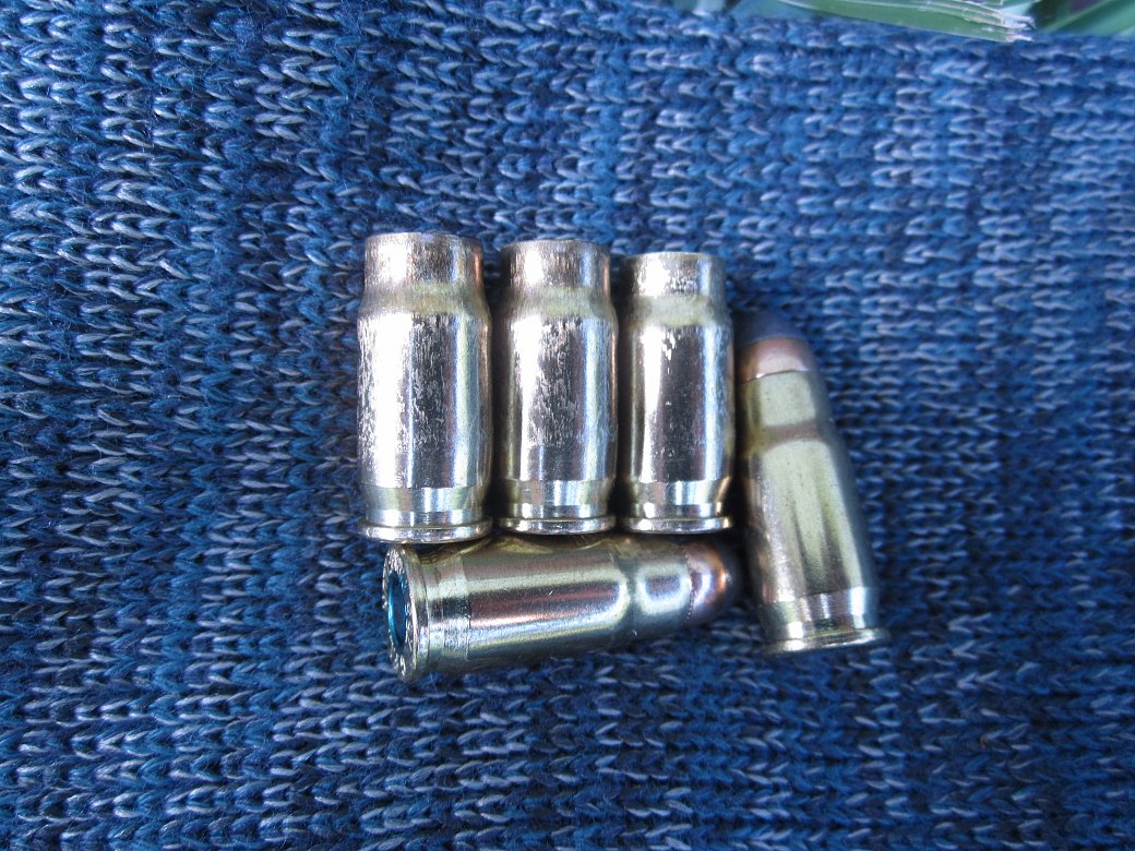

Good morning Ron. The pictures did not do justice on the pitting in the chamber. There are 2 or 3 good size pits on the topside of the chamber. Id have to still <1/16" deep, but very noticable. There are marks on the spent shells (see pics).
If I do need to redo the bore. When you say reline the inside, what is involved with that and would it be real noticable.
As for changing out the barrel, would that involve having to re blue the gun.
I am going to run some of the 600 grit sandpaper around the inside one more time, easily, not to make the bore out of round, and see what happens then.
Then maybe you can help me determine someone to do one of the other. changing the barrel is the last thing I wanna do if I have to re blue the gun.
Thanks Ron for your input.

The extractor is the proper type for a M1900. It is a spring itself, so there is no additional spring under it. It used to be very difficult to find replacements for them, but now some good quality reproductions are being produced. I doubt your extractor needs replaced (at least until it breaks, which hopefully won't happen ).
From your photos, it looks like your extraction problems may stem from the chamber. It looks pretty nasty with lots of pitting. A gunsmith may be able to polish it up a bit, but if that doesn't work, I would think the only alternatives would be a barrel reline or another replacement.
Thanks but I'm almost certain it's not an extractor issue.
Even with a weapon tool (Car key lol) it's difficult to pry the spent casing out of the chamber.
Any extractor would have issues removing the shell with that friction.
I'll have to find an experienced luger gunsmith.
Know one of those?

Hi,
wanted to add a follow up reply after getting some good info from an experienced gunsmith I spoke to at a nearby gun show.
He advised that older gunpowder can cause corrosion in the tube, notably around the chamber where the casing sits.
And, what does corrosion do to metal?
Makes it coarse or rough (this is where the lighbulb came on for me)
So, it's not the size of the chamber or bullet casing but the roughness that causes the spent cartridge from binding up and failing to eject.
So, I'll try to find some sort of drill attachment to smooth that out a bit and see how it works.
If it works I'll post so we all know.
Cheers!
Greg in Indy
