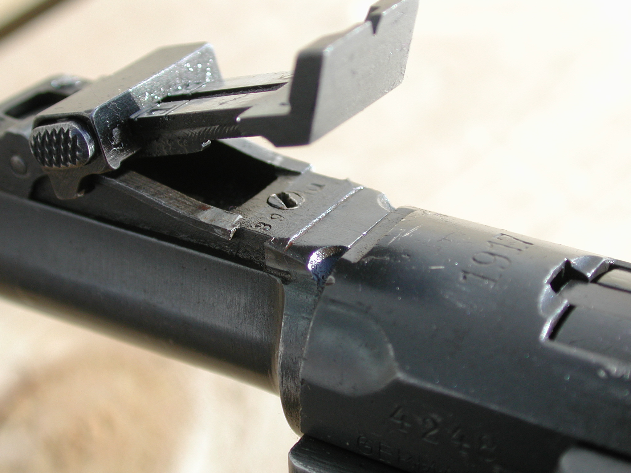

Question : From looking at the right side of the elevated Arty sight, it appears from the photo that some TIG welding may have occurred to attach part of the sight to the chamber area of the receiver...just ahead of the arty notch. Is this the case or just something I think I see in the photo ?
Here is the area I am questioning :
Doesn't look like that at all under normal lighting...between having a shutter speed just this side of a second and being in a poorly lit area..and me off-balance and moving around..it looks like it a bit.
I'll take some better photos later this evening which will hopefully clarify the matter!

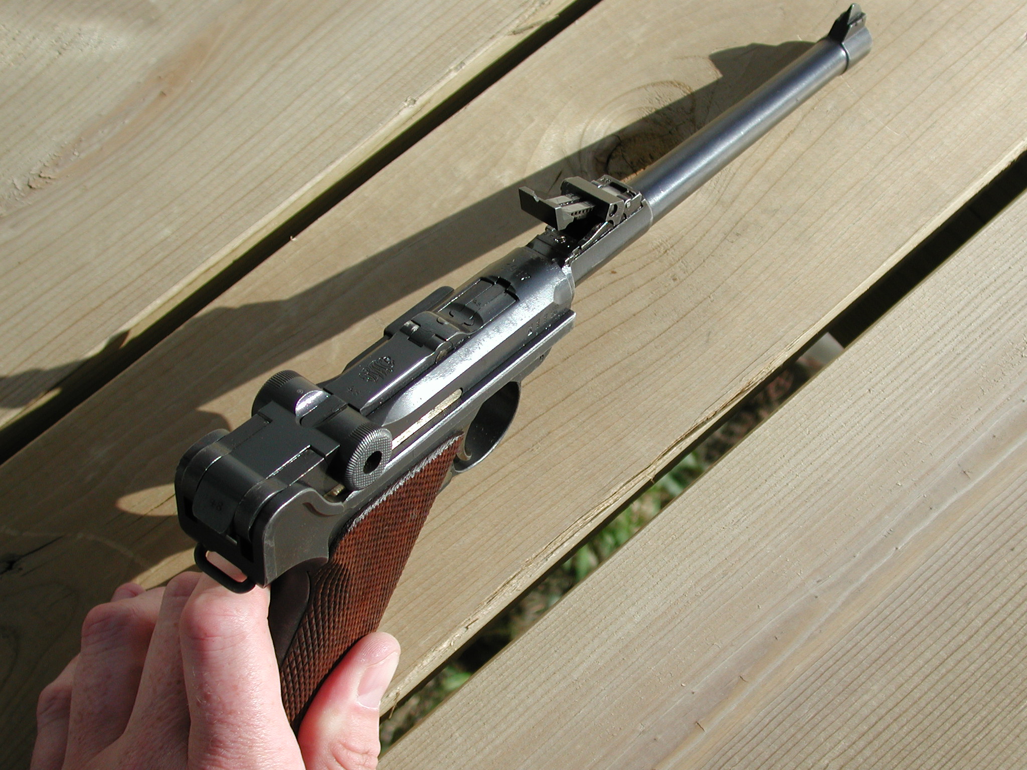

Ok, took a few new photos...shadows were killin me out there!
Click on photos for a larger version thereof.
Showing rear toggle...sorry, shadows, but hopefully enough detail exists to make it out...
Showing right side of rear sight...the crud on the bottom of it was just that, crud, soon swabbed off with a q-tip. Notice the number under the sight? I didn't see it until I swabbed the oil and grease off....it has "39" on one side of the screw, and "u" on the other???

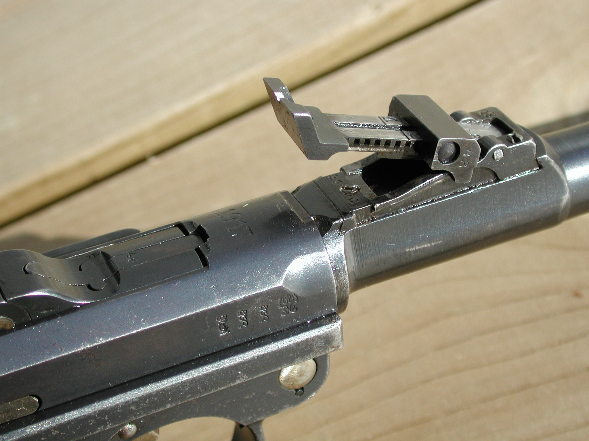

The other side of the rear sight...
