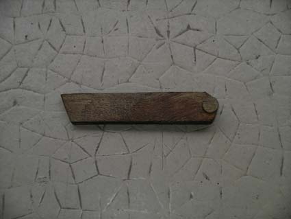

I have become this from an old man. Its look like a luger mag. But it is on wood. It is what Joachim G�¶rtz (in the book "Die Pistole 08") called a dummy magazin?
All informations is welcome.
Thanks and best regards
Olivier

Olivier, Your photo appears to show a wood peg with a cut down P08 mag bottom glued on. I've never heard of one of these for the luger, but the Borchardt did have a "dummy wood magazine" used for cleaning the C93. TH

Goertz indeed shows one in his book. These are thought to be dummy magazines for exercise purposes. There also was a wooden dummy luger.
Unread 01-01-2006, 01:29 PM   #5
The thought of having a wooden magazine, nonfunctional and expensive to produce, for military practice makes no sense. Perhaps for a saddler's use in making holsters or pouches, but not the military.

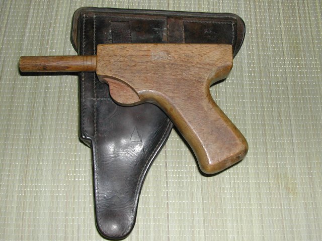

Bonjour Olivier,
Absolutely interesting finding.
I have in my collection the following items that are, in some way, related to your wood magazine.
In the pictures you can see a Holzattrappe, a wooden replica of the P08. In addition, a few months ago, I found out this interesting photo that shows a German soldier with a Holzattrappe during a training activity. This is the only photo I know where a Holzattrappe is shown.
Gortz states also that this item was used to fill the holster when not used for a while. This could be another use although the photo shows the use of this item for training.
Happy and safe 2006.

Mauro

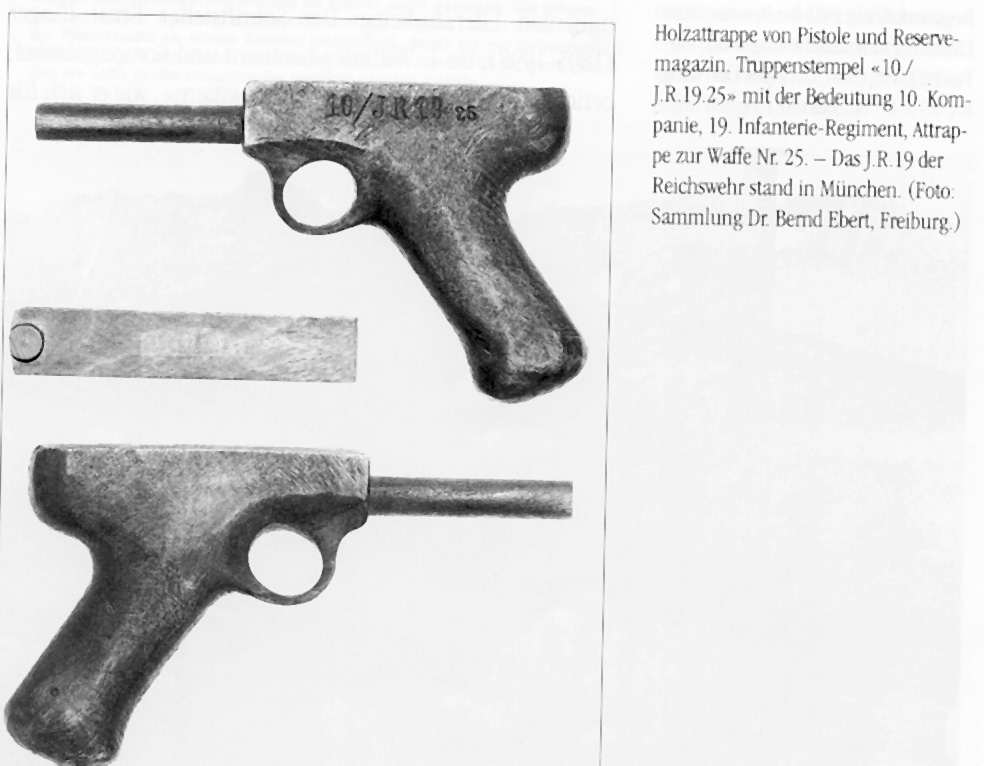

Hi Jerry,
Hereafter a scan from the Gortz's book. Actually I have seen only the Holzattappe I have in my collection and the photos I have presented therefore it is quite difficult to figure out if there are different types of Holzattrappe.
I hope this helps.

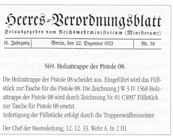

Hello to all.
Thanks for all the information you have give me.
Mauro you write that "there are different types of Holtzattrappe", I think it is normal. As it is write in german in your first post: "anfertigung der F�¼llst�¼cke erfolgt durch die Truppenwaffenmeister", thats mean that the regiment armor made this Holtzattrappe. So this is not a manufactured production, but a man made from the "Waffenmeister".
Best regards
