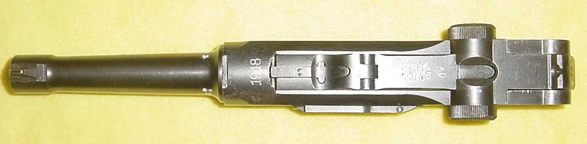

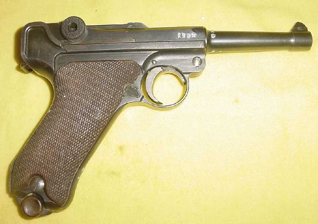

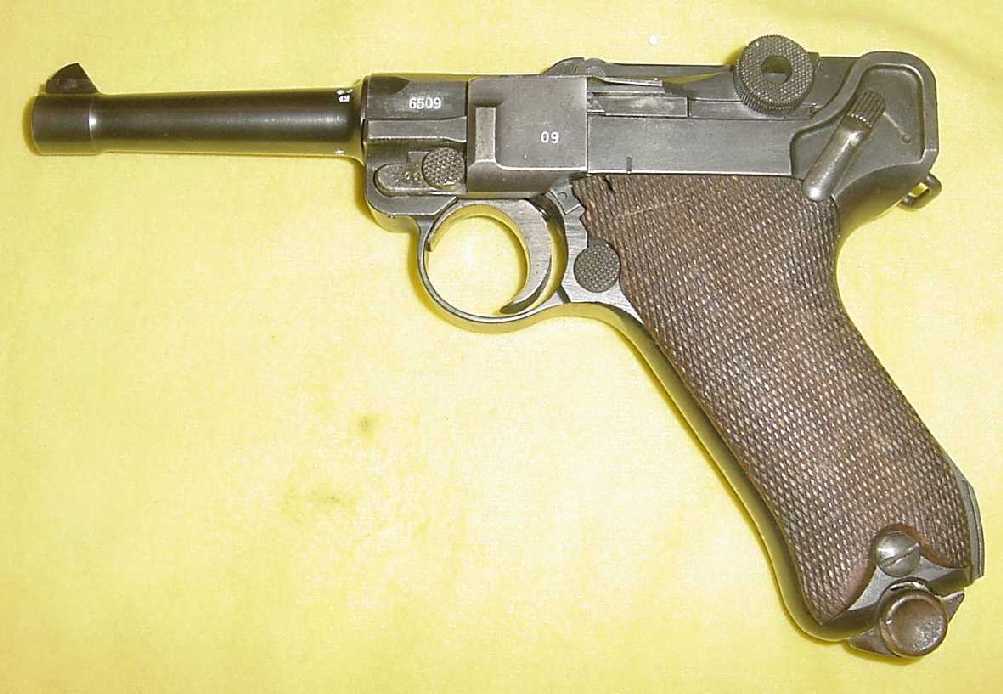

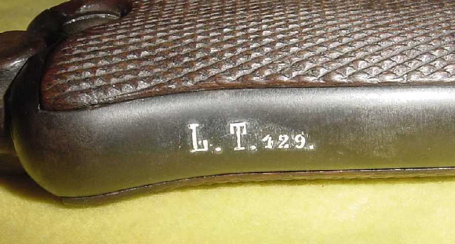

Here is some pics of my Trier District P08. I'll leave it up to the forum members to decipher where it has been and who has worked on it. It would be a good exercise for the newer collectors.

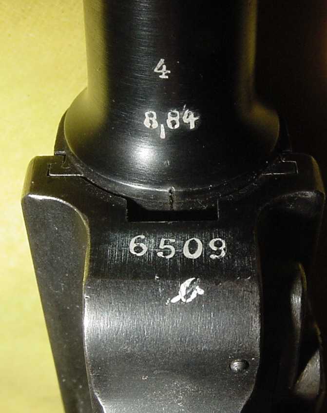

Why would the barrel have "4" on it...

Pete,
I don't know what the 4 on the barrel represents unless it is some sort of grade. The diameter 8.84 is somewhat unusual as you don't see many with
this diameter. At least I haven't.

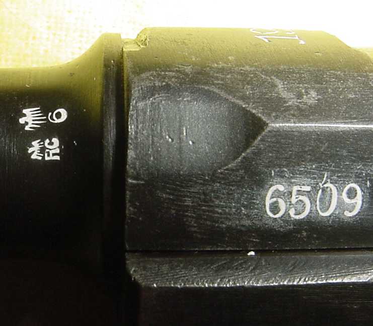

Unread 09-12-2005, 03:11 AM   #6
Started out life as a 1918 DWM LP-08.
Simson barrel. Left marks: Simson eagle/6 inspection stamp from 1920; 1920 Simson Revisions-Commision eagle/RC.
Right barrel: Simson test proof, probably 1920; PTV "Police Armory" stamp (jury is still out on "Technical Police").
No inspection stamp on replacement rear toggle link, which is unusual.
4 is anomalous. The odd 8,84 land diameter could result from Simson manufacturing practices.
