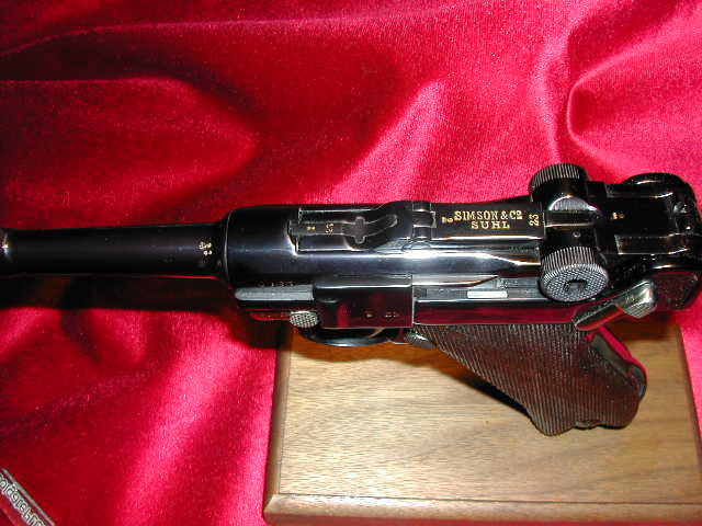

Birdhunter, I like to use the gold highlighting, I think it adds just a little more class than the white. I use a marking pen that can be found at most any good stationary store under the name of Pilot or Sanford. Not having used the Brownells stick I can't really compare the ease of use with it but I like the outcome.
http://forum.lugerforum.com/lfupload/simson.jpg
