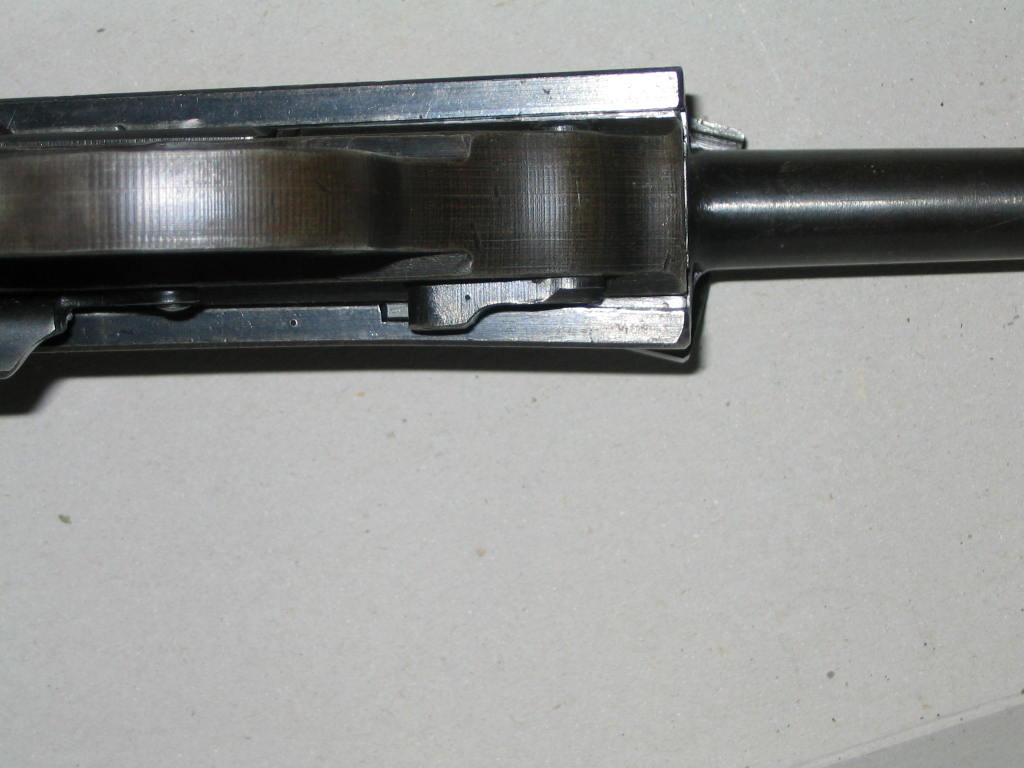

Many years ago I bought a Luger outside a bar on the wrong side of town from a down on his luck gentleman. Cost - $20.00
I remembering thinking "will this gun explode" when I fire it.
I took it home and thoroughly cleaned and checked the gun out.
I removed a lot of rust and pitting, checked for cracks along the rail (the good old tuning fork check) and replaced the take-down lever spring and the hold-open latch (the gun didn't have one).
I checked the barrel as much as I could ... it had a bright shiny bore with excellent lands and grooves ... I was kinda surprised by this but pleased.
The barrel was a replacement and had a target style sight ... I think it had once been someones proud little shooter project.
The gun is a marriage of 2 Guns ... the frame is DWM (3003-h) & the receiver is a 1938 Mauser (6879) with the trigger bar being the only other mismatch (91)
Still I have to tell you that I was very nervous the 1st time I fired it.
But it was phenomenal ... tight groupings with zero feed or misfire problems ... I had the foresight to use a new MecGar mag.
I don't have any 'before' pictures (mores the pity) but here she is after I cleaned her up... million dollar chip and all.

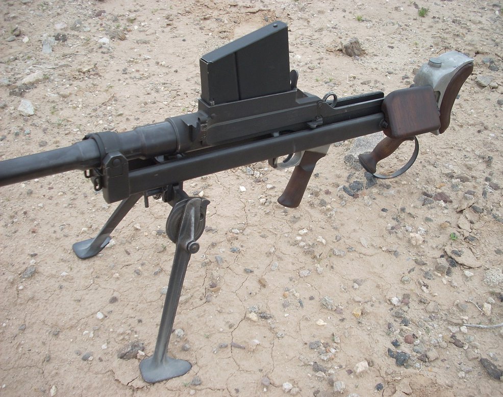

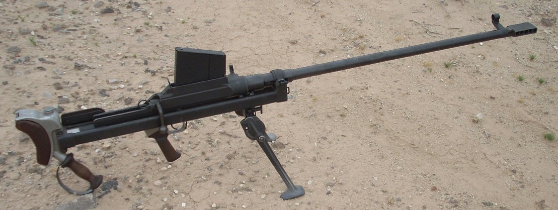

I watched Scott's video and then Ian's. Very sobering indeed. I have a Inglis 1943 BOYS rifle rebarreled to .50 BMG postwar. I used to shoot old 1950's ball ammo I got cheap, but these rounds had been around and probably not kept under the best conditions. Some of these rounds fail to fire, but I never got any hot loads out of them as best I know. Still have a few of those rounds. I have some old 1970's (I think), Brazilian AP that never gave me any problems. After seeing this, I don't think I will be putting anything but my factory fresh PMC and Federal ball through the boys. I don't want to risk what Scott went through and my BOYS is a nice collectible piece of history which can't be easily replaced. I now appreciate more than ever the BOYS design, specifically the offset of the sights to the left of center. In the event of a catastrophic failure only your shoulder is directly in line with the bolt and the shoulder is shielded by the shoulder piece. Also, I feel much better about the BOYS two locking lugs at the front of the bolt and the third lug bolt handle, than just having a screw on cap like Scott's rifle. I know the threads are engineered to handle great pressure, but bolt lugs put a lot more steel against steel I think. A couple pics to show what I mean. I will start another thread to share more pics of the BOYS rifle.

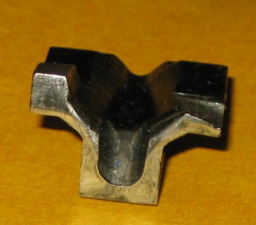

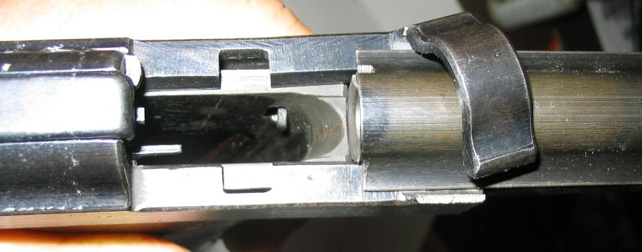

Locking lug sheared an ear, jammed in track-apparently.
Bring back pistol I had a long time.
A CYQ.
No animals or small children injured.

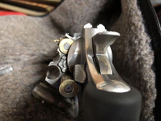

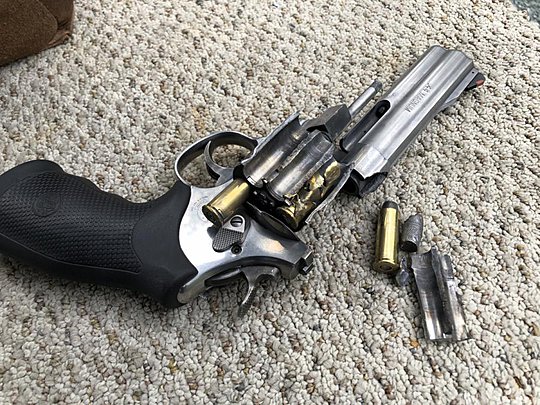

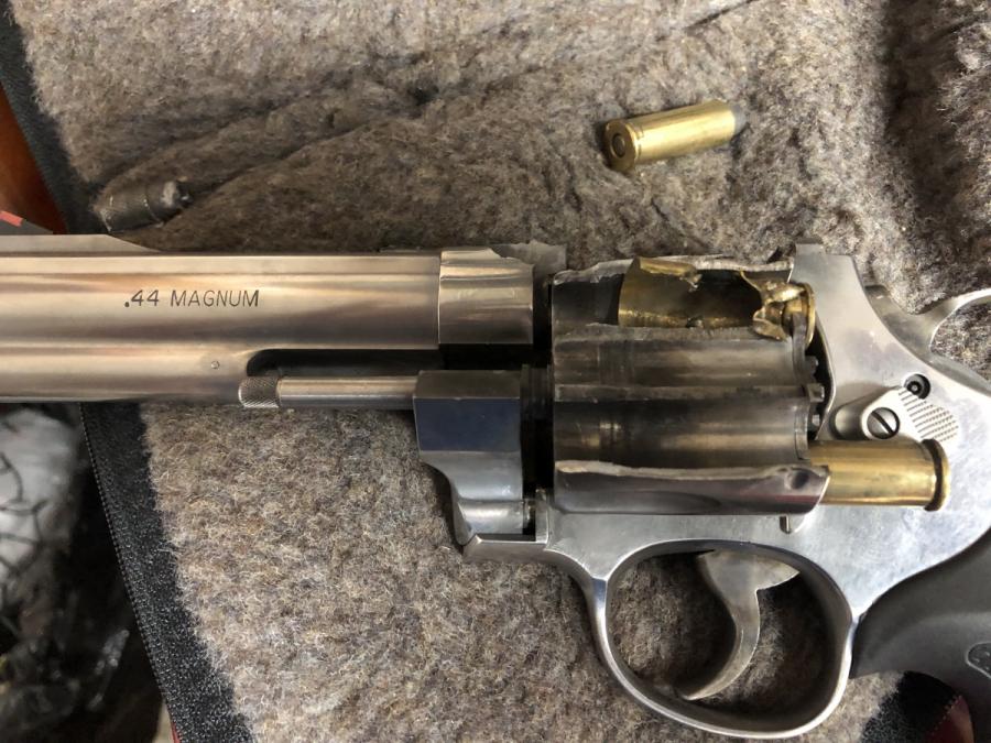

Yet another incident today. This appeared for sale on a gun board I peruse.
S&W Mosel 629 Blown Up
Hot load blew the cylinder and wrecked the frame / the rest of the gun could be used for parts or kept together as a conversation piece , $400 obo
With the ammo shortage going on I think there is a lot of shady ammo floating around out there ... be careful guys please.
