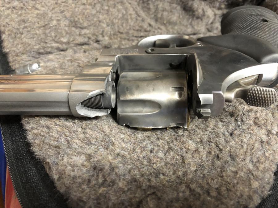

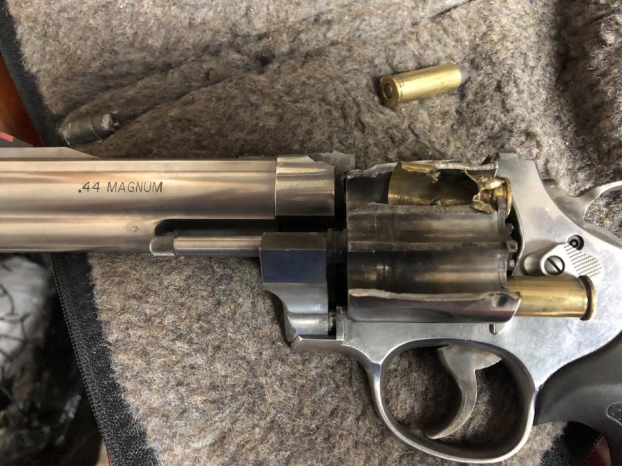

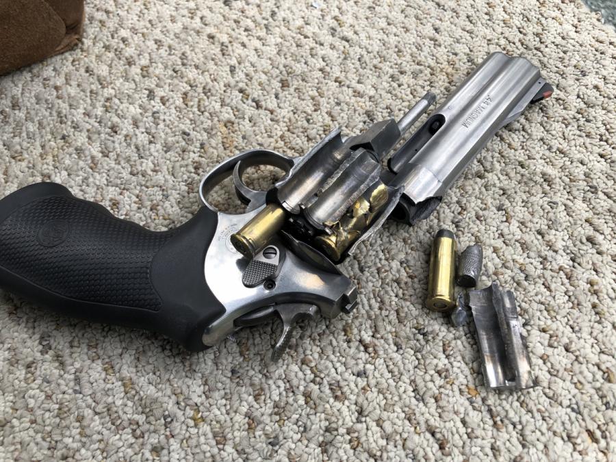

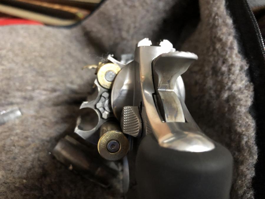

spangy 05-05-2021 11:06 PM
4 Attachment(s)
:( Yet another incident today. This appeared for sale on a gun board I peruse.
S&W Mosel 629 Blown Up
Hot load blew the cylinder and wrecked the frame / the rest of the gun could be used for parts or kept together as a conversation piece , $400 obo
Attachment 82915
Attachment 82916
Attachment 82917
Attachment 82918
With the ammo shortage going on I think there is a lot of shady ammo floating around out there ... be careful guys please. :(
