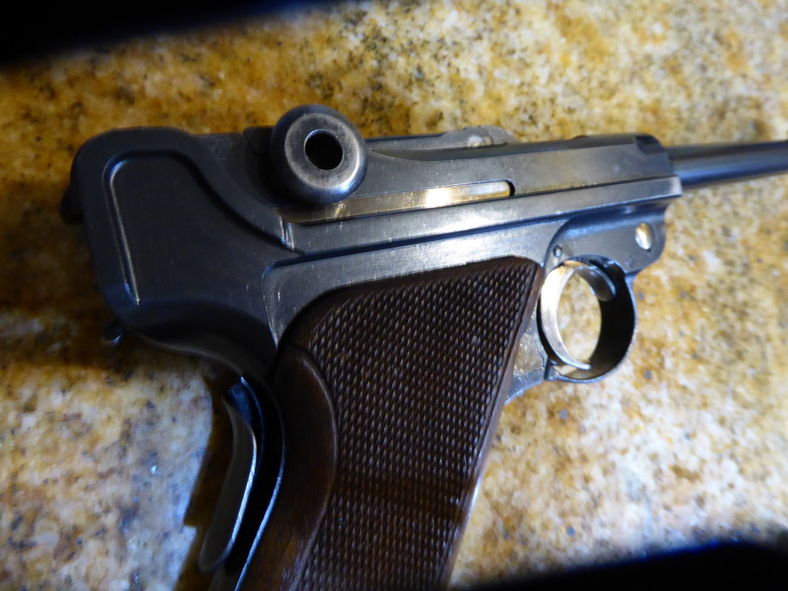

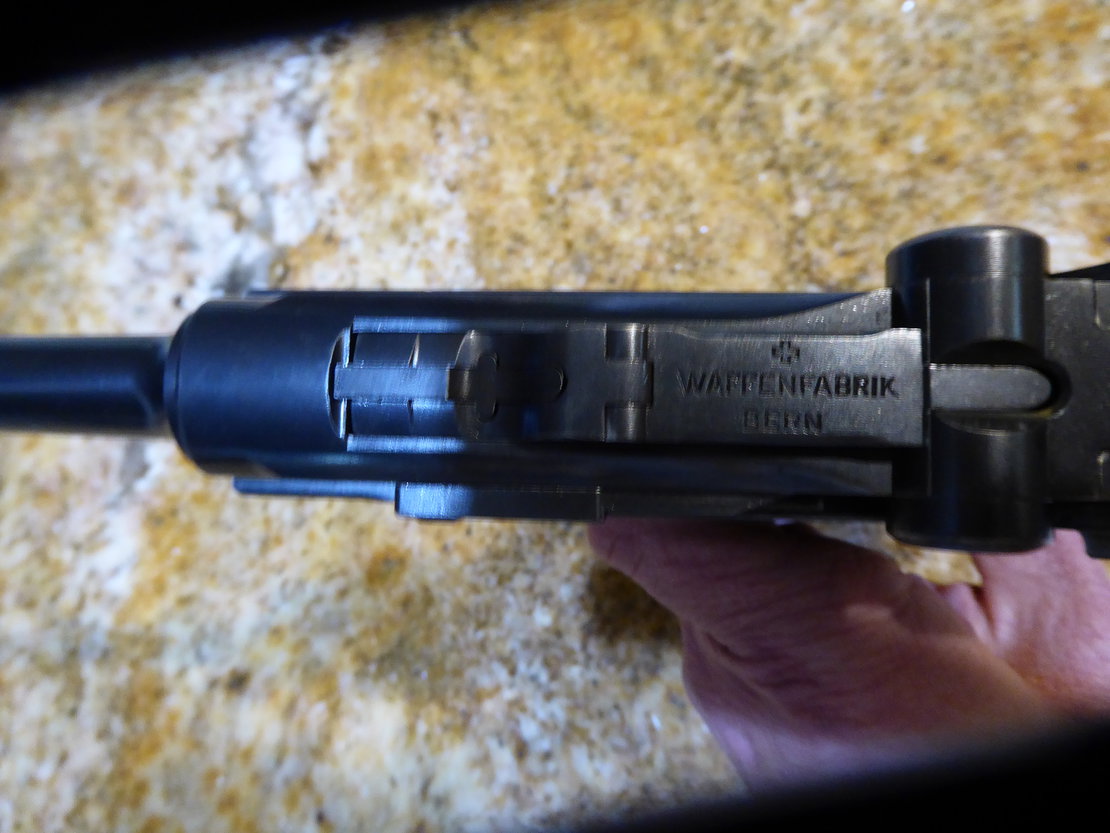

Good Mornin All
Well i got lucky at a local shop.
Picked up a Swiss 06/24 ( my first ) and a first variation AC41 P38 that is fully matching
The Swiss looks in great shape no import or P mark
Sorry about the pics camera shutter is having issues time for another one
The Grips are both numbered and match each other but not to the Pistol all other serialized parts match
Couple questions
Is ther a S/N to Mfg Year list available( it's in the 19000range)?

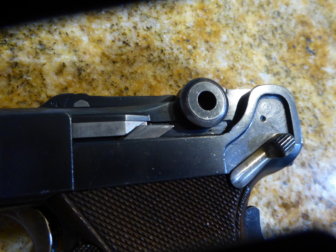

The Toggle is not knurled, I had read some transitional Lugers have been found that have 06/29 parts, or could there be another explanation?
Of course other comments and questions are always welcomed

Good day,
That is a nice find.
It was not until 1918 that the Swiss were able to begin production, with the first deliveries of Bern manufactured 1906 Parabellums being met in 1919.
My copy of 'The Borchardt Luger Pistols', on page 651, tells me that serial numbers 18751 - 20880 were produced in 1922, so that range includes your Luger.
Stay safe
Richard

I always do this and I am going to do it again...There ain't no such thing as a 06/24 Swiss.. As Richard has pointed out, Swiss production began in 1918, not 1924. Fred Datig got the wrong date information back in the 1950s from a Swiss individual that didn't know what he was talking about, and we have been stuck with that designation ever since. It is a "1906 Waffenfabrik Bern" or a "1906 W+F" if you prefer, but not 06/24.
(Nice looking gun by the way. Well done.)

rpbcps is correct that the year of manufacture is 1922.
Ron is also correct that it's a 1906 W+F or P'06 W+F as Gortz & Sturgess call it.
The receiver stop lug on your Luger should have the last three digits of the serial number stamped on it and the last two digits on the rear toggle link and small parts.
You have a very nice Swiss Luger. Enjoy it.

Thank You All
I'm pretty happy with my 1906 W+F
The Lug and Toggle do have the S/N's and match
Any toughts on why the Toggle would not be knurled?
I would think 1922 would be to early for a Transitional
Thanks Again everyone!

The toggle has been replaced post-1929. It is not uncommon to see them, and the factory repair process is well documented.

As Gerben mentions, repair and refurbishment was common in Swiss Lugers.
When an officer retired, they had the option to acquire their service firearm, and in that process they could have it completely refurbished by the arsenal.

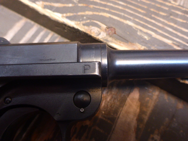

Here is the 'P' mark on my Bern 06/29.
File Type: jpg 56603 P 'released from service' stamp.JPG (155.5 KB, 3439 views)
