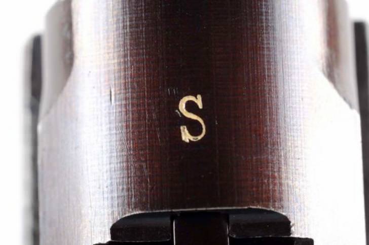

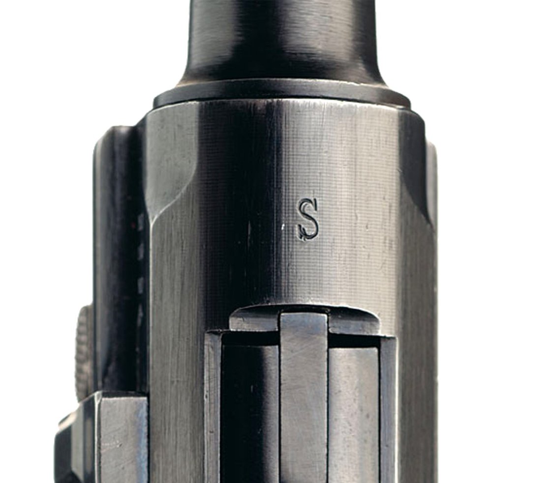

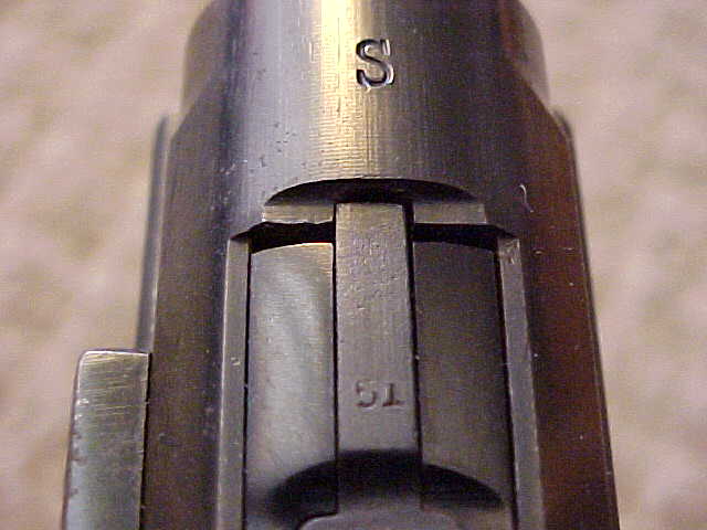

Here's some close ones with plum colored recievers .
Note the shattering on all but yours .
Yours is first and is quite different than the others .
1958 , 2054 , and 2066 have some plum color and chattering .
Last is my 2014 that has no plum color but has chattering .

Krieg receiver for sure .
I don't buy into the use of mauser parts and HK himself stated they only used their own parts .
Your receiver is not unique - it is not " normal " but others like it are around .
I do not find your gun scary looking but as stated much better pics are needed .
Actually in-hand is best with these .

I find the second and third chamber pictures intriguing. I can not think of any tool that would leave that crosshatch pattern...
Maybe a shaper???

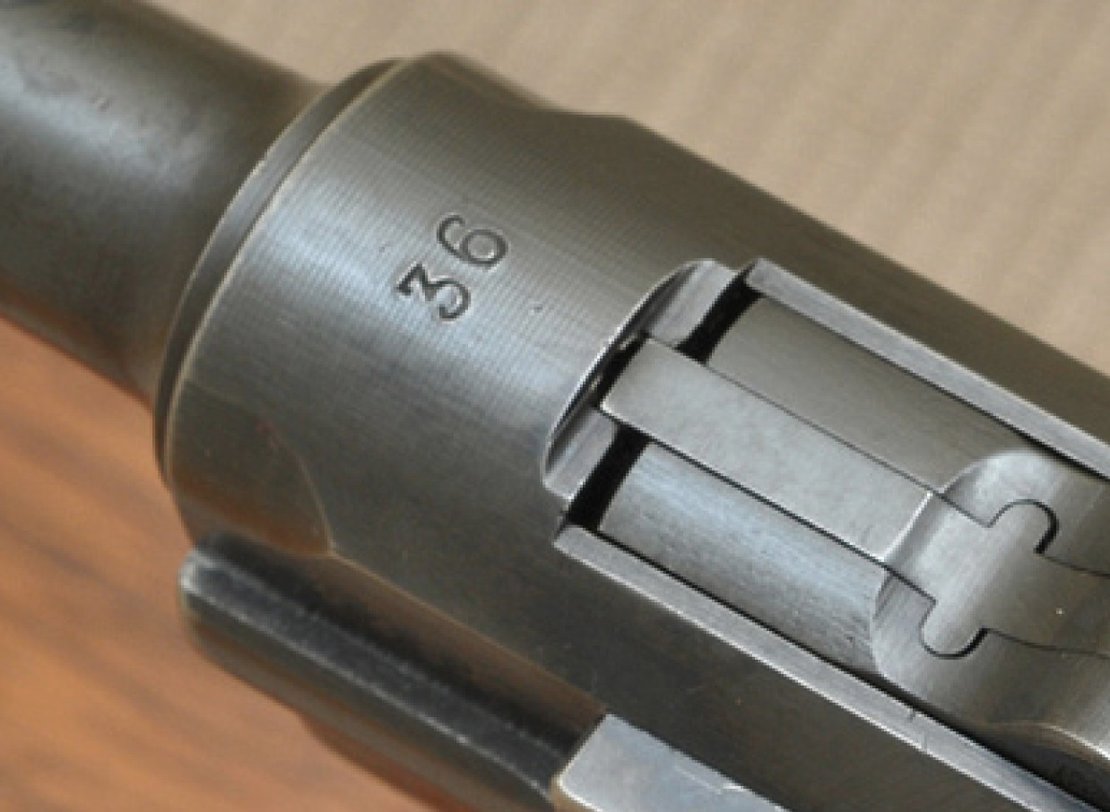

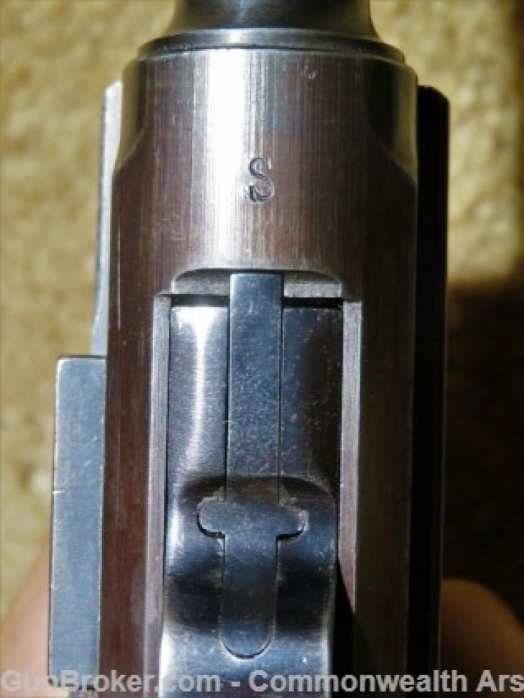

Maybe a shaper???
Not sure meself on how but it is very common on earlier HK's

Unread 08-15-2019, 03:54 PM   #53
I think it is from two "tools", one used longitudinally and the other laterally; or perhaps a tool and a
grinder.
It would be near impossible to duplicate, i.e. "fake". JMHO.
Unread 08-22-2019, 11:28 PM   #54
1933 FORD NUT
1933 FORD NUT's Avatar
Location: WI
Posts: 88
Thanked 70 Times in 37 Posts
grinder.
Agreed on the pain to duplicate .
HK's are rich in these kinda things .
Note OP's does indeed have chattering on edges .
Top got a little more finishing possibly to make the extra mark fade ?
Note how crisp his " S " is .
Compare the receiver notch on all .
All Krieg and no other MFR's notches look like this .
1933 FORD NUT is offline   Reply With Quote
