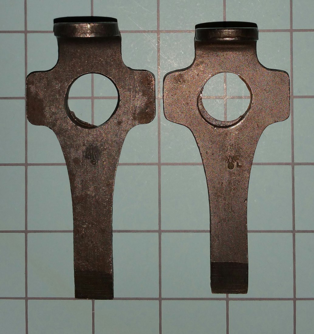

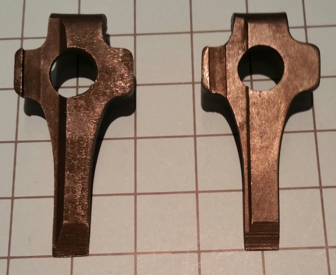

It seems the more I study the more questions I have. In my search for a Simson tool I came across these and am not sure of their authenticity, any help would be greatly appreciated. Thanks

Does not look authentic to me.

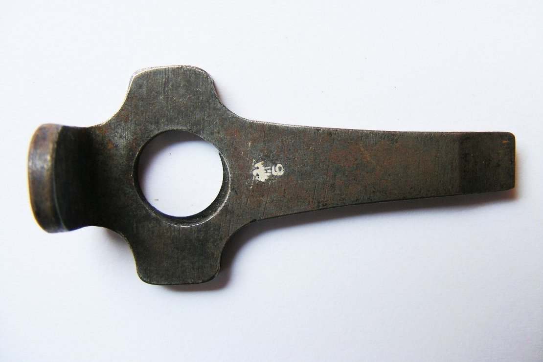

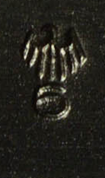

Once, when I was in a long search for a replacement grip screw for my Simson Luger, a well known Luger seller offered to fabricate an E/6 screw for me... Not amused.
Compare your tool to this mark of a Simson Luger. In particular, the eagle's head is not a triangle.
The following 5 members says Thank You to mrerick for your post:
Unread 07-22-2019, 02:40 PM   #3
Absolutely fake. No question. Where did you see these?

I got them at a show the story was good the buyer was a fool.
Well at least I can help others know what not to look for, that's worth something.
So I guess I am still looking for a Simson tool, in case anybody has one that's looking for a new home.
Does anyone have pics of any original Simson tools, variations etc.

So neither tool is authentic ?
Unread 07-23-2019, 12:00 PM   #7
JTD
Join Date: Feb 2005
Location: PA
Posts: 428
Thanks: 218
neither one looks good to me. Give away is swastika area is an x. Probably the die originated out of Poland. Just sold a good Simson tool to a collector friend. John

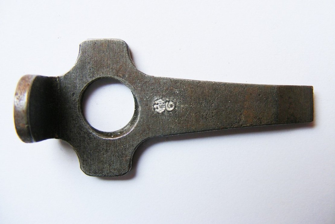

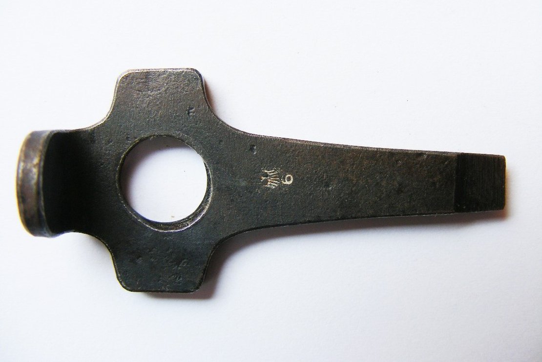

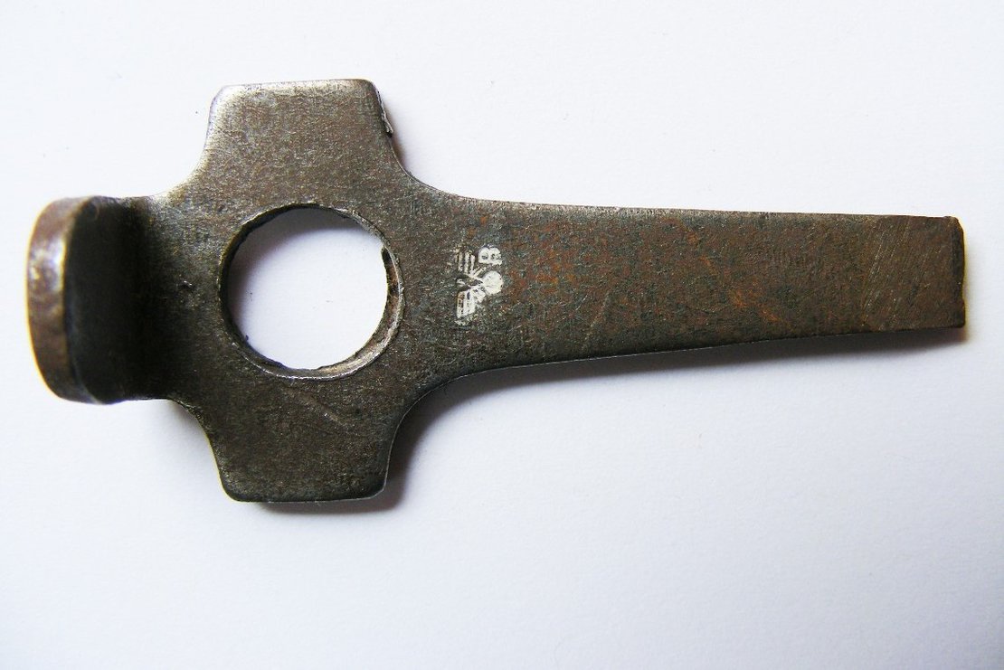

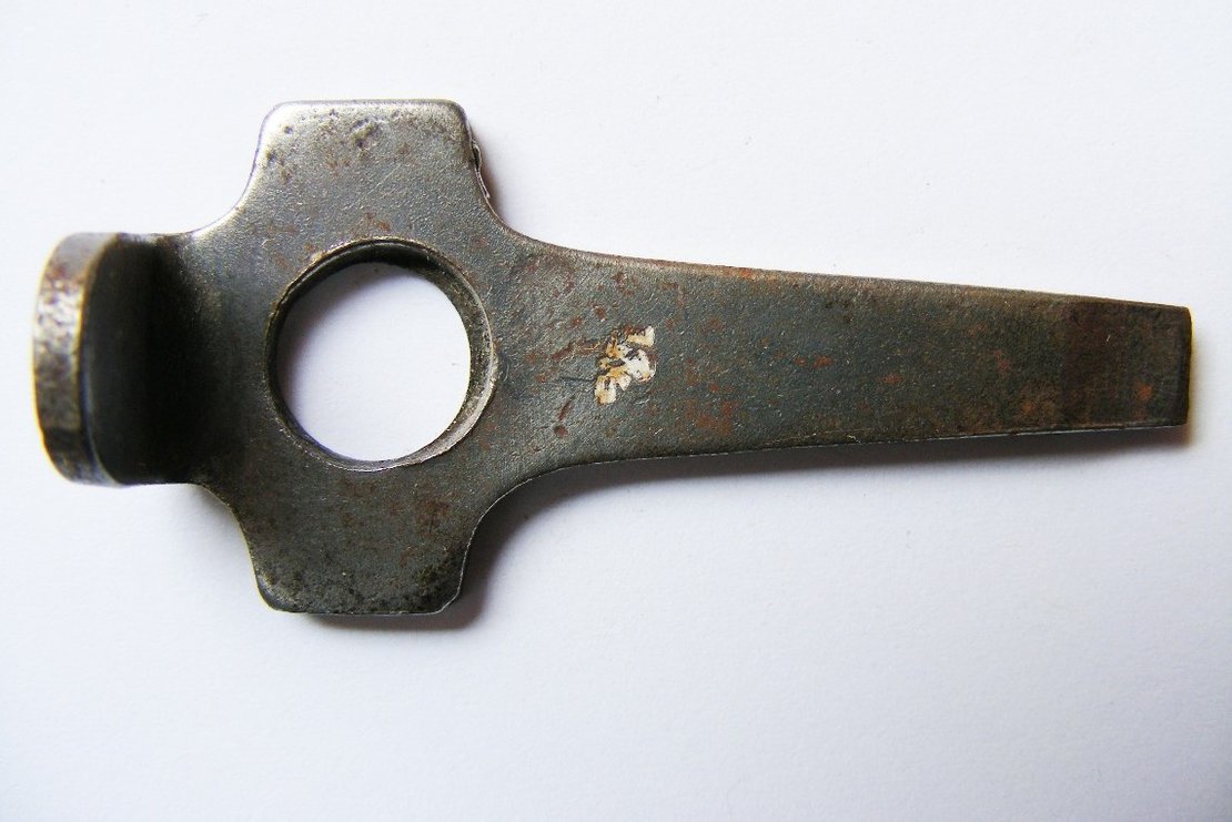

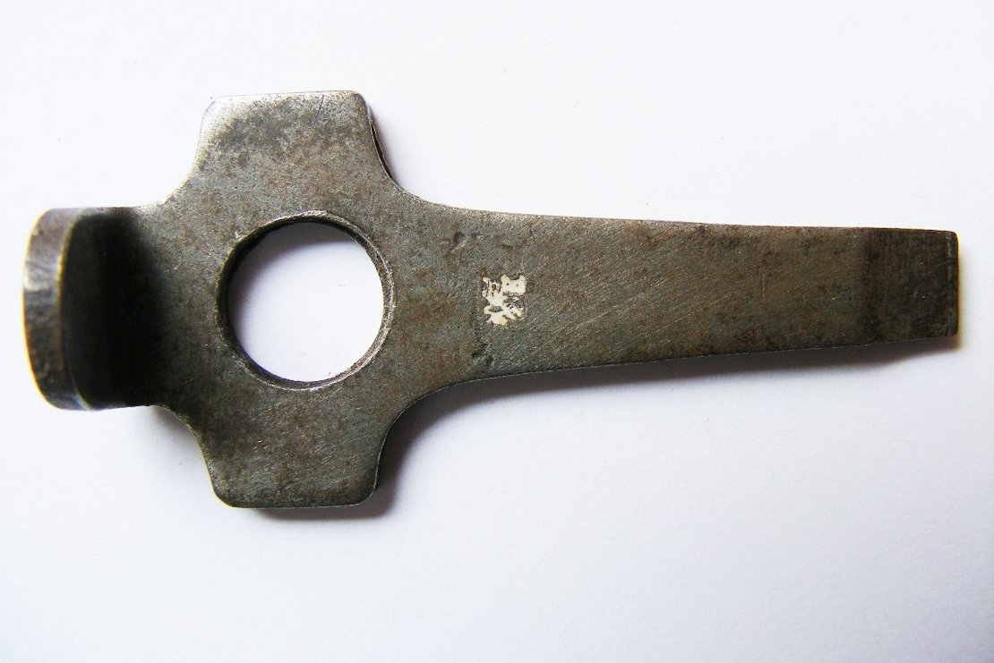

Simson and Police tools are unblued, have other shapes and the acceptance marks are not correct

The following 9 members says Thank You to klaus 3338 for your post:

Klaus, you are a treasure!
The following 4 members says Thank You to George Anderson for your post:

Wow, thank you so much for your guidance, it doesn't get much better than this. Exactly what I needed.
