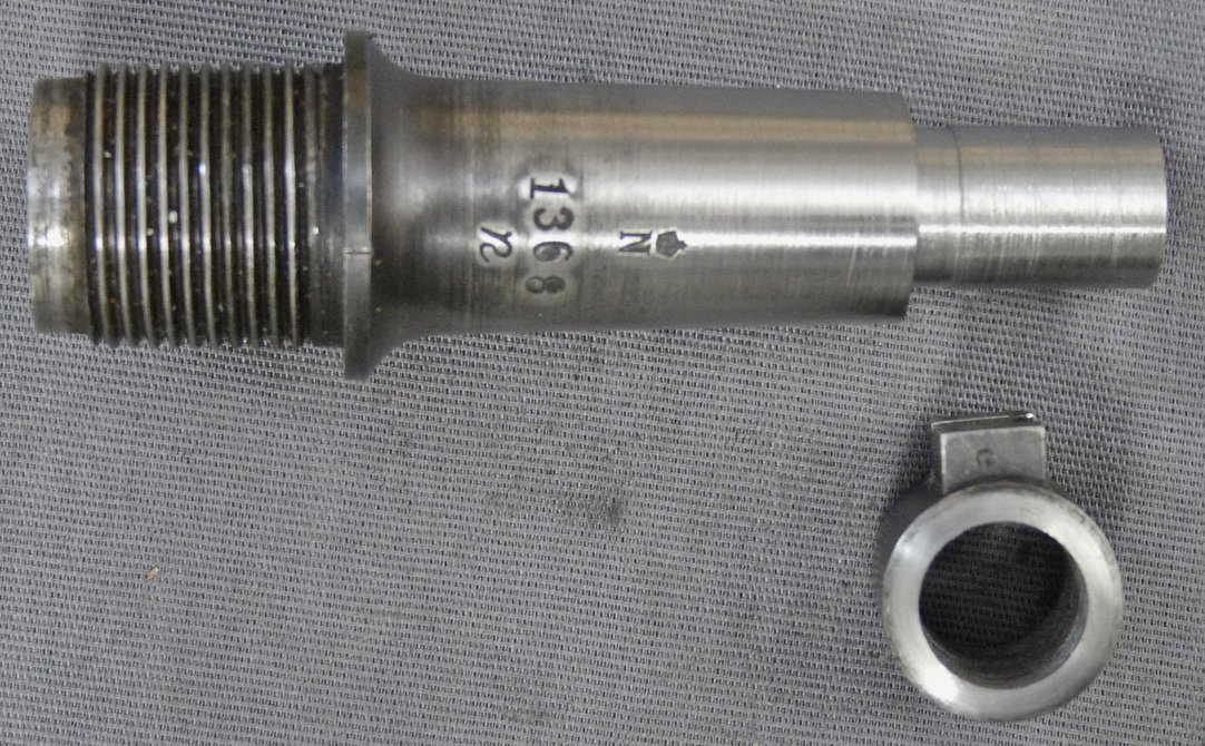

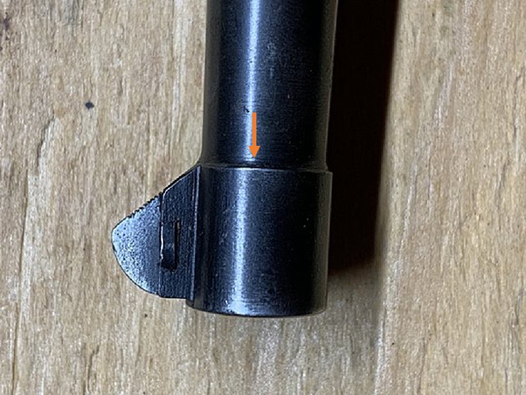

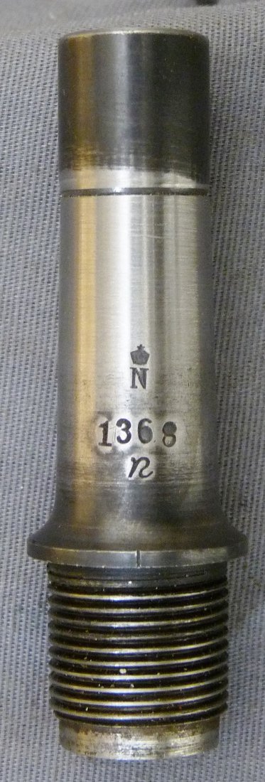

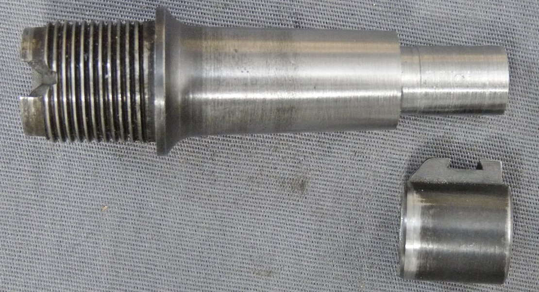

Unread 07-04-2019, 08:22 PM   #22
The barrel has been shortened and the sight band re-installed. A really nice job.
A tip of the hat to David (ithacaartist).

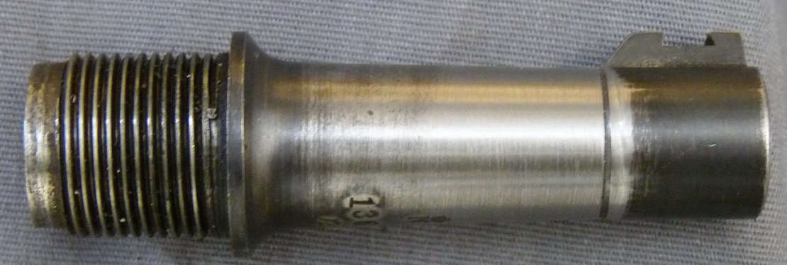

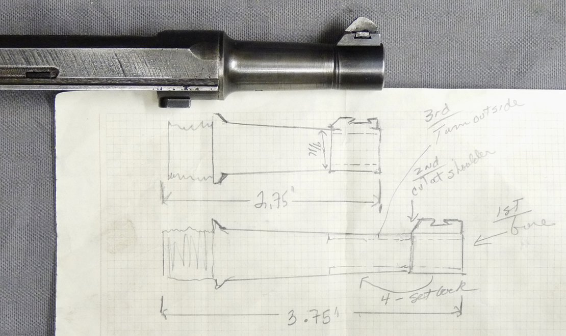

3" barrel for a "baby" luger and how it is done:

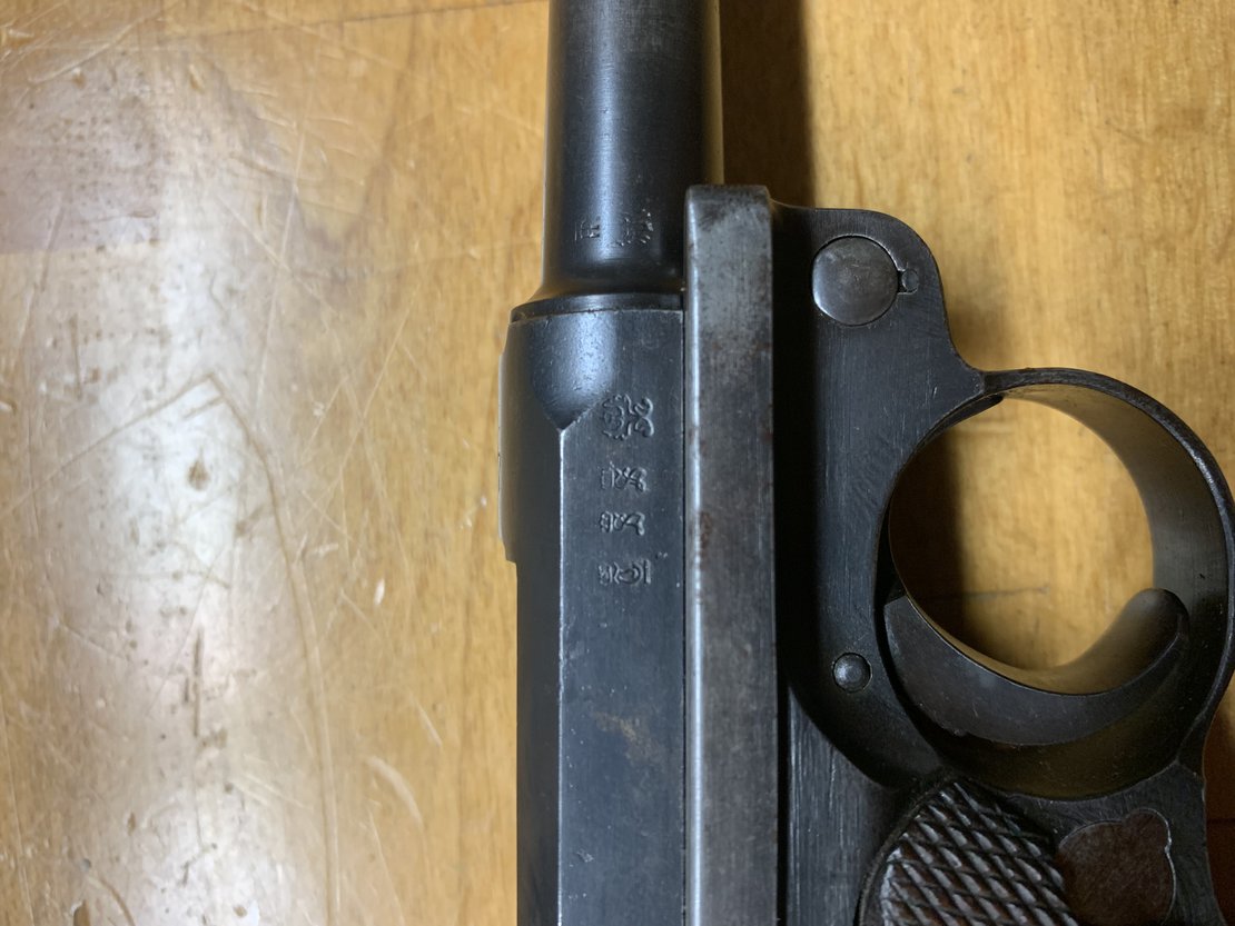

The marking on the front of the TG is the "revisions commission stamp" and the normal Erfurt inspection crown/letter.
Don is correct that the frame is Erfurt while the receiver is DWM.
The C/RC (Revisions Commission) stamp indicates a part that the factory inspectors found a non-critical fault with but was passed as serviceable by RC inspectors. In the event of failure of such a part, the RC inspector would accept the responsibility. The C/RC is more often seen on Erfurt parts than on DWM. Below is an Erfurt receiver also marked C/RC.
So does that mean the frame was replaced or an Erfurt RC inspector inspected this DWM possibly after WW1?
BarrelBaggins is offline   Reply With Quote
Unread 07-05-2019, 10:09 AM   #30
The receiver was made by Erfurt, the "defect or variance" was noted and either corrected or passed by the RC at Erfurt, at the time the pistol was first made.
Corrected: the receiver is DWM, the mid link(and perhaps the entire toggle) is DWM and is a later replacement.

Originally Posted by BarrelBaggins View Post
I also read that DWM made most of the Artillery Lugers. Maybe my references are incorrect
Your receiver is DWM. Compare the DWM Eagle stamp on your Luger to the Eagle on my Erfurt receiver.
DWM did make far more Artillery Lugers than Erfurt. Erfurt only made Artillery Lugers one year: 1914. Jan Still says that only 23,000 Erfurt Artillery Lugers were made. Manufactured in blocks of 10,000 with the first block not having a suffix letter, the highest serial number Erfurt Artillery Luger will have a "b" suffix letter. DWM made them from 1914 until 1918.
It is interesting that many DWM Artillery Lugers have barrels supplied by Erfurt as indicated by the Prussian Eagle - the Eagle used by Erfurt inspectors - on the barrels near the right side of the receiver.

Your frame has an "RC" stamp on the trigger guard, so it is an Erfurt frame. The "RC" stamp was almost never (or never) used on DWM pistols as they were a private firm and agreed to deliver pistols without flaws of any kind. The military arsenal at Erfurt could pass pistols with minor flaws with a government inspector signing off on it.

I'm of the opinion that your gun is an Erfurt with some replaced and renumbered parts from a DWM. Specifically the center toggle, side plate and possibly some other small parts.
