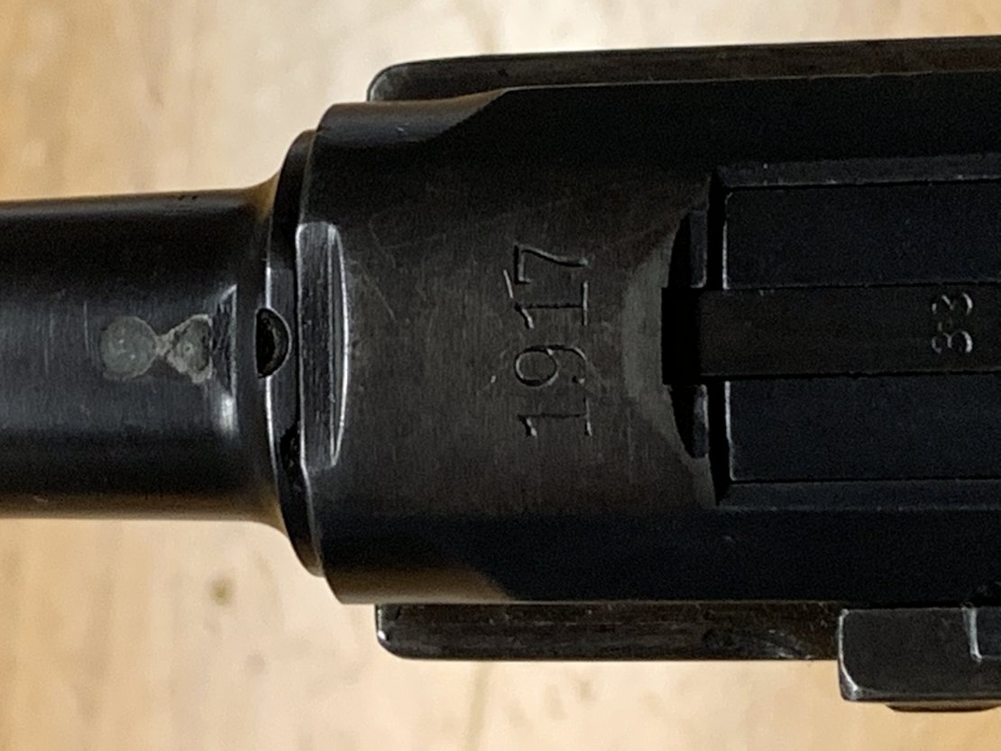

Hello!

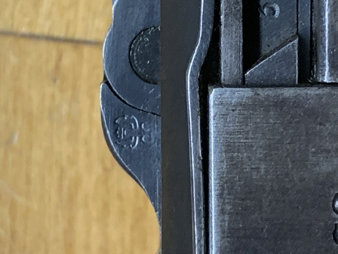

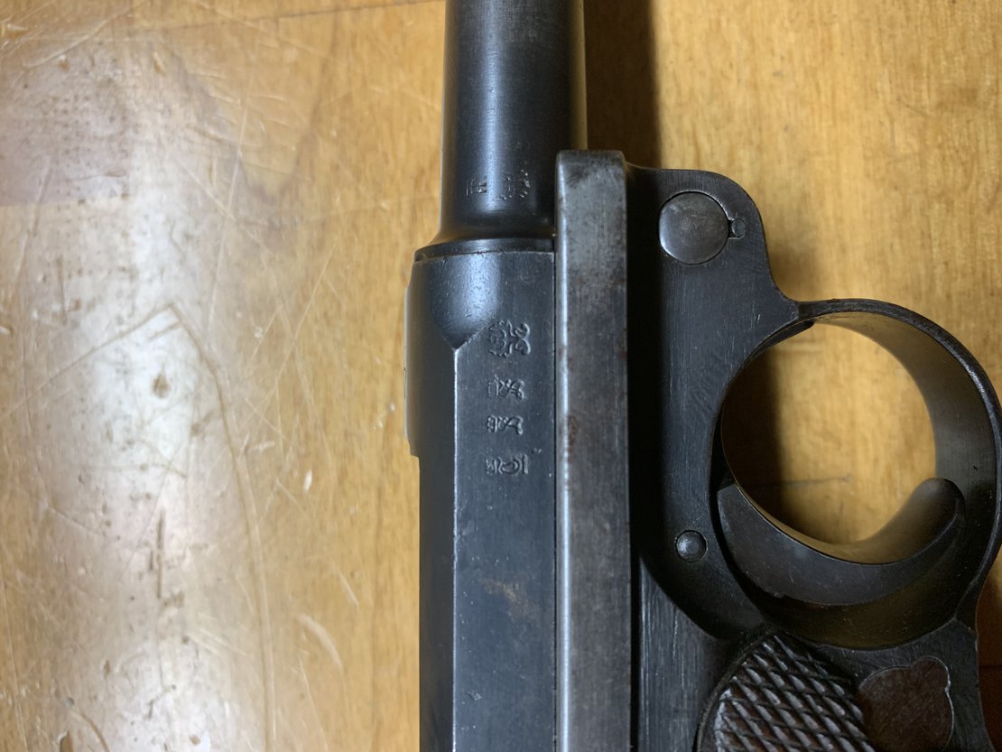

I am new to this forum and was hoping someone could help me with what kind of Luger I have just purchased.
It’s labeled 1917 (no 1920 so I’m assuming this was illegal to own after the whole confiscation happened) and it’s a DWM. I believe the proof marks mean it was a military Luger.

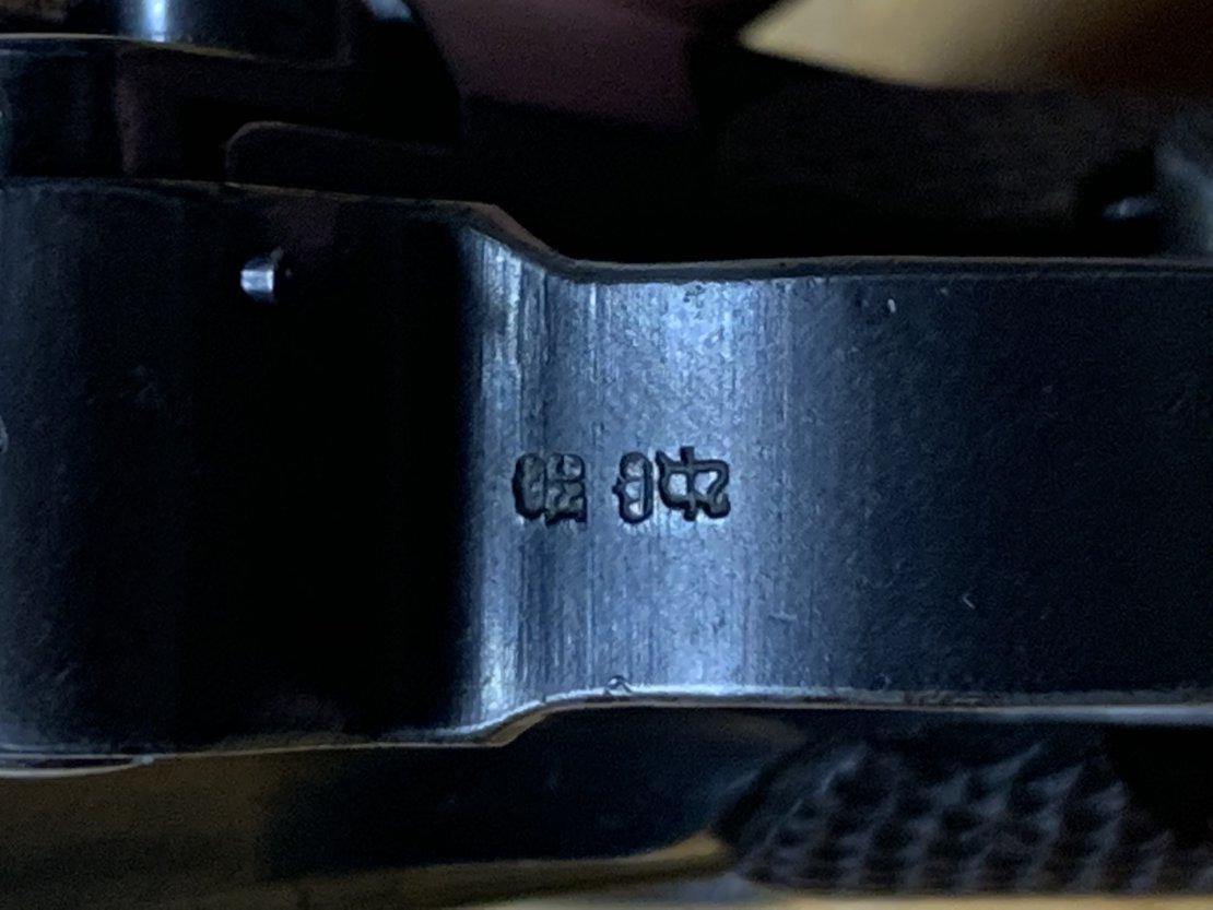

The markings I don’t understand are the ones on the trigger guard. They almost look like an RC with a crown and then under that a letter A with a crown.

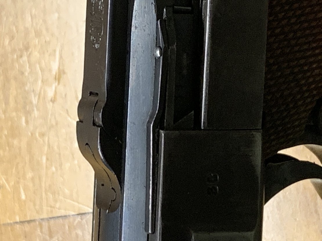

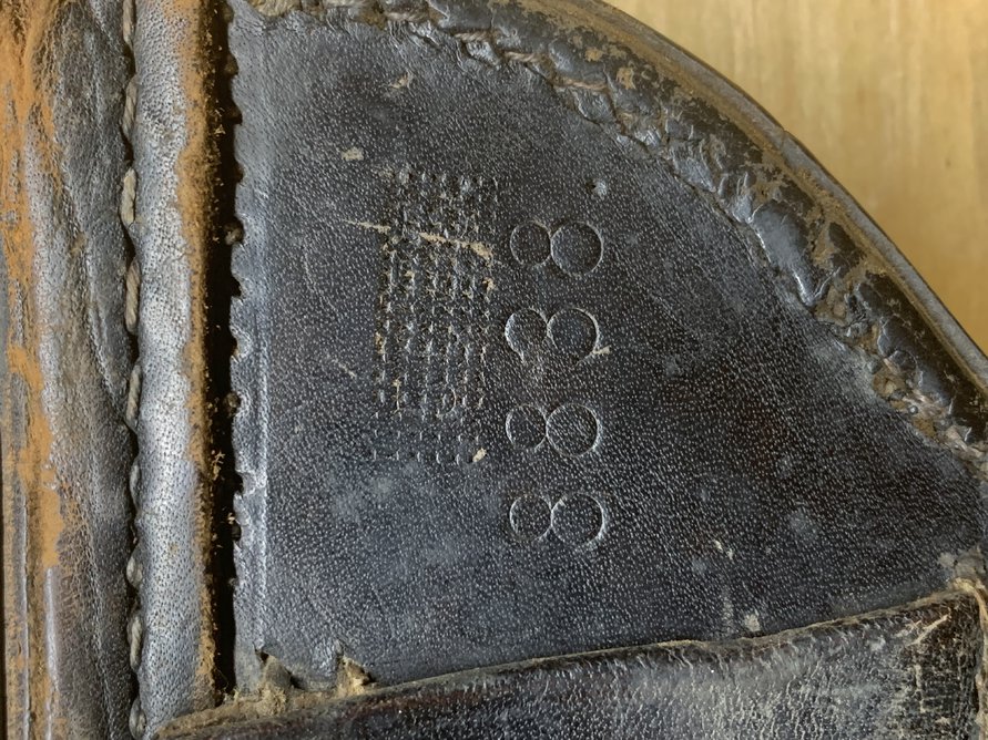

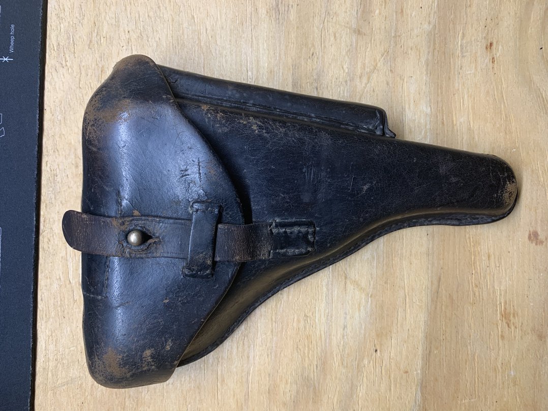

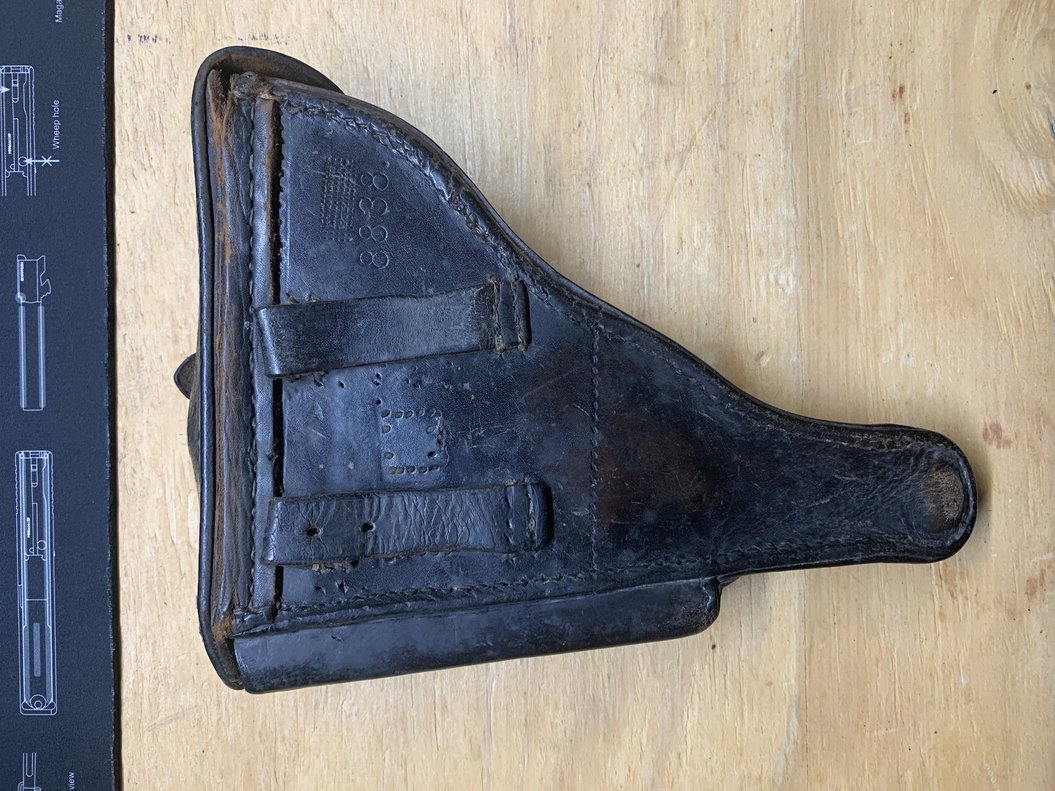

I also noticed it has a seat safety installed which was more of a police modification but I am not seeing any police markings. The holster it came with is also a police model holster that was matched to the Luger.
All parts seem to be matching.

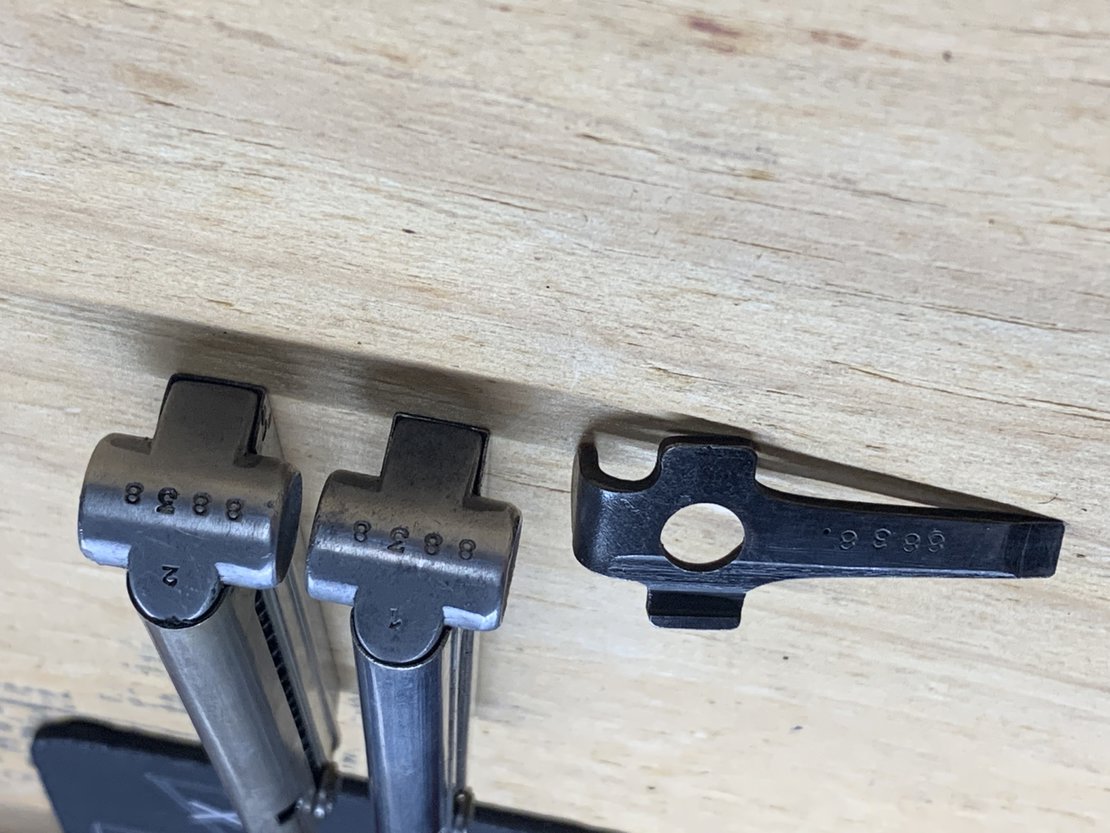

The magazines have matching numbers but I know the 1917 Luger came with wood bottoms. Maybe the magazines were updated? I also have the second magazine.
This Luger also came with bring back paperwork from a US soldier that states the Luger (with serial number) and holster.
I’m just trying to figure out the markings and a possible story.

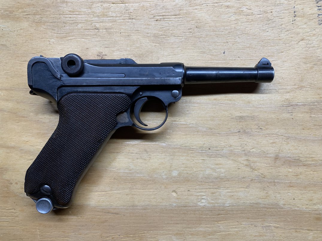

Based on what is seen in the pictures. It is indeed a DWM 1917 military pistol then pressed into police service after WW1, but without a 1920 property stamp. You have what is widely considered to be the best magazine for it-a Schmeisser-Heanel-with a police-style numbering indicating it was the primary magazine for police service of the gun as the serial is matched to it as well. Looks to be reblued or the strawing is almost gone on all parts that are visible (takedown lever and trigger most obviously should be a golden color or more of a bare steel color instead of blued like the rest of the gun as the pictures seem to show, it could also look that way in photos from bad lighting). It should be a fantastic shooter piece if that is the case as the reblue kills collectible value for it.
Welcome to the forum and read the FAQ, accessible at the top of every page. It has tons of good info. It can also show you some of the other picture angles you’ll want to post for better evaluation of it.

Reblued yes, but probably done during police rework, so no huge deal. Formerly an artillery model, re-barreled. A nice gun with it's own group of specialty collectors.

Wouldn’t the pistol have to have the 1920 stamp for it to go into police service? Otherwise that would mean this pistol was never turned in from what I’ve read.
Also does anyone know what the markings (attached) mean?

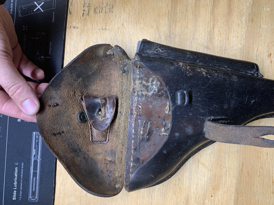

Figured I’d show the bring back paperwork also

The marking on the front of the TG is the "revisions commission stamp" and the normal Erfurt inspection crown/letter.

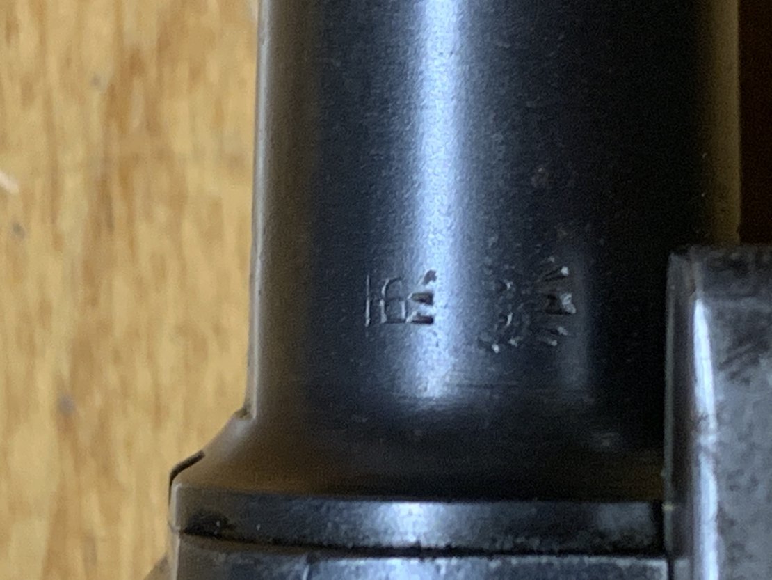

The TP on the barrel is the mark applied when the barrel was replaced by the Technical Police organization(armorer) and the eagle is the firing proof of the Weimar era.
Check out the FAQ for answers and info, explaining these and other markings.
Nice to have the paper with the pistol number, matching mags, and holster!
It is a "sear" safety.
I am afraid I disagree with this - when refurbed, my experience is that they were reblued, just like it was new, so anything you see as reblued that shouldn't be, was done by a NON armory...

Not all police guns received much in the way of marking (the TP shows the barrel was replaced) - perhaps it went back to DWM for refurb and received a 7.65mm then went to the police.

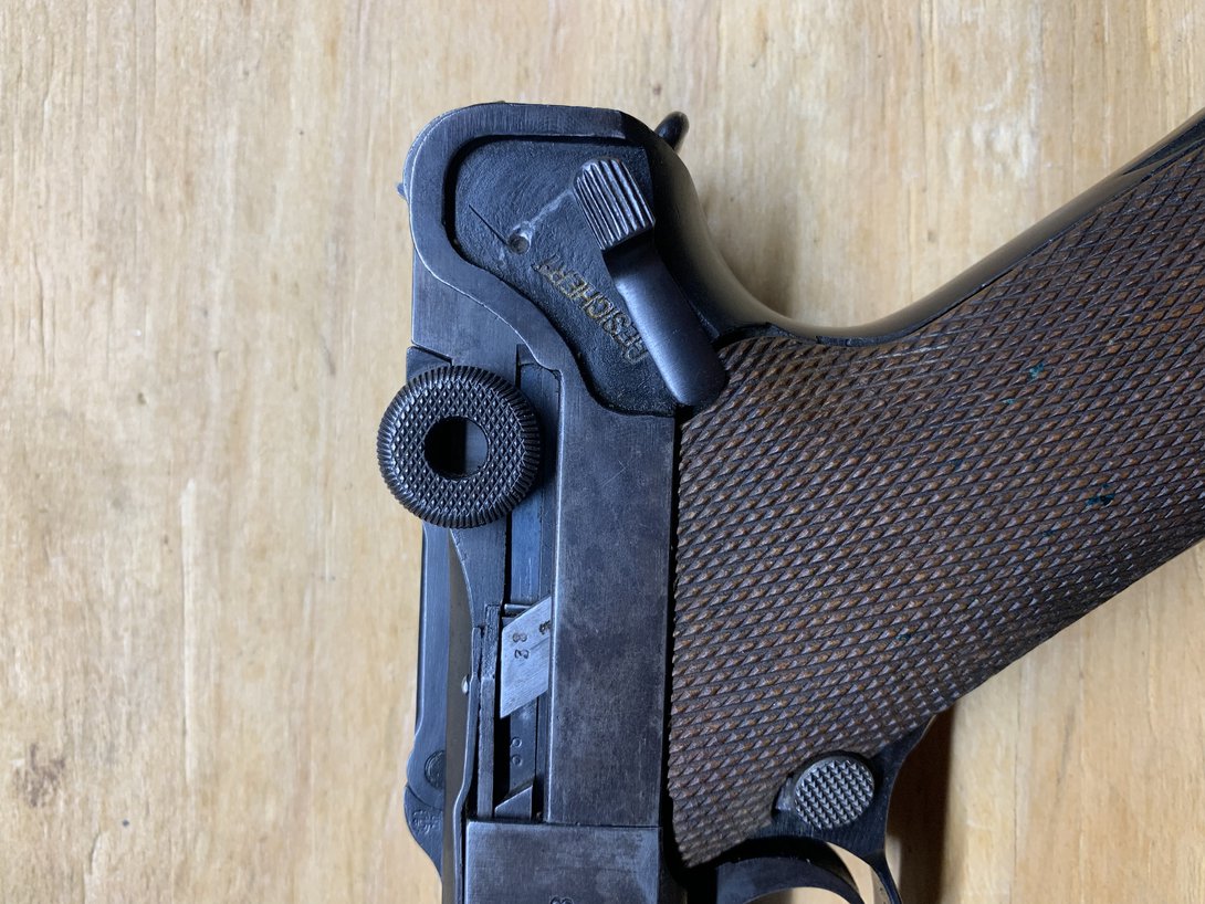

The magazine is a police magazine - it could have been police, or it could have been matched up after the war

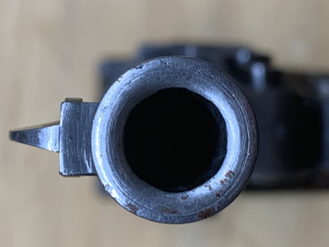

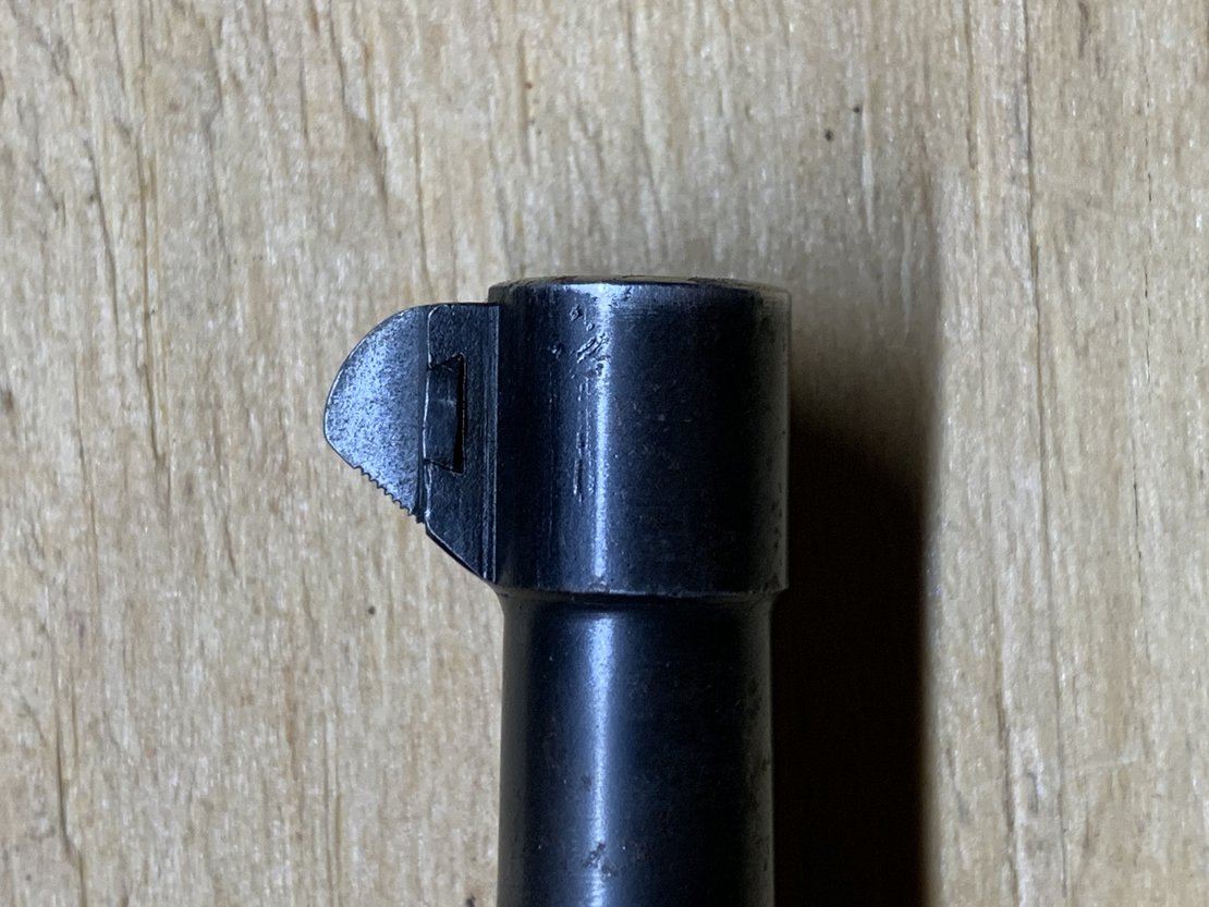

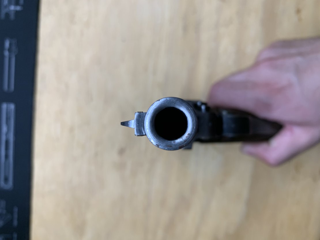

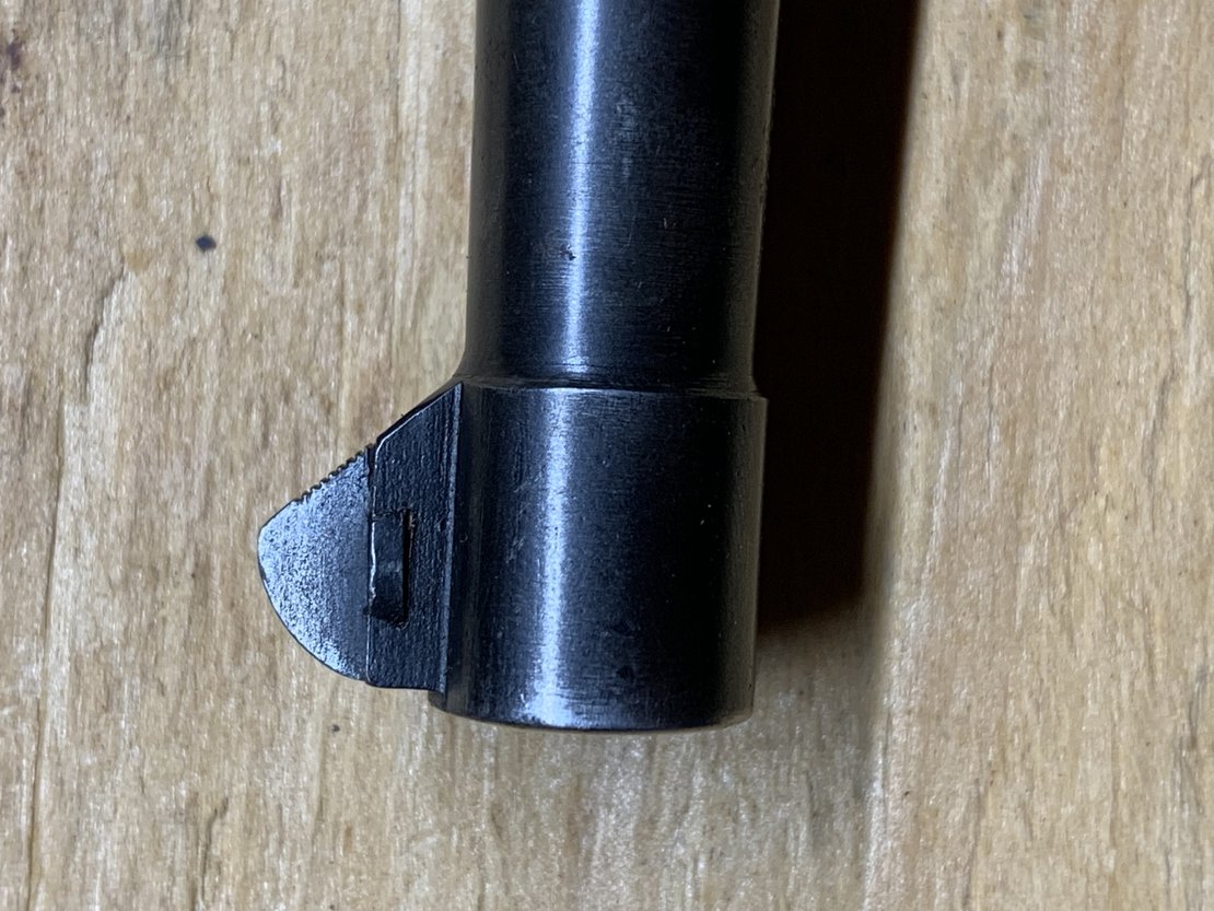

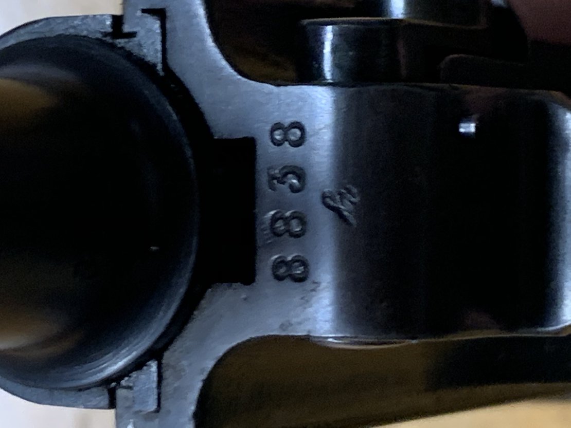

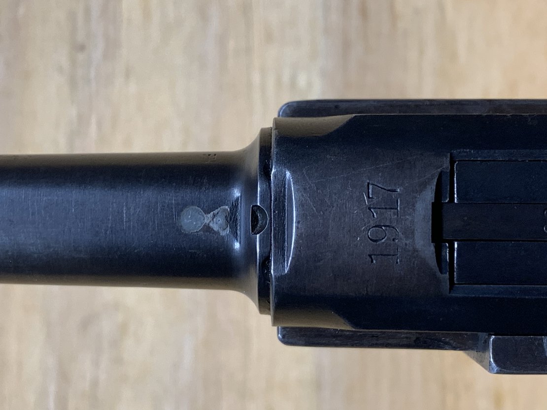

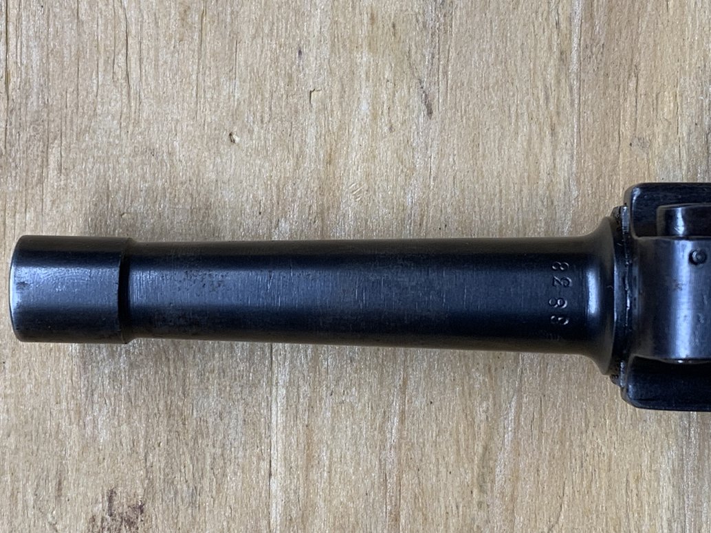

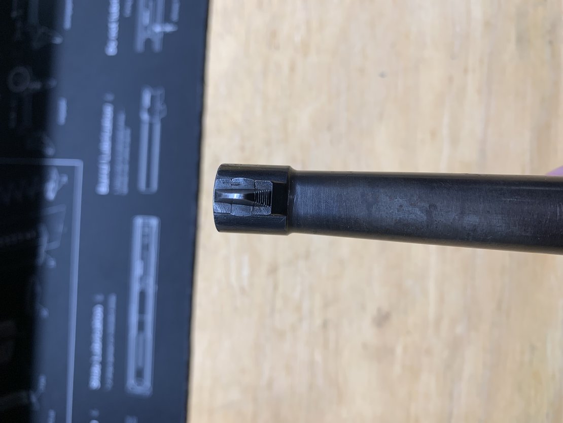

The barrel and receiver appear to have come from an Artillery Luger. The notch on the top, front of the receiver, and the remnants of the mounting area for the LP.08 rear tangent sight are visible in the pics. My guess is that the original barrel was turned down and shortened, and a new barrel band/sight block applied. If we had some extreme closeups of the barrel band/front sight area of the muzzle, including a shot from the front end so we can see the crown, that might provide a clue.

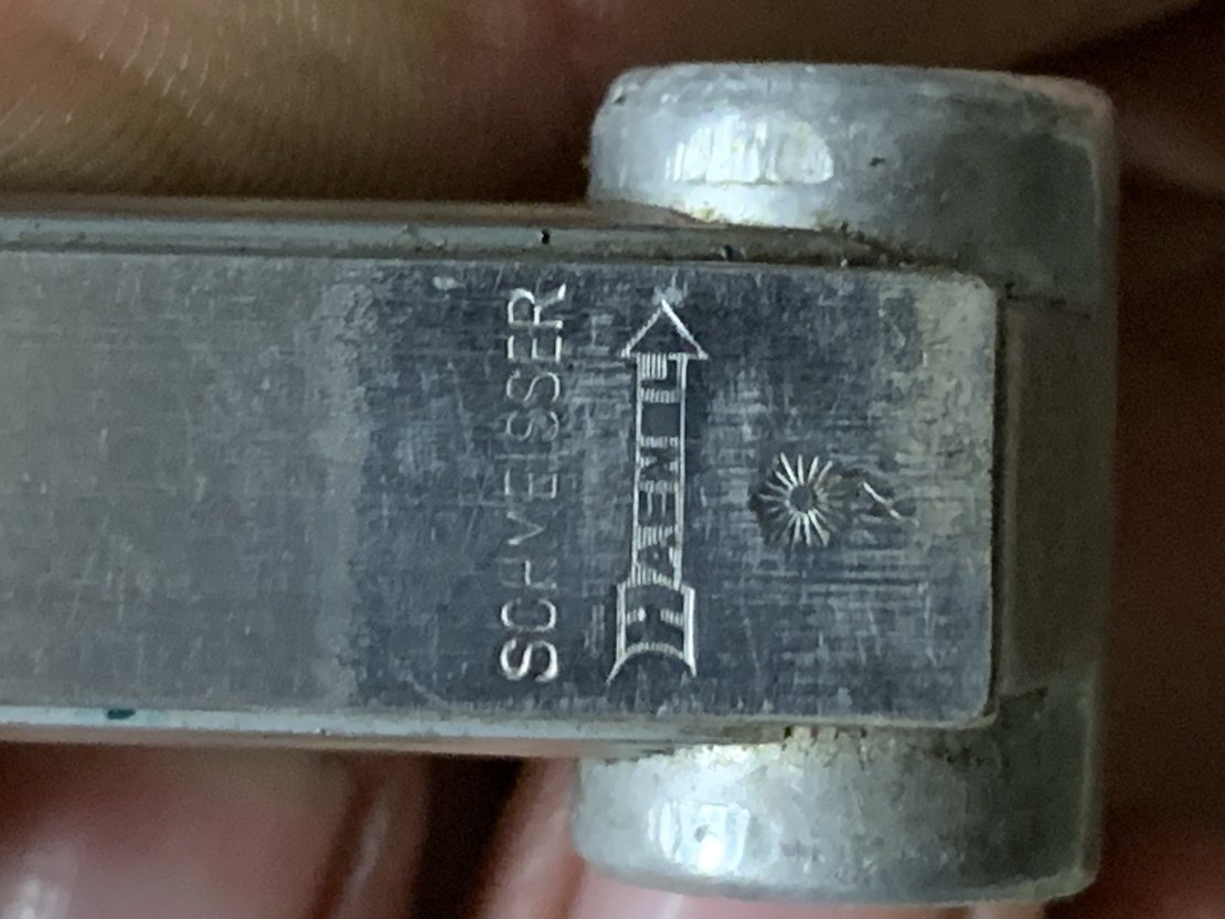

Does anyone know when Schmeisser magazines started being made? I’m just trying to figure out if this pistol was possibly used during the WW2 era.
Before WWII, it is quite likely that this pistol saw service in WWII.
Unread 07-03-2019, 11:57 AM   #13
BB, DJU & ET, I agree with Lifer that rather than the old orig LPO8 barrel being removed when it entered police service in the 1920s, the orig barrel was shortened and the tangent sight was removed by the Technical Police (TP marking on right side of barrel) and a sear safety was added. The matching Haenel/Schmeisser mag may a been added at that time or some time later in the 1930s. TH
The following 2 members says Thank You to Lugerdoc for your post:
Unread 07-03-2019, 12:47 PM   #14
Tom is no doubt correct. We need some good photos of that barrel, including the front sight band.
Unread 07-03-2019, 07:15 PM   #15

Here are the pictures of the barrel. Hope these work for you guys!
BarrelBaggins is offline   Reply With Quote

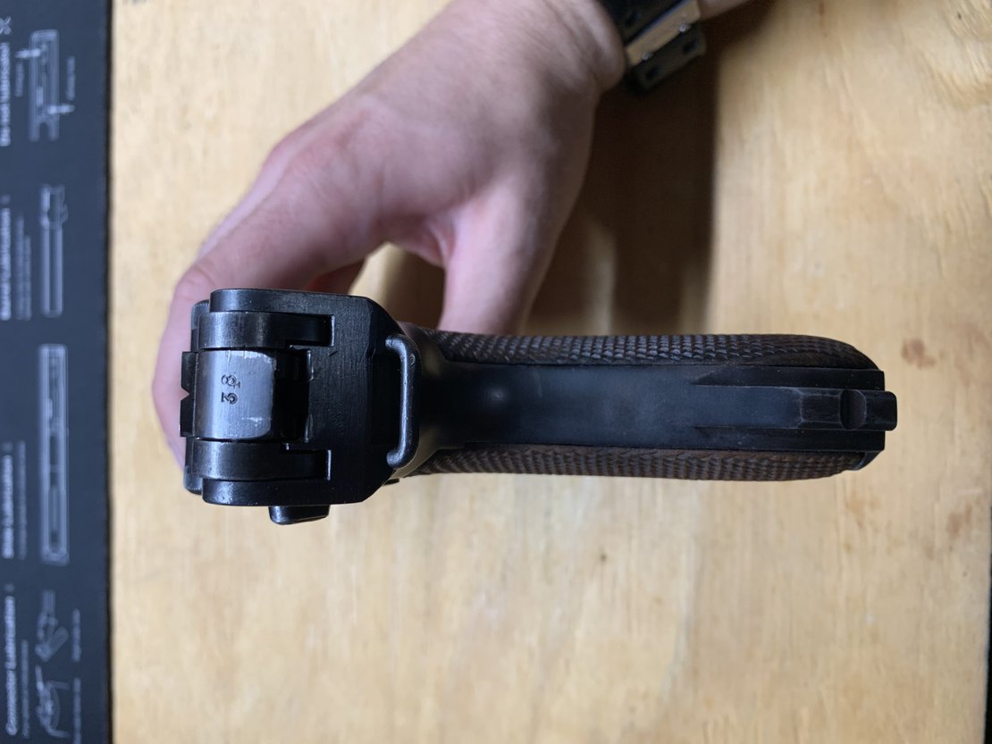

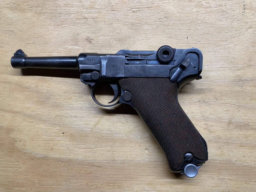

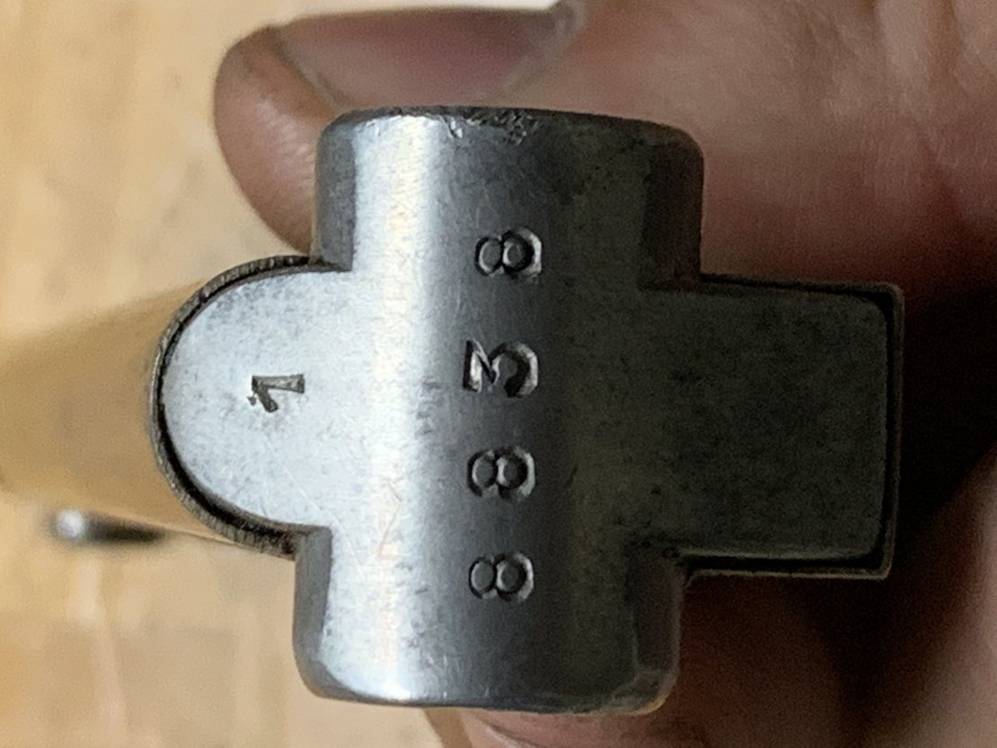

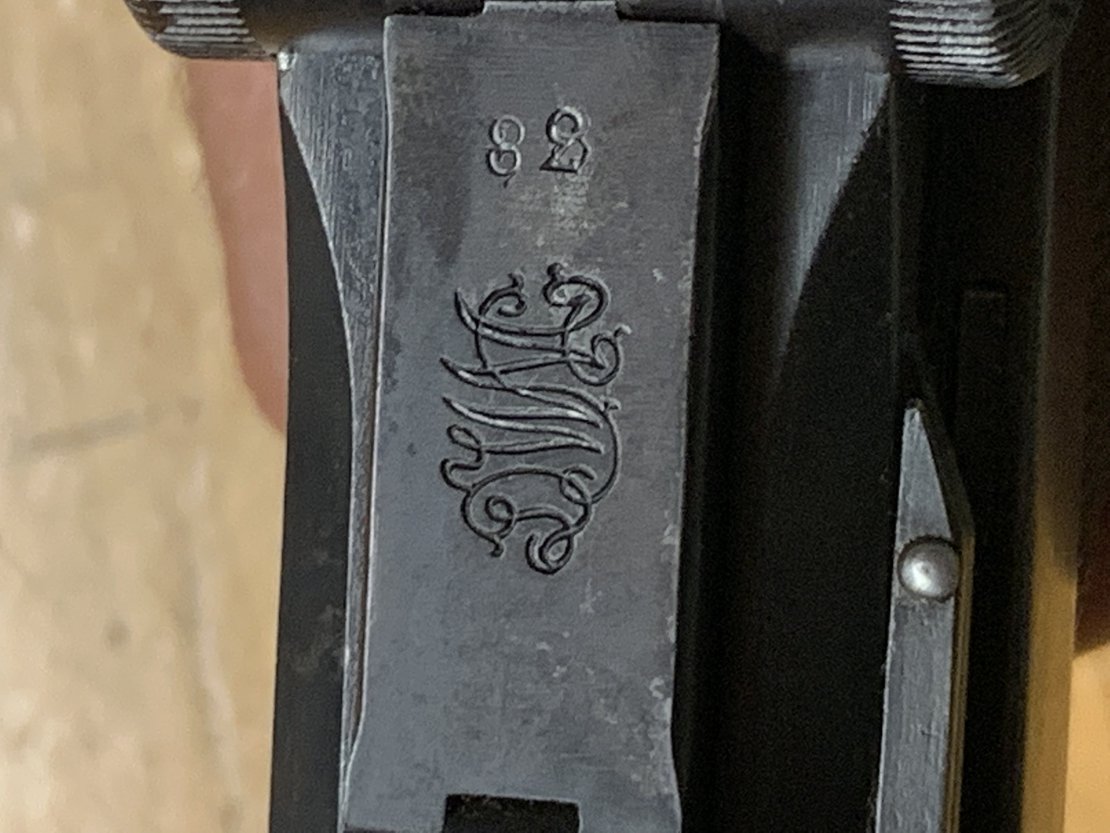

Here are some more pictures

And some more. Hope these pictures are better!

A fully matching police rig down to the magazines, took, and holster...but definitely reblued from a non-armory. I’m not sure how other collectors would see this but outside of that reblue, it’s a very nice get.

I'm not convinced it is not a refinish from its time when the police sear safety was added.
The sear safety rivet is in the white, which is a pretty good sign that it is NOT a post period reblue.
This may represent a 1932/3 or even later addition of the sear safety, a time when a hot blue of all parts would have been possible.
I agree that the blue ejector and td lever, etc. are an anomaly one does not usually see.

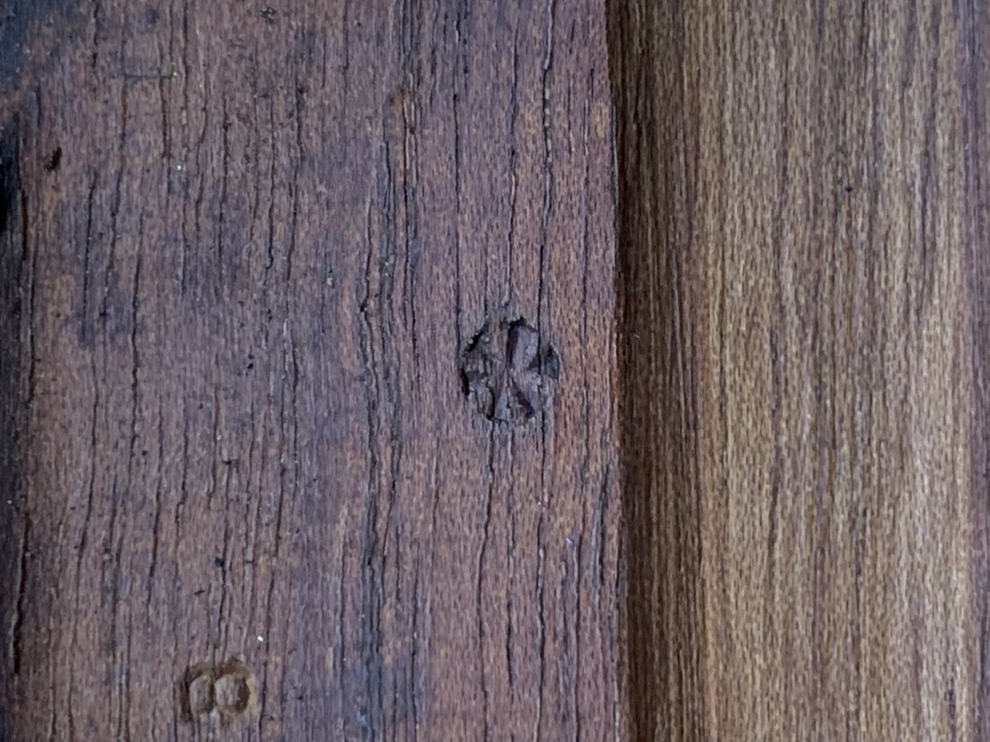

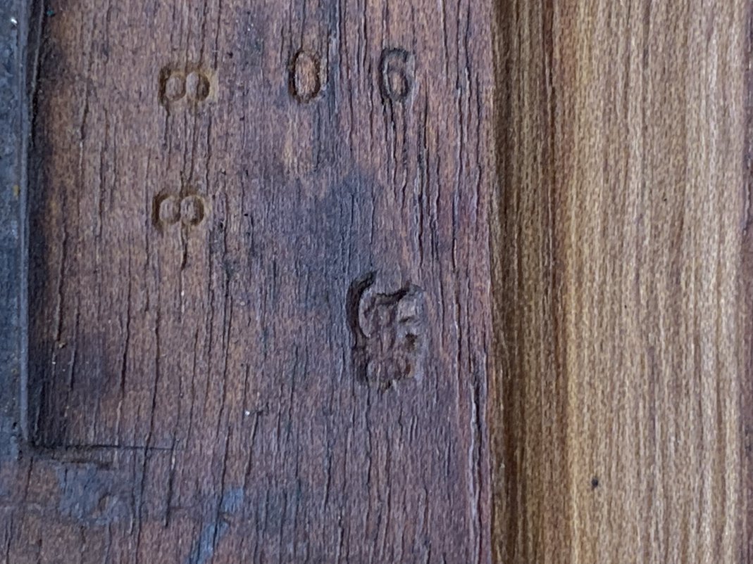

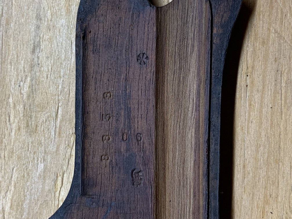

I’m also curious about those markings on the inside of the grip. Still trying to figure out if the barrel was cutdown also!
