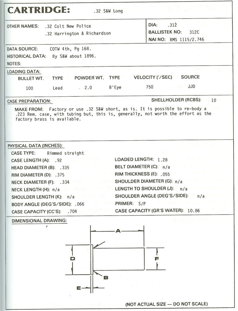

Unread 12-21-2018, 10:29 PM   #3
I have it in Handloaders Manual of Cartridge Conversions, it is also known as the .32 Colt New Police and .32 S&W Long.
Scan coming...
Unread 12-22-2018, 12:19 AM   #4
Posts: 2,675
Thanks: 3,247
Thanks Norm & Don. It is interesting that your page shows H&R as the same as 32 S&W L. But according to the H&R authors H&R did make a longer than 32S&W. It came out before the S&W 32L. They ceased it when S&W came out with the 32S&WL. I just purchased a !902 or so H&R revolver. It is in 32 cal. It also has a longer cylinder than a 32S&W. Also a 32long is just a bit to long for the cylinder. That's when I went searching on line and found 2 mentions of a H&R 32 L. They ceased it in 1905. It was a black powder load. I can cut down 32 S&WL to fit. Maybe even use 32S&WL brass with a wad cutter or flat bullet. More curious than anything. Thanks again. Bill

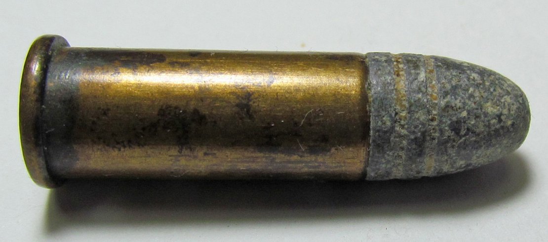

Thanked 26 Times in 20 Posts
Found this 32 cartridge, headstamp is WRACo 32 LC but case is .785, overall length is 1.189.

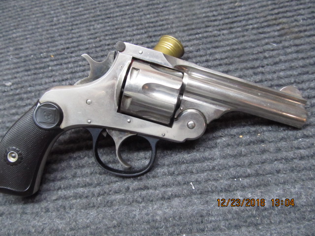

Posts: 2,675
Thanks: 3,247
H&R discussed above. 32 H&R long. Excellent condition. 1904 or so. Bill
