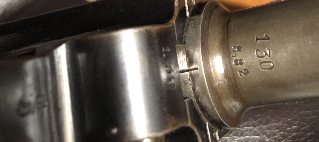

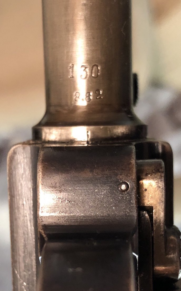

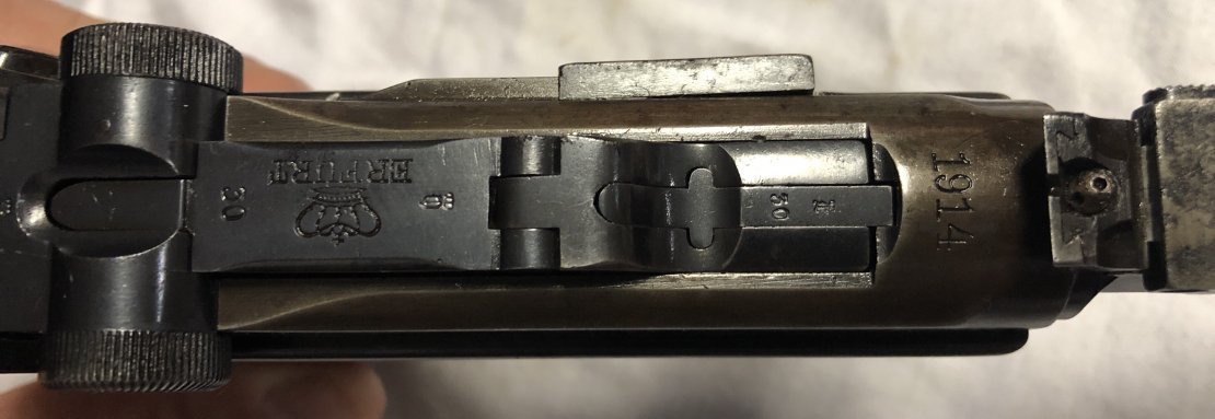

Patrick,
If you look closely at your third and fourth pictures you'll see that there is a groove where the frame's serial number is normally placed.
Compare this to the flat and square appearance of this surface on the ser no. 3 pistol.
It's unusual. Is that seen on other Erfurts of this period?
Old 12-20-2018, 10:14 AM   #24
[QUOTE=mrerick;321753]Patrick,
It's unusual. Is that seen on other Erfurts of this period?[
NO/QUOTE]
I believe the front of the frame was "faced off" and a new number applied to create a "forced" match. The "130" is offset, and that is also not "normal". JMHO.
Interesting I wonder if this was done at the factory? Reworked maybe after the war? This came from a descendant of the vet who brought it back.
I will post clearer pictures of the frame Serial this evening. Are their any other areas I should focus on?

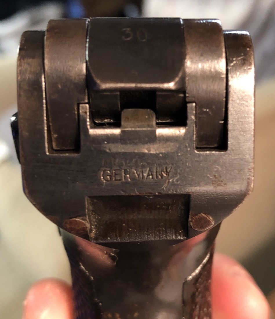

In addition to the concerns already noted, I notice the gun is "Germany" marked on the rear of the frame. IIRC, this was applied post-WWI for guns destined for export to the US. I have a 1915 DWM that's also marked "Germany", albeit in a different location.) I'm no RKI by any stretch of the imagination, but in light of the "Germany" marking I'd be suspect of the story that the gun was captured.

there are lots of examples of WW1 made and used lugers (and other items) that are germany stamped - however, the germany marking although used prior to the war, is almost assuredly post war, as lots of guns were fixed by DWM and other shops for export and cash during their depression, which started just after the war - however, Erfurt was forced to quit making or refurbishing after the war by the allied commission and they did not make ANY commercial arms during the war.

The Germany is almost certainly a post war marking; as Ed says- Erfurt made no lugers before 1910 or dated after 1918- so it was marked for export post WWI. The Germany stamping also indicates at least the frame was not "captured",
though:
I could make up a story, that could be true, that the original frame was de-lugged in the US sometime after import, and the pistol subsequently "restored" by renumbering another Erfurt frame. The only number on the frame is on the front.
No question in my mind that the frame was altered and re-numbered.
Somewhere along the line the lanyard loop was removed also.

I tried to show all markings on the lower receiver as well as the circles which I haven’t seen before in pic 2, I presume lanyard loop
Seems it could have been reworked
patsy57 is offline   Reply With Quote
Old 12-20-2018, 03:18 PM   #33
Correct, the 2 circles below and on each side of "Germany" are the remnants of the lanyard loop. No legal reason to remove it.

"Erfurt made no lugers before 1914 or dated after 1918". Might want to walk that one back Don, My slick backed 1912 and 1913 beg to differ. Chamber dates of 1910-1914 and 1916-1918 (no 1915 Erfurts) are accepted as genuine. As a government arsenal it never made commercial P08s. "Germany" marked Erfurts were military production offered for commercial sale post war.
Of course you are correct.
I was thinking Erfurt Artillery for the 1914 date, which is the only year Erfurt made the artillery.
I'll fix my post.
