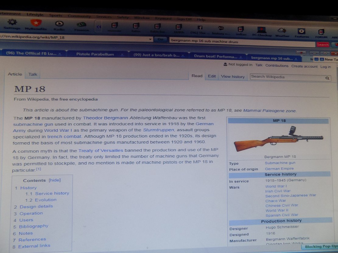

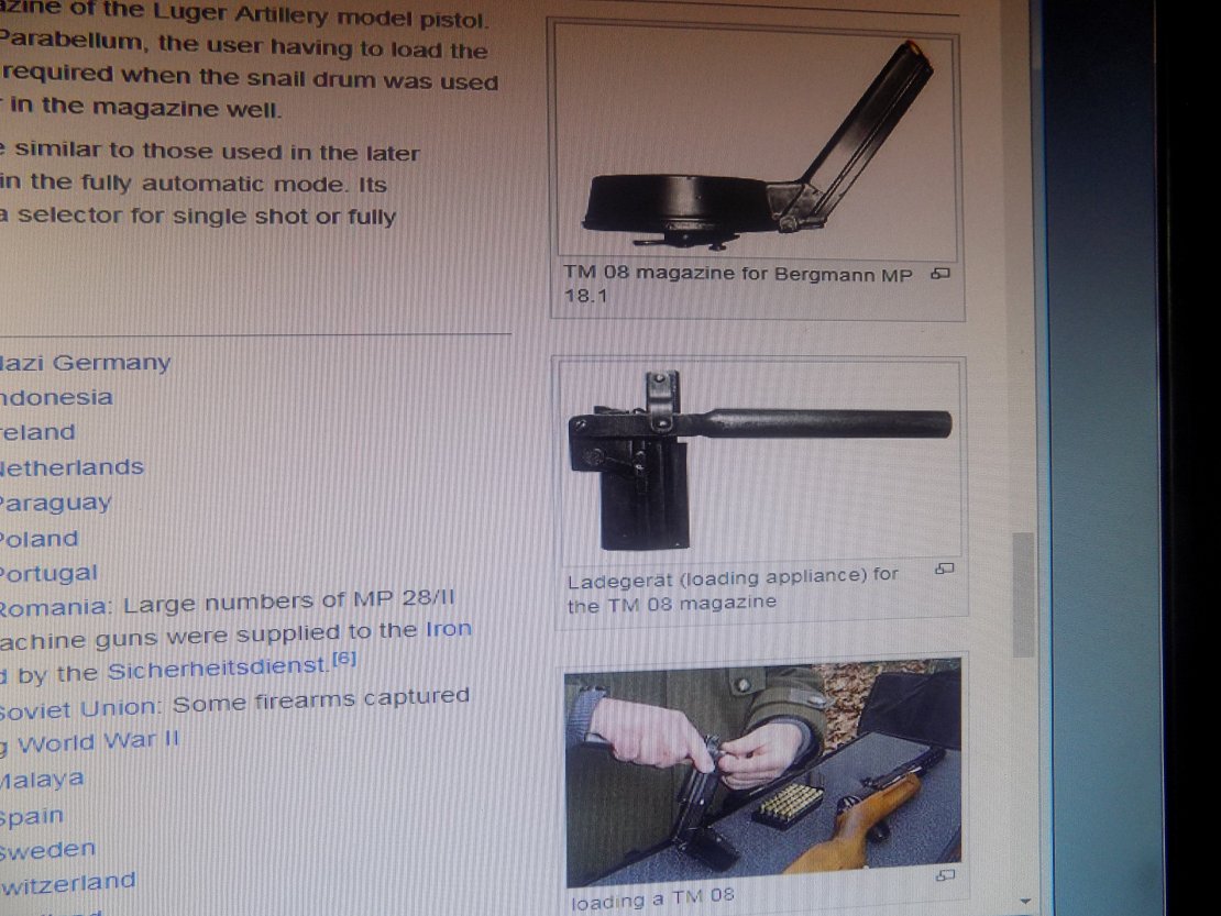

The trommelmagazin were able to be used in any Luger (in theory, as we have seen each one requires a bit of work to make one work) and they were also used by the Germans in their Bergmann MP 18 Sub-machinegun. 1 million of them were made but they are still incredibly sought after items.

Awesome, Reminds me of our BAR~https://en.wikipedia.org/wiki/MP_18
